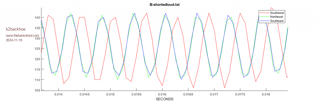

N.B.  In the final documentation there are a few of clarifications one could add for the RUN ADC command:
1) If you convert more than one ADC channel, the ADC RUN command converts the doublets or triplets of data at the commanded frequency.  i.e.  [adc open 10000,3] converts 10k values of ADC0, 10k of ADC1 and 10k of ADC2 every second.
2) Converting multiple channels interleaves the conversion evenly.  i.e. [adc open 100,3] converts ADC0, then ADC1 3.33 ms after each ADC0, and ADC2 6.66 ms after ADC0.  It does not convert multiple channels in a burst, but evenly spaced.  Important if timing is critical.
3) Each 64 bit integer array holds 8 values starting with the 8 lsb first and the 8 msb last (little endian).

Here is a MATLAB plot of a 1628 Hz signal converted at 10kHz sampling rateon all 3 channels with 2 channels shorted for testing and with the 3 channels offset in time by 0 uSec, 33 uSec and 66 uSec to properly align ADC1 and ADC2:
