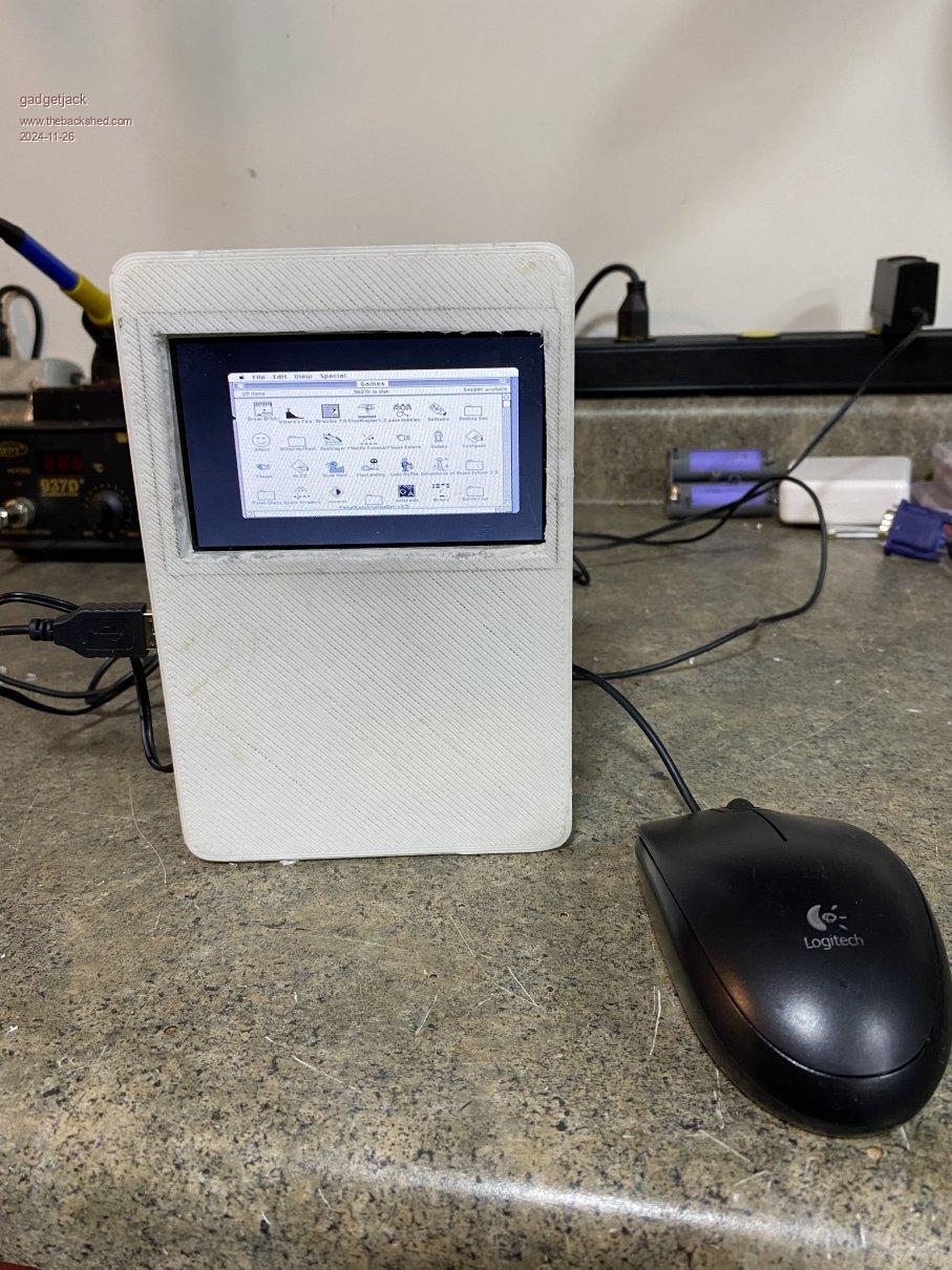

I read a comment a bit back that there were no good emulators for the Pico. I just built this from a new file on github called a Pico-Mac (or pico-micro-mac). It boots to a black and white screen of a macintosh 128k from about the 1985 era. It loads a 30 meg "hard drive" from the sd card. It plays games , does the paint program , and about everything else that old machine did. I got the re-compiled program that lets you use 208K for the machine (thats all you can get from a stock pico). Not a great machine but a good way to pass time for us old retired guys. It outputs in VGA and uses a regular mouse of the usb type. If you have trouble getting the files to compile ( like me ) , i can send the files in a zip. I will write what is in the file so it won't get deleted.

I would be very interested in the compiled files! What kind of display did you use?

Frank,  I used an old car backup monitor that had a vga input. Not a great picture but it was small enough to put in a case. Any vga monitor will work. The zip has files for pico and pico2 , the readme, and the file for the sd card to have a "harddrive". Lots of old games and stuff. Have fun!!

GadgetJack, thanks for providing the ZIP. I went the the uMAC website to find the wiring of the VGA. They drive RGB parallel from one GPIO with 100 ohm series. That may work but exceeds the max current for GPIO pins by far...

I made mine with 3 100 ohm resistors , one on each line. Kind of thought , better safe than sorry.

  Quote  3 100 ohm resistors , one on each line
That will overload the Pico pin even more. Expect a short life.
The minimum safe load resistance for any Pico output pin is about 220Ω, which can drive just one VGA input.
To drive 3 VGA pins requires 28mA, that is way above the safe limit so you need a transistor emitter follower to provide the extra current. The emitter resistor should be 68Ω to 75Ω going to all 3 VGA paralleled inputs.
The collector can be connected to 5V and the base directly to the output pin.
