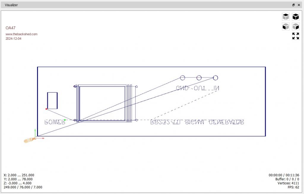

I have been producing front panels for projects by writing simple GCODE for the control holes, display area cutout, mounting screws and perimeter cutout with an origin at the bottom left-hand side of the panel.
I wish to add code to label the controls etc and have some software to generate the GCODE for the lettering. Unfortunately, the software to generate the lettering references the origin to the bottom left-hand side of the first letter.
Other than going through the whole lettering code and adding the offset for all of the x and y values, is there a way of adjusting the origin in the GCODE so I can cut and paste the text lettering into the full code for each of the pieces of text?

I think my understanding of the G90 and G91 codes is in error. Here is a snippet of the GCODE I am using:
G1 X2 Y2 ;STARTING POINT
G1 Z4 ;RAISE Z AXIS TO 4mm
M5 ;SPINDLE OFF
;END OF FRONT PANEL ROUTING
;CHANGE TO LASER MODULE
;ADD TEXT LABELS FOR POSTS
;GND OUT IN X8MM TEXT
;OFFSET TO TEXT FROM DATUM X150 Y20
G01 X150 Y20
G91
S1000
G21
F2000
G1 X3.4065 Y5.3677
G90
M03
G1 X3.2000 Y5.4194
G1 X3.0452 Y5.4710
G1 X2.8903 Y5.5226
G1 X2.6839 Y5.5742
G1 X2.5290 Y5.6258
G1 X2.3226 Y5.6258
G1 X2.0645 Y5.6258
G1 X1.8581 Y5.5742
G1 X1.7032 Y5.4710
G1 X1.4968 Y5.3677
G1 X1.3419 Y5.2645
G1 X1.2387 Y5.1097
G1 X1.1355 Y4.9548
G1 X1.0323 Y4.8000
G1 X0.9290 Y4.5935
G1 X0.8774 Y4.3871
G1 X0.8774 Y4.1290
The router returns to the DATUM after routing the FRONT PANEL and I move to the DATUM OFFSET (150mm to the right and 20mm up) for the label to be lasered. At this point I invoke the G91 and indeed the next move does leave from the new point but all following moves leave from the preceding point until I invoke the G90 but then all following moves are referenced back to the original DATUM.

I don't manually edit gcode very often - I let the PP take care of all those movements.
From my limited knowledge, if you change to Incremental Mode, the positions are now measured from the CURRENT postion.
Switching back to Absolute Mode, the postions reference now revert back to the DATUM position
So this ....
1/ G01 X150 Y20
2/ G91
3/ G1 X3.4065 Y5.3677
4/ G90
5/ G1 X3.2000 Y5.4194
6/ G1 X3.0452 Y5.4710
to my understanding, says :
1/ goto X150, Y20 (relative to origin)
2/ change to move everything relative from the current postion
3/ add 3.4064 to the current X, add 5.3677 to the current Y and goto that position
4/ change to move everything relative to the origin setting (X0, Y0, Z0)
5/ goto X3.2, Y5.4194 (relative to origin)
6/ etc, etc...
Line 5 says go back to postion X3,Y5

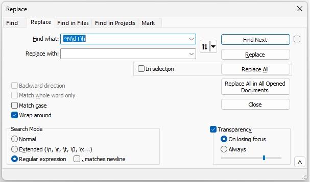

Because the .DNC files have line numbers if I want to merge the code into an existing .NC file then each of the lines must be modified.

OK just learnt something today....
Open the .dnc file in Notepad++
In main menu select Search, Replace
In the popup box put
^N\d+\h
into the Find what box. Leave the Replace with box empty.
In Search Mode select the Regular Expression button.
Click the Replace All button.
All line numbers will be removed.
Apparently
^   means start of line
N   is literal
\d  means digits
+   means match the preceding atom one or more times
\h  means horizontal spaces

If you are on windows it looks like Stickfont will generate the letters referencing the machine origin.
F4 H7FotSF4xGT
OA47
Joined: 11/04/2012
Posts: 1056
Posted: 08:59pm 03 Dec 2024
  Quote  If you are on windows it looks like Stickfont will generate the letters referencing the machine origin.
Played around with stick font and it looks like it will suit my purposes.
Thankyou disco4now
