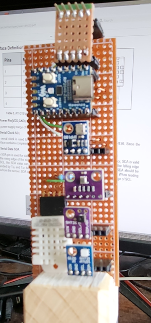

This is in the "Because You Can" category rather than "The Best Way to do It".
The Humid command outputs 2 16 bit numbers, each divided by ten.
When using a DHT22 the values represent temperature and humidity but they could be anything.
Recovering integer values just requires multiplying them by 10. For a 32 bit number stitch them together.
eg. (H*10 << 16) + T*10
Using a second Pico running a DHT22 emulator any data can be packaged into 16 bit lumps and sent to the host.
When more than 32 bits are to be sent a sucession of Humid commands can be used.
If the host is running out of pins and you want to read multiple sensors this needs just one pin.
This pair of programs gathers 8 data values from various devices and sends them via 4 Humid commands.
Synchronization is achieved by having a long pause between each group of 4.
It could have been done by including some address bits in each block of 32 bits.
Eg if the data is from a 10 bit DAC 3 values and 2 address bits could be sent in one 32 bit shot.
There is one catch, if the 32 bits = &H27102710 it could be mistaken for the error indicator when
both T and H = 1000. To prevent that whenever &H27102710 occurs flip the leat important bit, or reserve a bit for that purpose.
Host

Data collector and DHT22 Emulator
Print "multi sensor data collector with DHT22 emulator output v02.bas"
Print MM.Info(cpuspeed);" Hz"
' "DHT11 and 22 Emulator for AHT10 input.bas"
'  One pin version. Link DHTpin and Gnd. to other Pico.
'  If wires are short no pullup resistor is needed.
Const DHTpin = MM.Info(pinno GP6)
SetPin DHTpin, DIn, pullup
Print "DHTpin =";DHTpin, Pin(DHTpin)
Dim integer a(83), b(4), word, n, m, DHT
Dim float t, h, tAHT, hAHT, z 'z = "wake" pulse duration - 1.5 = new firmware, 1 = old
' HUMID won't get a resopnse for 1st reading, so will output 1000.
'measuring first "wake" pulse to set start delay time. Old firmware = 1mS, new = 1.5mS
Print "Waiting to measure first pulse"
Do While Pin(DHTpin):Loop :t=Timer
Do :Loop Until Pin(DHTpin):z=Timer-t-.135 'data must start within 135uS of wake pulse end

Footnote added 2024-12-12 06:35 by phil99
Some corrections.
  Quote  Eg if the data is from a 10 bit DAC
should be ADC.
Some of the comments in "Sub Emulator 'emulate DHT22" aren't relevant.
The original version of that sub was for both DHT22 and DHT11. The DHT11 encoding doesn't allow extracting all 32 bits at the other end so was removed, but forgot the comments.
Footnote added 2024-12-19 09:57 by phil99
An updated version that allows a wider range of CPu speeds on both Pico1 and Pico2.
The original has a fixed fudge factor to allow for the time it takes for the interpreter to switch from DIN to DOUT. This measures that time and reads the CPU speed for better correction.
Print "multi sensor data collector with DHT22 emulator output v05b.bas"

I have been comparing various sensors, looking for reliable temperature, humidity and pressure in the one chip.
The DHT20 is worth a try but pinout is odd and I will have to make a special socket for it. I need to redo the board anyway so not too bad. I will be dropping the DHT22.
I like it when all the modules can be interchanged easily. It makes comparisons easier.
My test results so far:
Temperature BME280 20.5, HTU21 20.1, BMP180 21.6, DHT22 20.5, SHT31 20.6
Humidity    BME280 50.4, HTU21 63.7,              DHT22 43.4  SHT31 60.8
Pressure    BME280 1011.0            BMP180 1010.2
The temperature on all modules compare very well.
The SHT31 humidity is the most believable so far.
On another BME280, the humidity has gone to 100% without any recovery. I don't expect much better with this one.
DHT22 humidity varies from 40 to 75% depending on the module I choose. All were "new"
Putting the pico at the top stops it's heating upsetting the readings when the cover is on.
Next step is to move the sensors out into the real world.
