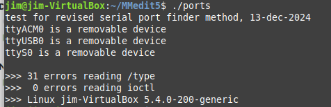

Posts: 6624
Posted: 01:04am 13 Dec 2024
Looks correct on Linux Mint running in a VM
One Picomite and one CH340
Edited 2024-12-13 11:06 by TassyJim

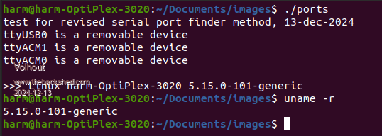

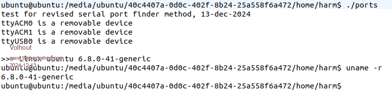

I could try to to a test on Ubuntu 24.04 as live distro ? (not installed) ? Not sure if that will work. Connected FTDI RS232 cable, arduino UNO, PicoMite
Ubuntu 20.04
Ubuntu 24.04 live
Edited 2024-12-13 18:32 by Volhout

Jim: it is interesting that ttyS0 showed up as removable, i am guessing this is bacause of running in a VM. did you do anything special to make the COM1: serial visible to the VM?

Volhout: i've never tried with a live distro [... 2 hours later] just tried it and got entirely confusing results! you're using an Dell Optiplex 3020? does it have any serial ports on the motherboard and/or is there a DB9 on the back of the machine? is this enabled in the BIOS?

Posts: 6171
Posted: 01:54pm 13 Dec 2024
Hi Rob,
The Dell is not equipped with DB-9 or any fixed serial port. I could try the live distro on another machine that has a fixed serial port. But this one does not have one.
