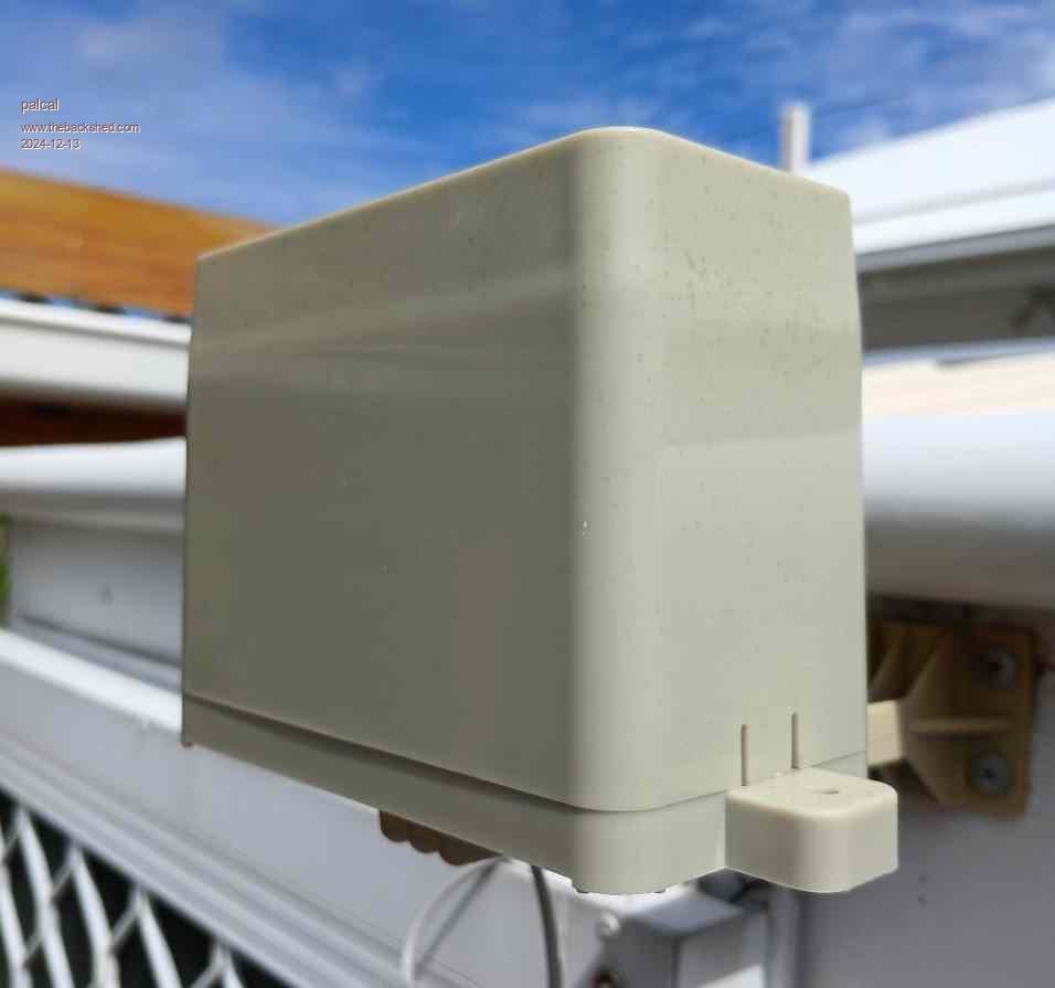

Any one using one of these rain gauges ?   Could you tell me what calibration value you use. I set this up some time ago but haven't had much rain till now. I was using 0.31mm per tip but it read 59mm for 52mm of rain so I figure the correct value to be more like .27mm per tip.

palcal

Oops the picture did not load.
Tried again but it won't upload.

What I did with an old DSE one I have was to get a parallel sided tin with the same diameter as the opening (100mm), filled it to a known depth say 20mm & gently poured the contents slowly into the gauge to see what it read. (should read 20mm if calibrated correctly).
Mine only had 1mm resolution with a 100mm opening at the top. I 3D printed a funnel with a 141mm diam opening (2 x the area) & sat that on top. Mine also has a mechanical screw adjustment in the tippers (buckets) & I was a able to get it to read 0.5mm each tip fairly accurately by adjusting that.
A calibration figure should be able to be calculated if there is no mechanical adjustment.
Hope this helps
Brian
Edit. Just saw your piccie. Bit slow typing. Probably not much help then...

I calculated the catching surface area of the rain gauge and did a similar thing with a known amount of water and that is where I got the figure of .31mm. but it doesn't seem to be accurate.

Posts: 6624
Posted: 12:39am 14 Dec 2024
I am not sure where you have the tube gauge but looking at the photo of the tipping bucket, you will get lots of splatter from the roof with heavy rain. That will give higher readings.
I would wait for a range of comparisons before I re-calibrated.

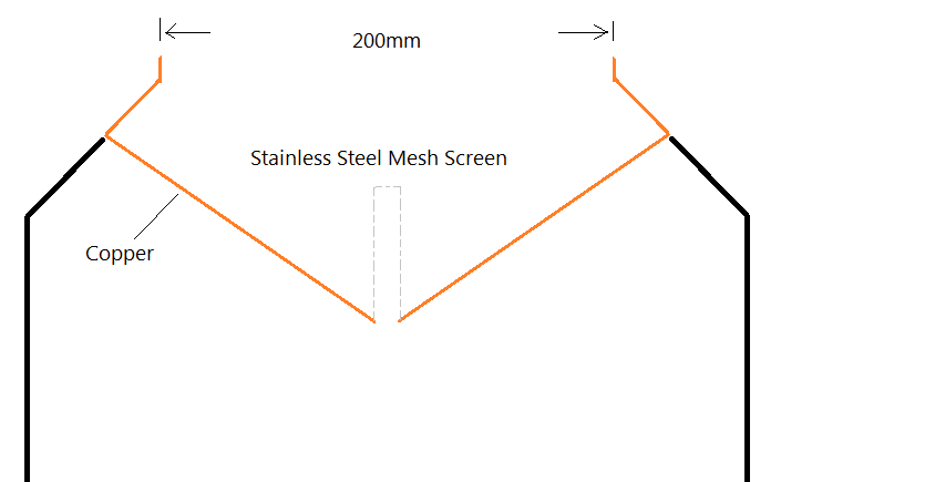

Posts: 3411
Posted: 03:09am 14 Dec 2024
Yarra Valley Water have an "official" gauge here on top of the Divide. It has a copper funnel to prevent gunk growing in it and a very fine stainless steel screen to keep everything, including spiders out of the works. The inverted lip is a splash catcher to minimize losses in heavy rain. The slope of the housing prevents rain splashing in. The vertical rim is fairly sharp to split large drops for maximum accuracy.
It's a lot of trouble to go to given that, as observed by Jim, just a few tens of metres away the reading could be different.
At our fire station there is an automated weather station attached to the hose drying tower. The tower is an excellent roost for flocks of galahs, corellas and sulphur crested cockies so the rain gauge is almost useless. If there is stuff stuck in the buckets it reads too high, if the funnel is blocked, not at all. Cleaning isn't an option, its too high up and above a barbed wire anti-climbing fence.
So we use an old fashioned manual gauge.

@ Jim,  I moved the gauge this morning, higher up,  on to the timber you can see top left of photo where it wont get any splash. I hadn't thought of the splash effect, I just moved it to what I thought was a better position.
