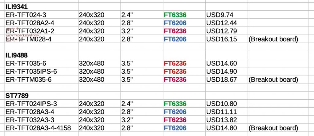

Capacitive touch are typically I2C devices so there is nothing too difficult in coding them in MMBasic. If there was a readily available screen with capacitive touch (like the resistive ubiquitous ILI9341/X2046) then I would include support in the firmware but I don't know of a suitable, sensibly priced, candidate

Confirming I have successfully interfaced small capacitive touch-screens to a Pico.
As Peter says, reasonably simple to implement I2C code to return x and y coordinates of a single touch point.
I have not explored multi-touch - but data sheets do go into how to do it ….

apalert
Joined: 06/07/2023
Posts: 47
Posted: 01:25am 16 Dec 2024
  matherp said  Capacitive touch are typically I2C devices so there is nothing too difficult in coding them in MMBasic. If there was a readily available screen with capacitive touch (like the resistive ubiquitous ILI9341/X2046) then I would include support in the firmware but I don't know of a suitable, sensibly priced, candidate
Applied some research to this Peter, looking at East Rising LCD panels from Buydisplay.com in the 2.4" - 3.5" range that have Capacitive Touch option as well as LCD controllers compatible with MMBasic. Seems they commonly use FocalTech touch controllers FT6236/FT6336 and FT6206. Results tabulated below:
