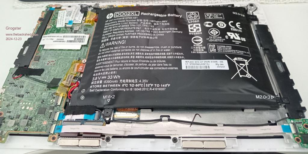

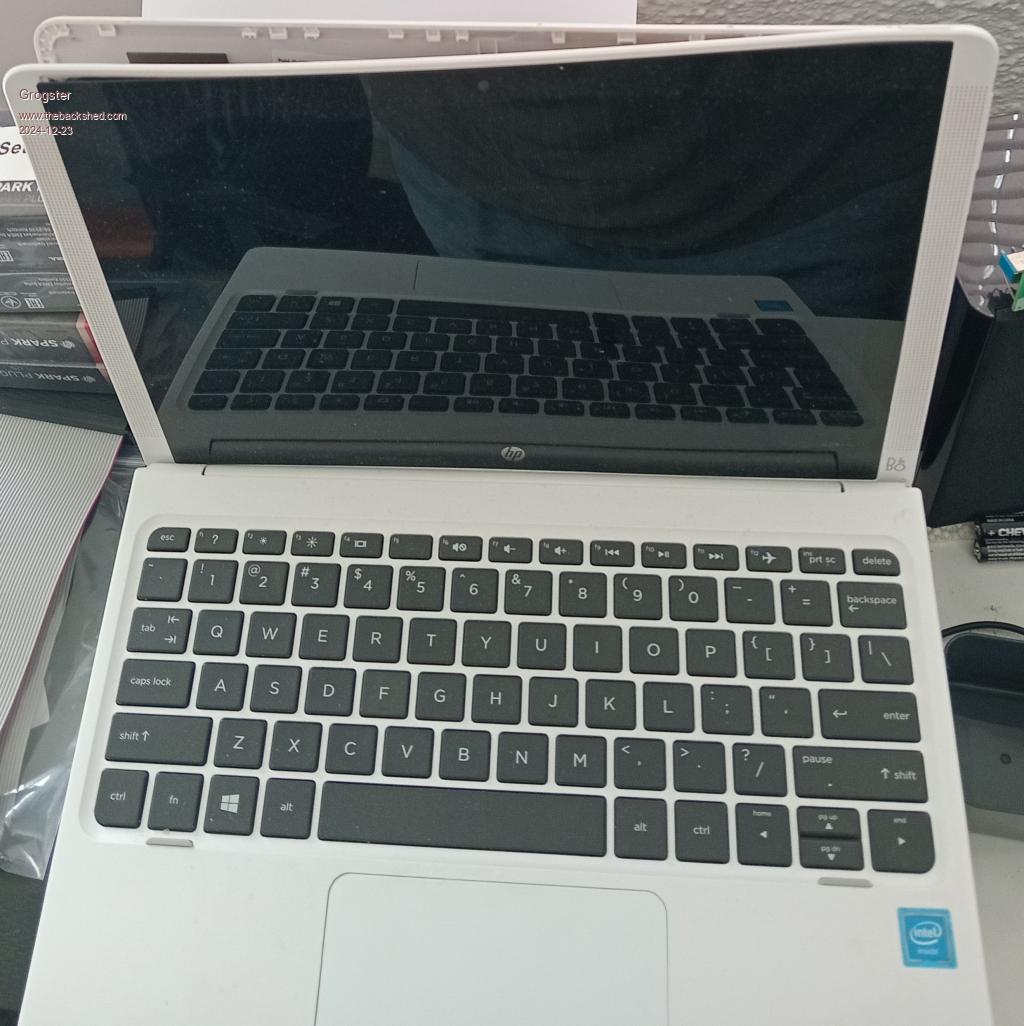

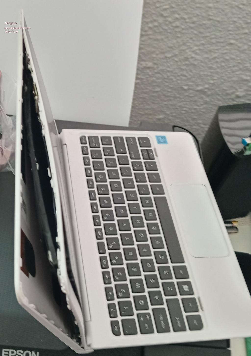

This is not good......
At least it was easy to get apart - the battery had pretty much popped most of the clips holding it together!
This unit WILL NOT power-up now, with the battery removed.
Could it be possible that they design a tablet, such that WITHOUT the battery being present, it won't boot?
Hmmmmmmm......

No boot without battery seems common, might be able to get around that.
The battery would have been flat back in 2015.
Cheers Aaron

Owwww - very interesting!
I could look for a replacement battery - it WAS working OK before I removed the battery, which is pretty amazing really, considering the massive physical distortion going on.

I guess you could try several 18650 cells in parallel to see if it runs ok with them instead. If so they would need to be externally mounted.
If you don't have any of them simulate a battery with a power supply set to 4.35V, perhaps with a dummy load to absorb any charging current if it needs it own PSU plugged in for the first boot.
Posts: 6624
Posted: 07:00am 23 Dec 2024
A big capacitor for a battery then run it from external supply.
The poota probably thinks the battery is flat and is waiting for some charge in it before turning on.
Posts: 3411
Posted: 07:28am 23 Dec 2024
Certainly worth a try, though as the cap will start with 0V it may assume its a failed battery and refuse to charge at all.
Maybe a little DC to DC converter set to 4V connected between the power socket and the capacitor may fool it.

try removing the cell(s), but retain the electronics PCB (the BMS). connect an 18650 up to the BMS and see what happens.
is it an HP X360? i have a number of HP Stream 11 G3 machines that use 2 cells in the base - underneath the keyboard. i have run these with the battery (including BMS) unplugged without issue. the machine i am typing this on in fact has no battery installed and the charger plug permanently taped in place. i've also experimented with powering the machines with 2 banks of 3x paralleled 18650 cells; with the stream 11 you can replace the cells without the BMS getting unhappy.
