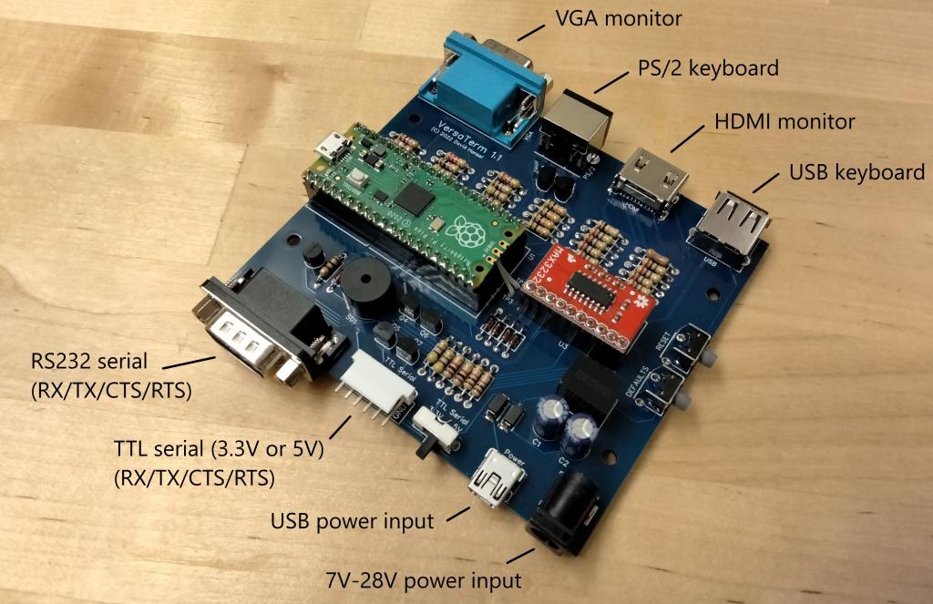

Is anyone aware of a project to allow a PicoMite VGA to work as a "dumb" terminal such as a VT-100?
It would be an interesting project to wire up a PicoMite VGA as a terminal connecting to another Pico running MMBASIC without having to use a terminal emulator on a PC.

javavi
Joined: 01/10/2023
Location: Ukraine
Posts: 585
Posted: 12:07am 26 Dec 2024
This project can be easily ported to the PicoMite VGA/HDMI scheme
https://github.com/dhansel/VersaTerm

A dear friend of mine also has created a VT-100 VGA terminal for the Pico RP2040:
PicoTerminal
Features are:
- different colour and screen resolutions, BW to RGB or RGBI, 1..16 bit
- USB keyboard and mouse support
- sound from buzzer to PWM to I2S (Soundchip emulation in progress)
NB: This is my first post to the backshed, thanks for inspirations and greetings to everyone!
