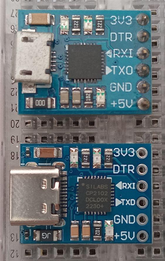

My new USB-C modules have arrived, and appear to be pin-for-pin compatible, and of the exact same size.
Interestingly, the top module(micro-USB) in this photo, the chip is "Blank" - no markings, so most likely a clone.  The TXD and RXD leds that NORMALLY blink on these modules, don't on this one, and the silkscreen is pretty flaky.
The new USB-C ones I got, appear to use the genuine chip, as you can easily read the chip markings, and the silkscreen seems much more "White" then the other one.
These could be clones also, but the TXD and RXD LED's blink on the new USB-C ones, and they APPEAR to use genuine chips - date code is 30th week of 2022...

Grogster's photo shows the RXI terminal going to 3.3V via a LED and 220Ω. That would indicate the data pins are 3.3V.

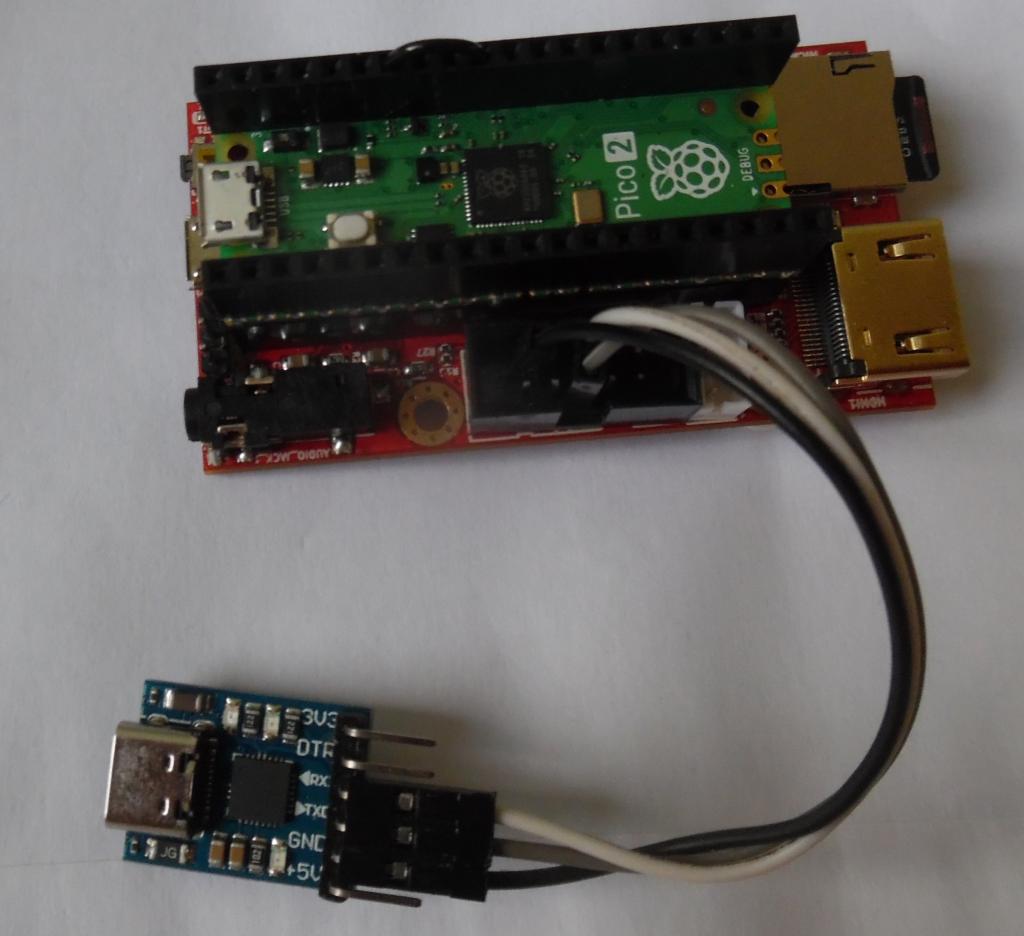

I use one with olimex board and pico2 usb. smaller than other usb to ttl with micro usb socket.

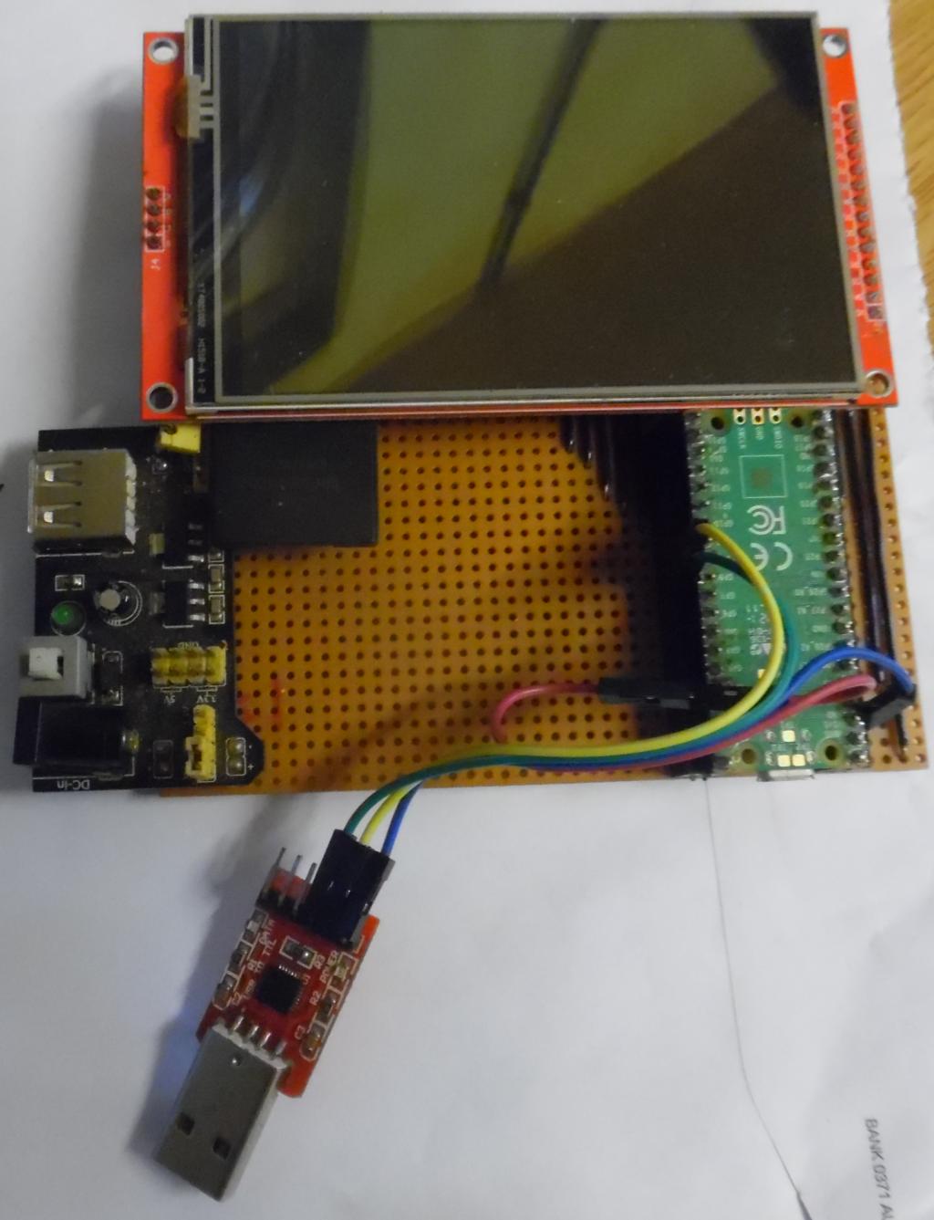

Posted: 04:31pm 03 Jan 2025
I meant these usb to ttl. connected to 2040 usb and logic levels works, should have tested first though. these need a female usb connector or plug into laptop pc
