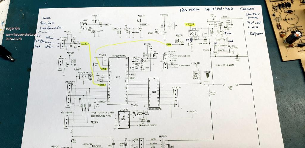

Hi Guys, I’m looking for some help with a fan speed controller please.

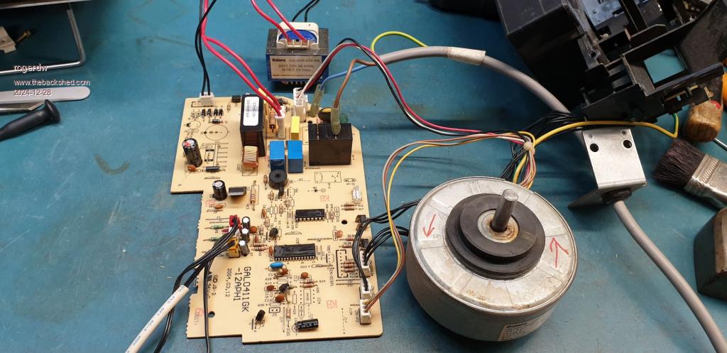

When I built my Warpverter I scored a barrel fan from the indoor section of a split system aircon  …  as well as the circuit board and supply.
I thought I’d be able to cobble something together but no success so far.
It will definitely run flat out  …  and I can use a cheapie on/off controller to switch it  …  but it would be nice to have it run at a civilised speed rather than flat out or stop.

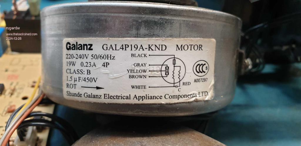

The motor is a Galanz GAL4P19A-KND 240V 19W
Apart from the 3 motor winding connections, it also has a 3 wire connector with 5V, Signal and Gnd.
If I power the signal wires with 5V, I get 3 nice clean switching pulses per revolution. Goes from gnd to 5V cleanly.
I have the circuit board  …  but it is for the whole aircon control and not just the fan  …  so not much help in this situation.
I also have a circuit diagram I found which is the same or extremely close to the board I have.
Any suggestions as to how I can arrange variable control of the motor please?

The circuit is conventional leading edge phase control of a split-phase motor.
Power to the motor is varied by synchronising the MCU with the 240VAC zero crossings and delaying switching the optocoupler to trigger the triac.
Compare the frequency of the feedback signal with the desired speed and vary the trigger delay accordingly.
How well this works depends on what you are using the motor for.
The smoothly rising, predictable torque/speed characteristics of fans and centrifugal pumps give good stable speed control with this method.
Loads that require a higher torque at low speed than at high speed may require a variable frequency drive.
If driving a fan and you don't need exact speed control you can ignore the feedback signal and still get good results, except at very low speed. That may require starting at a higher speed then slowly reducing to the desired low speed.
