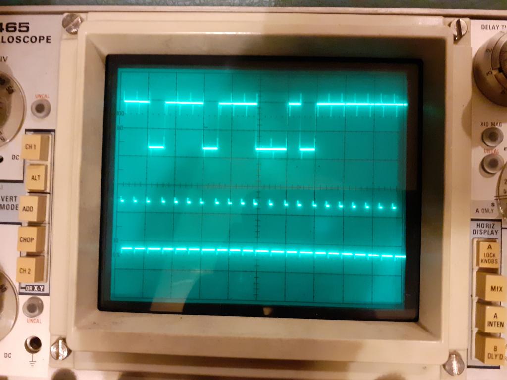

I am in the process of developing a better display for my small mill's DRO set-up. They are cheap capacitive scales but came with a small monochrome LCD remote display. Apart from the difficulty (for my ageing eyes) in reading the LCD panel, it has some very indifferent membrane buttons, plus needing two CR3032 batteries. But it was cheap!
My cunning plan is to replace this LCD display with a 17" VGA monitor that I have available. I am using a spare VGA PCB (the twin socket Peter M style one) with an SD card and a protoboard to attach the micro-USB connectors. I've got a dummy Mode1, Font6 (with tiles) X, Y, Z display already running and now need to decode the incoming scale signals. Once I have a basic DRO reader/display running, I can also add other functionality that the simple LCD can't provide. But first things first...
I'm still determining whether they are BIN6 or iGauging 21 bit but started to think about how to  write the code. Looking for a starting point, I searched for existing code (I like a leg-up) and found a BIN6 routine in Arduino.I haven't touched Arduino code much since discovering Mites about 10 years ago, so whilst I could read a good bit of it, there were parts that were unclear to me (and it wasn't commented). It was getting quite late, so on a whim, I pasted the code into Co-Pilot and asked it to "translate" into MMB.

The DRO scale bodies are connected to the negative side of the battery Mick, which apparently indicates that they are probably either BIN6 or 21 Bit based, rather than the other Chinese DRO (24 Bit etc) O/P standards.
My understanding is that the BIN6 scales send signals to the display without an external clock but last night I couldn't see anything on the output cable with a simple meter or scope examination, so it may not be BIN6. The 21Bit (iGauging) sensor needs the display to send it a clock signal before it responds, so I'm going to rig-up two back-to-back micro-USB connectors on a protoboard, so that I can see what is happening between the LCD display and the DRO scale when connected together. The scales do work with the LCD display of course...
So to answer your question. No, I don't know if the MMB BIN6 code actually works (and I may not need it now) but it is certainly easier for me to read and debug MMB, than Arduino code. I'm not a skilled programmer, everything takes time very often because of my own silly mistakes. Adapting the Arduino code to MMB would have taken me a while. So anything that gives me a running start and saves me time with a new (and unfamiliar) problem is very welcome.
I've just (now) found some code that may be good for 21 Bit scales but I want to see something happening on a scope before I go too much further with the software side. My Manager has other plans for me this afternoon but hopefully I'll make a bit more progress this evening. I'll certainly be trying Co-Pilot again and I'll let you know how I get on.

A quick update.
I built the protoboard USB rig tonight to have a look at the signal flow between the DRO and LCD Display. A combination of noise and my lack of skill (I seem to have forgotten everything I once knew about using a scope) slowed progress quite considerably. I eventually re-rigged things and the noise improved but synching was still a problem. It finally dawned on me to dig out a second scope probe and use the clock line to synch on the signal line.
So, there it is, a 21 Bit clock signal that runs for 2ms, followed by a 4ms gap. The data signal occurs during the clock period. So I now have something to work with on the software side.
The iGaging 21Bit Arduino code should therefor be a good starting point but I'm sorry to report that (as you both expected I think) the CoPilot MMB translation isn't going to to work out the box, although there is probably still a helpful framework there for me to work on. That's for another night now though.

The clock noise on the data line is actually helpful here.
Makes it easy to see that you read the data on the falling edge of the clock.

But yes I should have enough information now to figure out how to make this work. I only have 2 axis to read (at the moment) but the fact the iGaging scales only respond to the display clock makes life a bit easier I think.
