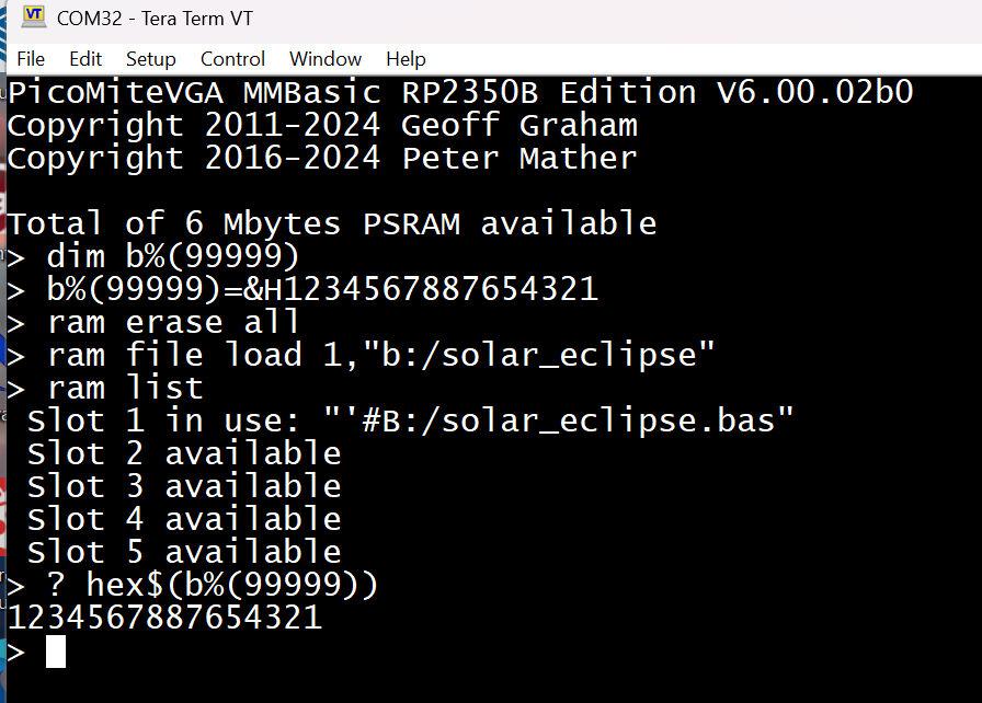

Ram slots in memory (just like flash slots) but with the ability to load and run programs from within another program with or without the variable space being preserved.
NB: 6.00.02 will also have a CHAIN command for all versions

This is an important development in the use of a large volume of PSRAM for PicoMite on RP2350A/B chips!
Interesting! Is it possible to organize color video modes for high HDMI resolutions when PSRAM is connected?
1024x768 x16 colors = 384kB
1280x720 x16 colors = 450kB
In this case, the internal memory of the RP2350 should be given over to video memory, and the variable area should be moved to the PSRAM.

  Quote  When 6.00.02 is developing, it would be very nice to have the PIO assembler work for individual state machines.
Did you try my suggestion of having two separate blocks of compilation in the program?
  Quote   Is it possible to organize color video modes for high HDMI resolutions when PSRAM is connected?
No: It would have to be separate images specifically for PSRAM and we have more than enough already
Edited 2025-01-13 18:38 by matherp
