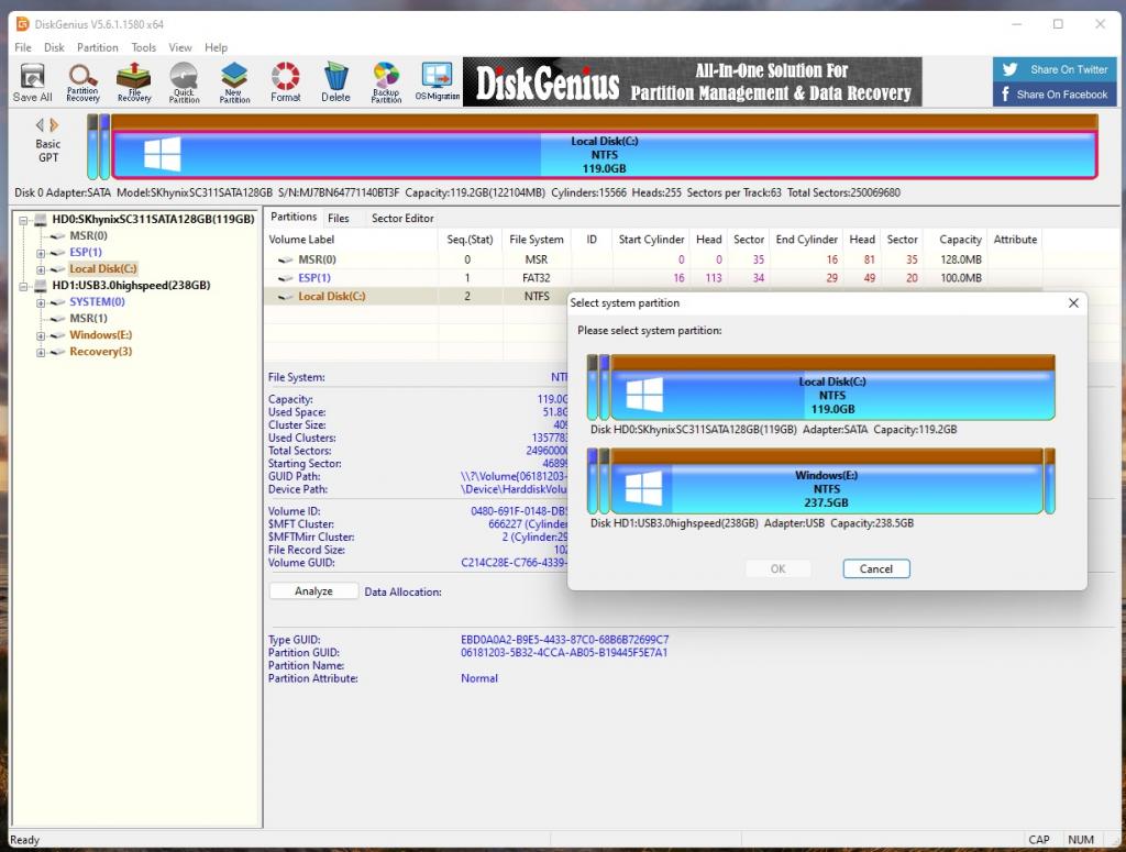

Hi, just posting experience. Years ago I cloned the win drive to another using free software. maybe a hdd to ssd or to use a larger drive.
The free cloning software is not free anymore :(
but I found "Disk Genius", https://www.diskgenius.com/free.php
I just used it on 2 win 11 pcs to clone from 120G ssd to 240G ssd.
It's so easy to use. get it while it's still free and keep the install.
stan

Posts: 2807
Posted: 05:29pm 14 Jan 2025
I should have said the drive to clone to is connected via sata to usb connector.
then swap the drives. ie open the case and change drive or swap the sata leads and hot glue the replacement ssd. check out free cloning software to see why I'm happy with disk genius... not paywalled.
Posts: 2807
Posted: 06:23pm 14 Jan 2025
I'm talking about free cloning software. there's not much left. bet this will be not free soon. spent some time trying free software to find it's not a free standard version but just a promo that after setting everything up to clone just offers, in a loop. saving you the same bother recommending disk genius while still free.
there's an open source cloner but it's linux file system so not as easy as disk genius.
