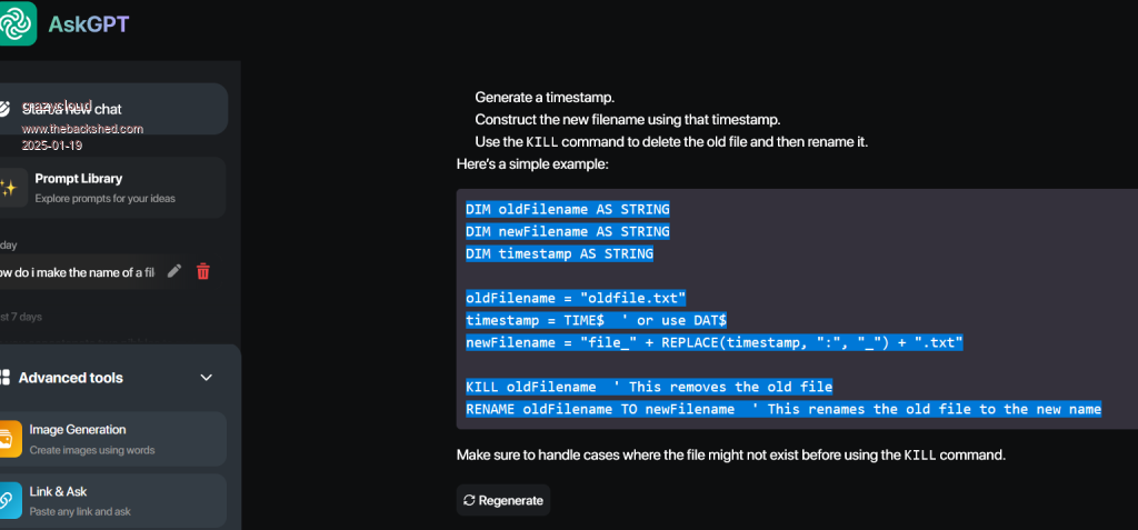

I'm editing this camera program written by Led_bloon. I'm trying to get it to generate automatic jpg captures that are sent to the B: SD card. I figured out how to rename the Test.jpg file after a fews days of trying (LOL , I'm very rusty).
I joined chat GPT and asked " how do I use a timestamp that varies as the name of a file" The answer gave me a clue.
here is the program. down around line 60 I have copy "*" to "b:" which i found out was illegal.  I tried to directly enter copy "*" to "B:/test".  It starts to copy but hangs, and never completes.
> copy "*" to "b:"
Copying 18-01-2025 17:50:32.jpg......just hangs here
I'm wondering is the name of my jpg file incorrect?
here's my screeen from chat GPT.  I can't find any books on basic so chat GPT helps with concepts.
I hope this helps someone.  My thanks again to Led_bloon!

A Peter often says, if you can reduce this to the smallest possible program that displays the behavior (this is not that, necessarily), it would help us debug it.
Also, Code tags significantly improve legibility:
