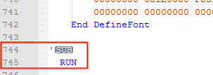

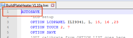

As already mentioned, Notepad++ is a great tool and the editor of choice for me. I like the way you can configure it for all sorts. Being able to edit multiple areas of the same file is a godsend not having to shovel large chunks of text back and forth. Bearing in mind, I develop straight into a console window, not a file transfer or anything... I embed commands and control codes in the source and deploying is simply a matter of Ctrl-A, Ctrl-C, right click in the (PuTTY) console window. Deployment takes 2-3 seconds which makes for a really quick dev environment
first line of file
last line(s) of file
(that "SUB" is embedded CHR(26) - Ctrl-Z and so terminates the transfer)

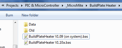

For versioning of sources, for me I find the best and most controllable way is to have multiple issues of the source and the filename gives further info. Each time I go to start a new session of dev, I copy the current file and rename accordingly. I put a header inside the source file, repeating the version number with the date and then summarise why this file exists. This way I always have a full history of my work and if I break something and it is too complex/time consuming to fix, I can always go back to the last known good version and delete any file forward of it. Seeing it written out like this makes it sound complex but it really isn't and with good discipline, I don't have to remember what I was doing if I take a break between efforts.
This requires you to be disciplined. Filenames are along the lines of
myprog Vx,yya.bas
so something like
WorkShopClock V2.02a.bas
first number x is the major version number -
V0. is "draft" or not issued, i.e. initial development and not released. By definition it cannot have alpha releases
V1. is the first "in the wild version"
any *substantial* rewrites/additions/new features & functionality will bump this to V2... V3... etc...
second number yy is a two digit number for tweaks and minor improvements without substantially changing the code, so a better version of a function might take it from 00 to 01
The trailing letter, a, is for alpha testing in the wild. So once you are at V1+, not V0 because it is not released. Live releases on any version do not have an alpha
When I start work on a new version, I clone the file, bump it's yy and add an alpha so from the example above, I can see the workshop clock is at major version 2, tweak 2 and and alpha 1. Once I decide the code is releasable, it will lose the alpha idents and become simply V2.02 and it becomes a "stake in the ground" version - a fixed point in a project's evloution.
The next version can be expected to be V2.03a. I will copy V2.02 and rename it accordingly, adjust the header and it is ready for being worked on. I might take several stabs at dev before I release a version but still want to try it in the wild... so
WorkShopClock V2.03c.bas
will eventually go to V2.03
Each project lives in its own folder. The source lives at the top level, below which there will be two folders: "Old" for older versions and code fragments from experimentation etc... and "Data" whch will be pix, grabs, notes, PDFs for special components etc.
here's a real example... current milepost version and an alpha:
