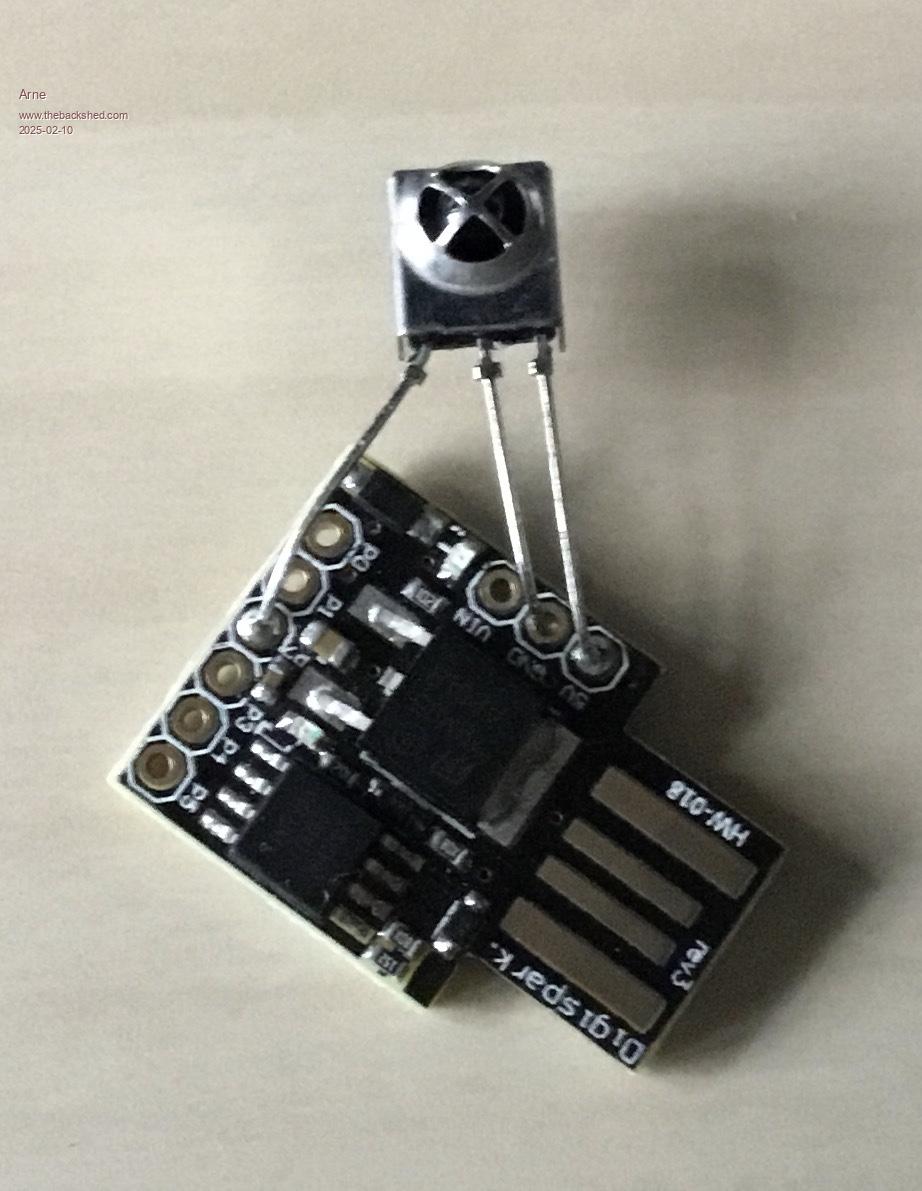

Now it is functioning on Picomite - USB too.
I changed some values in the usbconfig.h (VENDOR ID etc.) to data of my keyboard. After compiling the Digispark was detected as a Keyboard on channel 1.
Supported protocols are
* NEC
* NECx
* Philips RC5 and RC5x (simultaneously)
* Sony SIRC 12, 15 and 20 bits (individually or simultaneously)
* SAMSUNG old standard
* SAMSUNG 32 bits (16 of which are for error detection)
Details see https://github.com/LuisMiCa/IRsmallDecoder
Therefore nearly any old remote can be used for PC and Pico remote control. Until now I have checked NEC and SIRC 12.  Also data transfer from Pico to PC and from Pico to Pico (e.g. SIRC12 protocol) is easily possible. So pico could also be used as remote for the PC.

Frank
Arne
Joined: 05/01/2025
Posts: 55
Posted: 04:42pm 11 Feb 2025
@ Frank
Here a short description:
1.) On Arduino IDE first install „Board driver“ and Digistump (I used Version 1.6.8):
Details see: https://github.com/ArminJo/DigistumpArduino#installation
2.) Install IRsmalldecoder: https://github.com/LuisMiCa/IRsmallDecoder
3.) Install out of Adafruit-Trinket-USB „Trinket Keyboard“: https://github.com/adafruit/Adafruit-Trinket-USB
On Arduino IDE select with „include library-add ZIP library… “ folder „Trinket Keyboard“. Must not be a ZIP file!
4.)Find library - folder on PC (on my PC it is located C:\Users\myname\AppData\Local\Arduino15\packages\digistump\hardware\avr\1.6.8\libraries\DigisparkKeyboard) and exchange „usbconfig.h“ file to the enclosed file:
usbconfig.zip
5.) Load following test file to Arduino IDE and compile/write to Digispark.
Test_NEC.zip
6.) To test the IR-input open „Windows Edit“ and plug Digispark into PC.
Depend on the selected IR-remote (NEC/SIRC12 etc.) the relevant code will be typed on the edit - window of the PC if abutton is pressed. If you select IR_SMALLD_SIRC12 instead of IR_SMALLD_ NEC before compiling at the Test-Program you can directly send IR-codes from the Picomite via command IR SEND pin, dev, key to the receiver.
