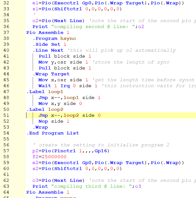

Posts: 6624
Posted: 07:33pm 10 Feb 2025
  Volhout said  Thanks Peter,
This works very much like the counter code I used t verify.
I noticed you indented the PIO code, as well as the .directives. I hope that will become automatic in MMEdit autoformat. I very much rely on autoformat.. lazy me.
Jim said his website would go offline in March. That is very soon. I am not even sure if he is going to do any more updates on MMEdit. Time is ticking...
I have an alternative site ready for when my website goes off line.
There will be one small update to MMEdit by then.

Posts: 6624
Posted: 06:27am 12 Feb 2025
A start with PIO formatting:
I will need to see a lot more code and the updated Appendix F, hopefully with a list of keywords.
Posts: 6171
Posted: 07:33am 12 Feb 2025
Wauw !!
Jim, this is great.
Keywords for the assembler are only few PIO instructions
JMP, WAIT, IN, OUT, PUSH, PULL, MOV, IRQ, SET, NOP
"NOP" is not a PIO instruction, but it translates to MOV y,y... it does nothing.
And the directives, I guess you have seen them all.
.program
.line                   in RP2040 documentation this is called .origin
.line next              is in essence a .line with "next" as a special case
.label
.end program            not listed in RP2040 documentation
.end program list       special case of .end program
.side set               in RP2040 documentation called .side_set
.wrap
.wrap target            in RP2040 documentation called .wrap_target
RP2040 documentation also supports ".word" but I have never used that. Similar .define and .lang_opt
These may not be implemented in MMBasic.
For RP2350 there are many more directives in the datasheet, but these have been covered already by the PIO helper functions i.e PIO(EXECCTRL n,n,n,n,). Examples are .clock_div and .fifo
So I think above summarizes it well.
Edited 2025-02-12 17:59 by Volhout
