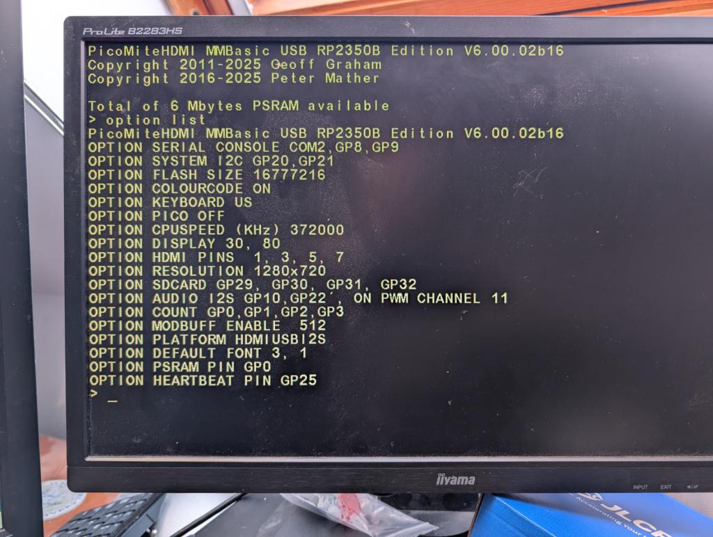

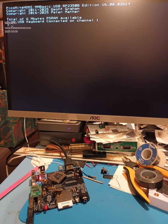

This project seems to have come to a sudden stop. I attempted to test HDMI at 1280 and, in spite of clearing the flash (I think), it seems to be bricked now. Even the console isn't working.
May that be a warning to you all - the PGA2350 mustn't be pushed!
I'll try a bit further but no promises. I'm unwilling to shell out for another PGA2350 at the moment, if at all.
Edit:
It's back but there is definite weirdness with HDMI. Mind you, I don't fully trust this monitor with HDMI. It's shown problems with the PicoMite version in the past and is very poor at switching between normal HDMI and the PicoMite version, taking a while to re-synch. I'm currently testing with 640, 252000 to give it the best chance.

Posts: 3411
Posted: 11:24am 06 Mar 2025
Something that may be worth a try, assuming 1280 made the CPU speed too high.
On a Pico2 I set the CPU speed too high and it appeared bricked. ClearFlash and reloading firmware didn't work but loading a different firmware version and type got it going again. Then going back to the original firmware worked.
I wondered if the CPU speed is not erased by ClearFlash.
In your case perhaps load an earlier version of the VGA firmware, as its CPU speeds are different to HDMI. That may force it to the default speed and get it working again.
Posts: 9206
Posted: 11:29am 06 Mar 2025
I've just done more or less that - going back to the original firmware (b14). You may have a point!
Posts: 12016
Posted: 11:41am 06 Mar 2025
Try this at 1280
PicoMiteHDMIUSBV6.00.02b16.zip

Posts: 9206
Posted: 12:24pm 06 Mar 2025

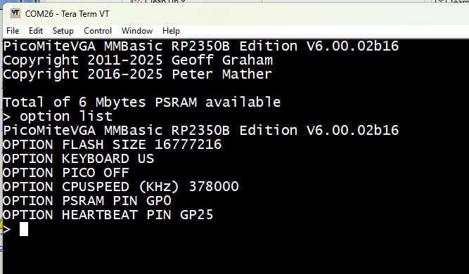

I've not managed to get it to run yet. In fact, it took a couple of reinstall attempts to get it back out of brick mode and back to b14.
I'll have another try now it's running again. :)
Posts: 9206
Posted: 12:37pm 06 Mar 2025
Nope. Nothing, not even the console. I tried wiping the flash first too. It will go back to b14 though!

Posts: 9206
Posted: 12:50pm 06 Mar 2025
I now have *a lot* of reservations about the PGA2350.  :(
It's probably fine as an embedded controller and it might be fun to put it on a 16-bit parallel LCD display.
Posts: 12016
Posted: 12:56pm 06 Mar 2025
Full speed vga too...
