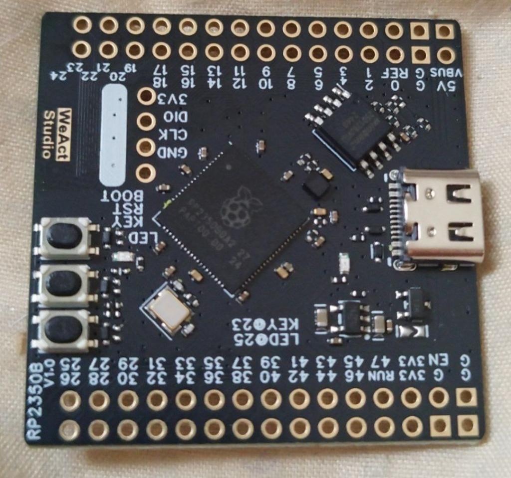

![]() Edited 2025-03-04 22:54 by javavi |

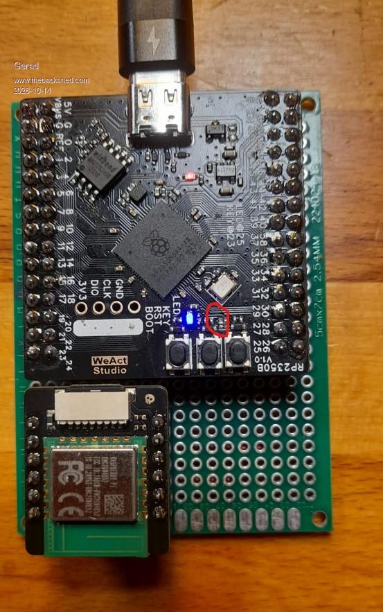

A reliable board. I just bought 10 of them. The size reminds me of the Intel 486. WeAct PSRAM CS is connected to GP0. Perhaps the PSRam option can also be set to GP0. If not—no problem—remove R14 and connect the solder pad to GP47, and the PSRAM will work. This is described several times on the forum. RM2 Wi-Fi module. Connect the GP23, GP24, GP25, and GP29 to the RM2. To ensure the board runs without a reset, you’ll need to remove the zero-ohm resistor on the WeAct board (see photo).Firmware Webmite 7.0.00B8 works without any patches, etc., without any problems. Regards Gerad ![]() Edited 2026-10-14 06:50 by Gerad |
