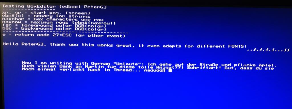

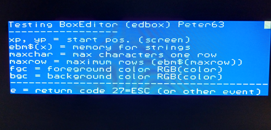

Daniel,
I have made a Subroutine I call edbox (BoxEditor), which I think you can try. It may contain some errors, but as far as I have tested it seems to work. Please come back if you find any strange things.
edbox.zip
/Peter63

Hi,
I've tested your BoxEditor and I am really happy with it. Can't find any problems yet! Exactly what I searched for. Now I only have to shrink / optimize the code from my GUI Editor   ...
Do you plan to make something out of your small programs? I am just curious and was amazed by your Paint program, which I am using quite often just for fun   Good work!
Greetings
Daniel
