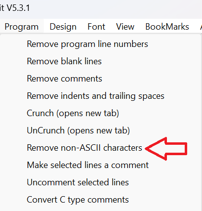

I have released MMEdit5 V5.3.0
The syntax files need further updating. That will happen when time permits.
Changes:
MMCC random window closing hopefully fixed.
Bug in MMCC abort file transfer fixed.
MMEdit now highlights all occurrences of current word.
Picomite PIO code included in syntax
Numerous small bugs squashed.

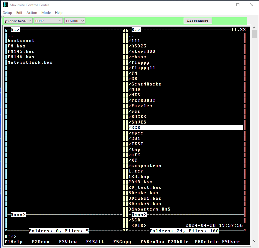

If I may make 1 suggestion for PicoMite VGA/HDMI: In MMCC filemanager, when you open the filemanager, send "MODE 1" before you start the interaction with FILES and XMODEM.
When the VGA mite is in mode 2 (40 columns width) all filenames are wrapped to the next line.
MMCC Similar for "Send Listing To Editor", lines are wrapped with terminal (screen) width. If you would send "MODE 1:FONT 8" prior to the transfer no line wrapping would occur.
Edited 2025-04-04 17:19 by Volhout

@Vollhout,
MODE 1 FONT 8 is probably not a good idea ...
> option list
PicoMiteHDMI MMBasic RP2350B Edition V6.00.02RC9
OPTION FLASH SIZE 16777216
OPTION COLOURCODE ON
OPTION KEYBOARD US
OPTION PICO OFF
OPTION CPUSPEED (KHz) 324000
OPTION RESOLUTION 1024x768
OPTION DISPLAY 128, 0
OPTION HDMI PINS  1, 3, 7, 5
OPTION MODBUFF ENABLE  192
OPTION PLATFORM OLIMEX
OPTION DEFAULT FONT 3, 1
OPTION PSRAM PIN GP47
which ends up in a listing with is only 1 column wide. This is at least the situation with HDMI. Up to FONT 7 it seems to work, at lest it gives
OPTION DISPLAY 96, 170
Don't know if this is a bug in the firmware or intended behavior.

Hi Gerald,
In my VGA (RP2040 VGA PS2) unit MODE 1: FONT 8 results in DISPLAY 80,160.
Maybe this is caused by the difference in resolution. Mine is 640x480, yours is 1024x768.

Posts: 11830
Posted: 06:12pm 04 Apr 2025
It's a bug - will fix. Option.Width is defined as a char = 0-255. 1024/4=256 oops.

Posts: 6603
Posted: 09:01pm 04 Apr 2025
  Volhout said
Suggestions:
MMCC does change to MODE 1 but the decision if to change needs some work to allow for the new modes.
I don't have a working VGA or HDMI unit to test with and even if I did, I am well behind the current thinking.
I will get there eventually.

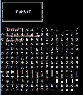

Jim,
Is it possible to create such a font so that your MMCC terminal could correctly display all the symbols of the PicoMite VGA/HDMI FONT 1 encoding?
And if such a font already exists, how can it be configured?
Thank you.
Posts: 6603
Posted: 04:48am 05 Apr 2025
  Quote  Is it possible to create such a font so that your MMCC terminal could correctly display all the symbols of the PicoMite VGA/HDMI FONT 1 encoding?
Possible, Yes.
Easy, No
I haven't had much experience creating TrueType fonts but you could start with a font that has the line drawing characters.
Ubuntu Mono is a good start as I think it is not under copyright.
If you aren't concerned with copyright, Courier New has more of the other characters.
Once you have chosen your font to copy,
move the other characters that exist in the font to the correct character position for the MMfont. A lot of the MMfont characters are in many fonts, just not in the correct position.
You can then search the unicode library looking for the rest of the characters. Some will not be found.
Then you are left with the characters that need to be drawn by hand.
Easier would be to create a bitmap font but it would need a number of sizes to be of much use.
MMCC allows any TT font and Windows style bitmap fonts.

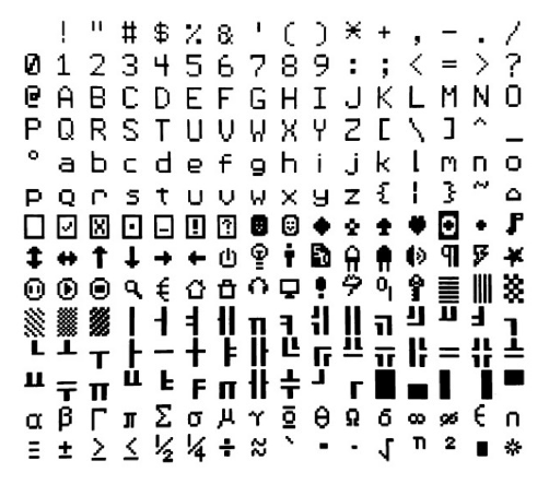

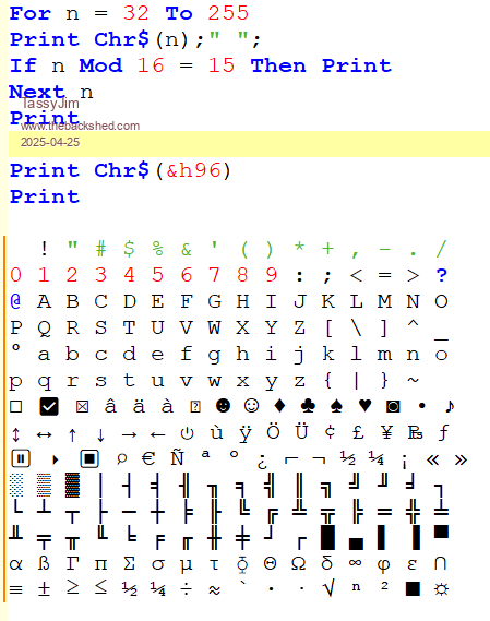

  pwillard said  SIDEBAR: I have extensive experience with TTF font creation and own commercial font creation software, but I have little experience with the VGA/HDMI fonts.
Hi pwillard,
We need a font for a Windows computer with the same character encoding as PicoMite VGA/HDMI. If we have such a font, it can be selected as a font in the terminal program for the correct display of PicoMite VGA/HDMI program characters and on the PC console.
pwillard
Joined: 07/06/2022
Posts: 344
Posted: 04:51pm 09 Apr 2025
Well, the glyph mapping would be a concern beyond the normal letter/number/symbol assignments. (meaning anything after the 'tilde' character.)
Though, this does have a lot of overlap with the DOS 437 font.

javavi
Joined: 01/10/2023
Location: Ukraine
Posts: 603
Posted: 10:00am 12 Apr 2025
Installing the Perfect_DOS_VGA_437 font partially solves the problem of displaying the pseudographics symbols of the PicoMite encoding.
For some reason the font is displayed with a line break
