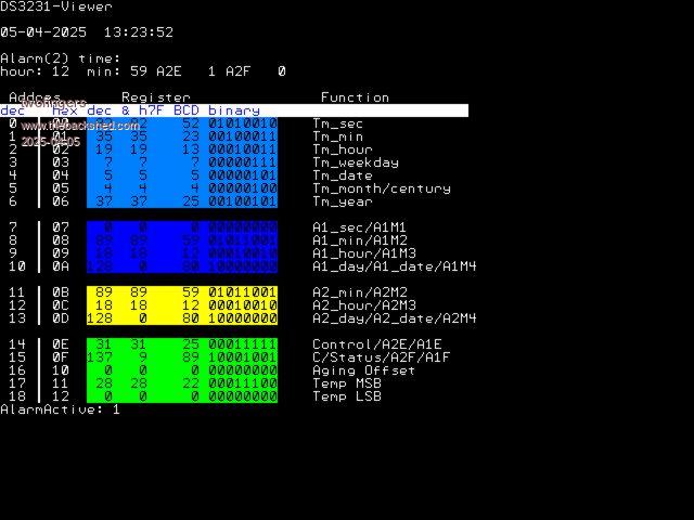

It's not directly related to the question, but I remembered that a few months ago I created (or played around with) some alarm routines for DS3231.
Maybe they'll be useful to someone. I'm not sure if I found the right file, but I think the program illustrates the RTC and the alarm status well. Alarm (2) is set with the "A" key. A routine for Alarm 1 is also available.
DS3231view.zip

Thanks everyone for your input.
@Mixtel: Good idea but I am now home and have access to the power of the shed   Thanks anyway
@BigMik: Thanks for this Mick, I do have a pull up on the pin and I put a 10nF to ground as well just to snub any noise.
@TwoFingers: I like that prog. It would have saved me all the horrible bits n bobs testing to get this far.
@ville56: Thanks that doc seems to be a re-brand of the same one I have. Sadly, it also misses the bit where it tells you how long the /INT/ pulse will be (see below)
@Phil99 that was my thinking t0o - that it was just a logic function on the registers. Now I managed to scope things and I put a "press any key" right before I reset the flag, I can confirm that the /INT/ pin remains LO while the flag persists - A2F in my case but I am gonna make the jump and say its probably the same for A1F too. And below you can see my trace output: First figure is the time from going into SLEEP to the time taken to come out and do some checks... 400 odd mS from the gentle 5MHz '170   but something important is revealed...
