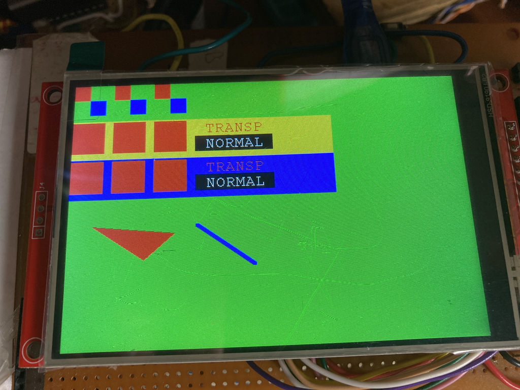

Peter,
I have an ST7796S and have sort of got it going on the Armmite F4.
I had to set the delay to switch back to Write mode to 5ms to get it to work.
i.e.
//#define ST7796Schangetowrite  1600
#define ST7796Schangetowrite  5000
Also BLIT READ and BLIT WRITE need a extra read in ReadBufferSPI before they work and the colour of WRITE copy is not quite correct.
On a Picomite I had to recompile with the same changes to use any read operations.
As a first step can you confirm this program behaves as expected on your ST7796S display.
i.e. Transparent text,BLIT, BLIT READ/WRITE

Posted: 11:08am 18 May 2025
Hi Peter,
No luck with that one.
I can get it to work reliably with the following changes
The delay set to 4500
and doing a wait at the end of ReadBufferSPI.
#define ST7796Schangetowrite  4500

This is my test program result.
The first column is the source.
Next column is result of BLIT READ / BLIT WRITE
Next column is result of a BLIT.
Next is TEXT and Transparent Text
Triangle and LINE AA I think call ReadBufferSPI as well.
Various subtle things occur when it not right.
e.g. BLIT and BLIT READ/WRITE can give incorrect colours.
It seems to be correct with the two changes above.
Maybe its worth printing out the chip ID and see if its different from yours.
The test code is below.

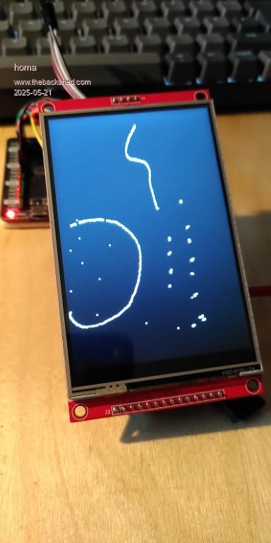

homa
Joined: 05/11/2021
Posts: 718
Posted: 05:31pm 18 May 2025
OK, my ST7796S display has arrived. Which pins are best to use with the Pico? Do you have any recommendations, Peter?
OPTION LCDPANEL ST7796S,orientation, DCpin, RESETpin, CSpin [,backlightpin] [,INVERT]
I don't have a pin header soldered into J4 yet, but I need to do so for SD card use, don't I?
Otherwise, could you just provide me with your option list? I'll try to make sense of it.
Thanks in advance.

Joined: 18/12/2014
Posts: 1158
Posted: 04:04am 19 May 2025
  matherp said
If you can work out why the delay is needed at all it would be good
Hi Peter,
I think I have stumbled on the solution for not requiring the delay.
On the Armmite I have it working with #define ST7796Schangetowrite  1
i.e. 1 uSec. I have not pulled out all the code for the delay but I suspect its not need at all.
P.S. All delay code removed and its still good!
    also removed from Picomite RC23 and recompiled. All good.
The fix is to bypass D1 in series with CS on the board as covered in the post below.
I added jumper J1 (for 3.3v) as well at the same time so not 100% sure which fixed it, but suspect its the D1 bypass.
Extract from post.....
Some ST7796 (and ILI9486) displays have a diode inline with the TFT chip select. This is a board design error as there is nothing the other side of the diode to pull the TFT chip select high. If there are other devices on the SPI bus, such as a touch controller then this diode is likely to cause problems.
It would affect how long before CS wanders to the high state, so we needed a delay to ensure CS went high after the read, before it was pulled low again on a write.
Link to solution
