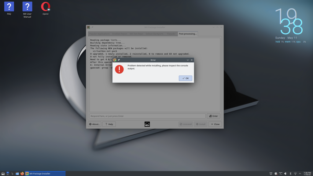

Tried to install VB on MX Linux tonight, but it failed with an error message, but I don't know WHERE to find the console output it is directing me to.
There is no tab in the background, indicating that this is where I need to go, but even if there WAS, I would still be a bit lost.
Can anyone help?

This is a bit of a red line with vbox for all the years and I'm using it since almost 20 years. Be sure you are using the latest realease. I'm using 7.16 and it runs fine so far.
My suggestion with Linux and Vbox for you is, to not use a debian based distro but an Ubuntu based one. Important is, that the sources for universe/multiverse  come from Ubuntu. Not that Debian is not good, but if you want to have the (by far) best support then choose ubuntu.
This is simply because Linux as desktop OS has not many user and if there is a common base, then it's ubuntu.
Mint as well offers a debian based version. No fun if you want to try this and that 3rd party software software.
e.g. SystemV init was replaced by cannonical and debian is not following. They have changed so many basics that system near software, especially when the software has its own kernel modules which are then build on top with dkms its very likely you run into these problems.

I'd be very surprised if VBox won't install on MX. It may be easier on something else, but I doubt if there's anything to prevent it. Isn't it in the MX repos?

  Mixtel90 said  I'd be very surprised if VBox won't install on MX. It may be easier on something else, but I doubt if there's anything to prevent it. Isn't it in the MX repos?
You are right I think. But if a newcomer asks me I would never suggest genuine Debian
as base.
dddns
Joined: 20/09/2024
Posts: 924
Posted: 08:59am 11 May 2025
  Quote   Isn't it in the MX repos?
I'd say it ironic: for sure they have version 5.x in their repos..
I'm using:
deb [signed-by=/usr/share/keyrings/mykeys.gpg arch=amd64] https://download.virtualbox.org/virtualbox/debian jammy contrib
to be precise: the distro itself does not care about vbox, same with ubuntu. they have almost never their "own" version but if you install it without change under MX, you will get packages directly from debian.org
Sources that MX provides care only for the changes MX team does to debian genuine
And now with flatpak, appimage and ubuntu 24 the situation worsens or, if you want to see it from a convenient user perspective, it's getting easier with compatibility
But I think software relying on own kernel modules will ever be installable
Yes, I thought so, anyway.
I just used the MX Tools/Package Manager app thing, found it in the drop-down tree of all the software you can install, clicked that and followed my nose from there.
It was then I got the error.
Unless I am supposed to be installing it in some other way?
Thanks for the link to Github, dddns, I have loaded it in a tab, and will have a bit of a read through it later on.

Go to their side, download the required package and double click it. That should do it.
