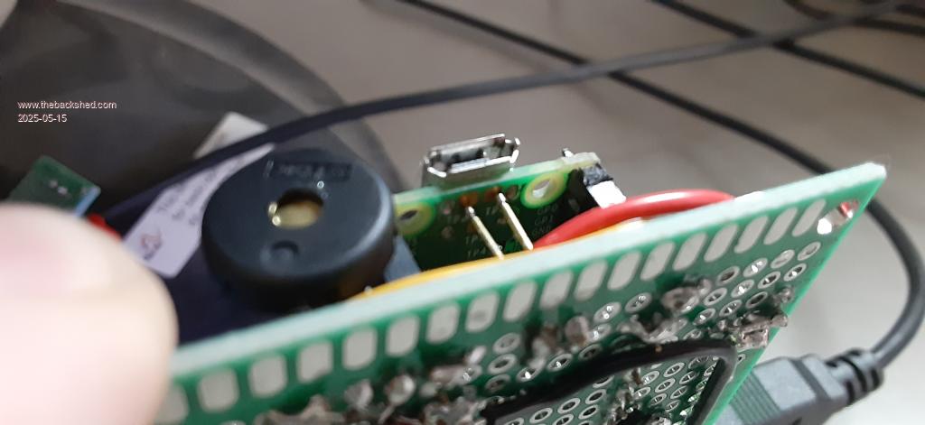

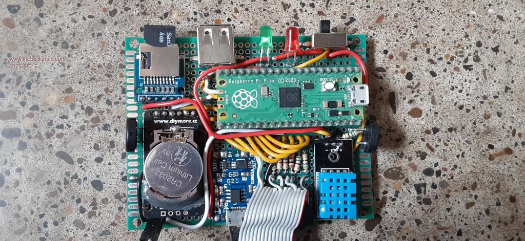

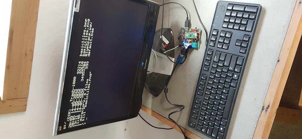

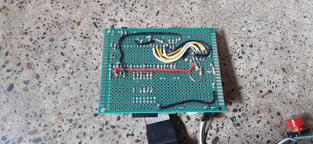

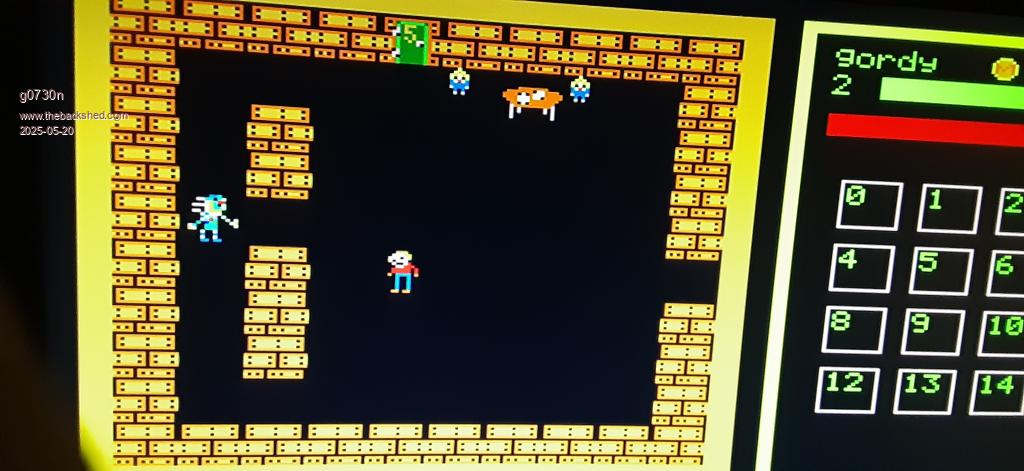

I ended up building my PicoMite on a protoboard and used components I already had.
It all works great and all that is left to do is print a 3d case for it. The AC adapter for the laptop i use for all my printing failed recently so I am waiting for the new one in mail.
Features:
-VGA OUTPUT
-USB KEYBOARD
-DS3231 RTC
-DHT11 Temp/Humidity Sensor
-SD Card
-2 LEDS (GREEN = PLUGGED IN, POWER OFF), (RED = PLUGGED IN, POWER ON)
-Breakout pin header for unused GPIO (Currently not wired up)
-2 Passive Piezo Buzzers for audio output. I did not know if this would actually work for playing a WAV, but it does!
-Slide switch for Power
-RESET Button
-TP4056 LiPo Battery charger (I didn't have Micro USB breakout, so ended up using one of these for the breakout. I may implement a battery in future for something so there it is)
I used Pogo Pins for the USB D+ and D- to avoid soldering directly to pico test points, it actually seemed to work great!
My protoboard soldering work is never pretty, and takes about 10x longer than a PCB, but here are some more pics.
One thing I am wondering is if I can have any other serial devices attached if I also have SD Card installed on RP2040 VGA USB.
I would like to interface with an nrf24l01 possibly in the future.

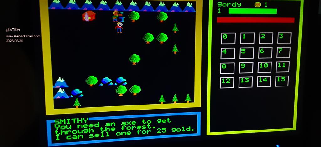

But aside from that I am going to play around with writing some BASIC programs! The graphics capabilities of PicoMite are looking pretty awesome makes me want to make a small game.
dddns
Joined: 20/09/2024
Posts: 909
Posted: 09:43pm 14 May 2025
Well done!
sdcard and serial are completely different and yes, you can have a second serial port for your basic program to access. This is very good described in the manual appendix A and following.
Happy tinkering and try a 2350 for even more fun

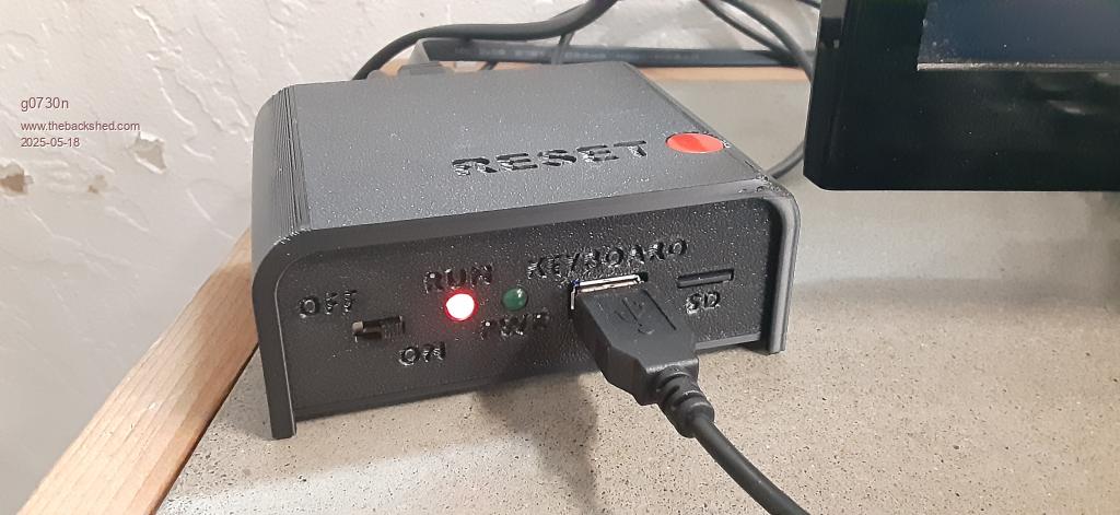

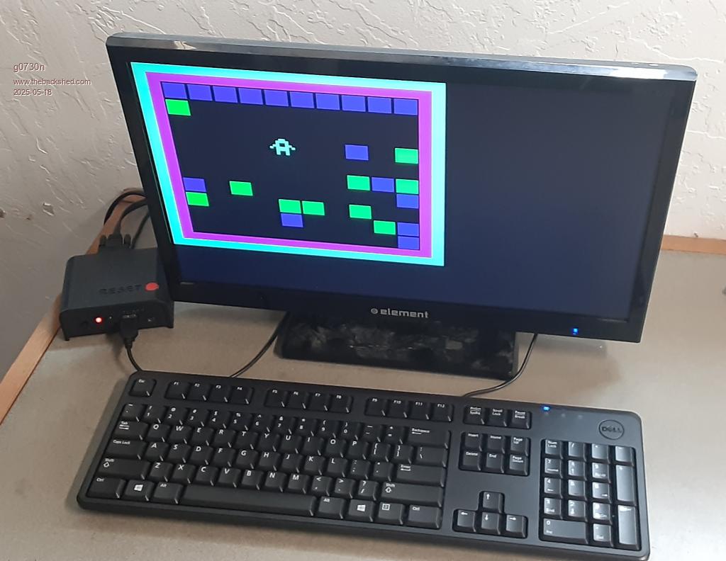

Awesome! I will start looking into writing a driver for NRF24l01 for this thing. I think it would be cool to have the ability to get temp/humidity from arduino sensor outside over the RF.
I was able to get an AC adapter for my laptop and printed a case:
And am using a small TV instead of the other monitor. It has USB port in back so powering picomite from that. Turning on/off TV also turns on/off picomite. Plan on printing a VESA mount to attach to back.
dddns

Very very nice results already after this short time! Congrats.
What are you using for CAD?

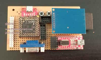

if you start off with no pcb then strip board works

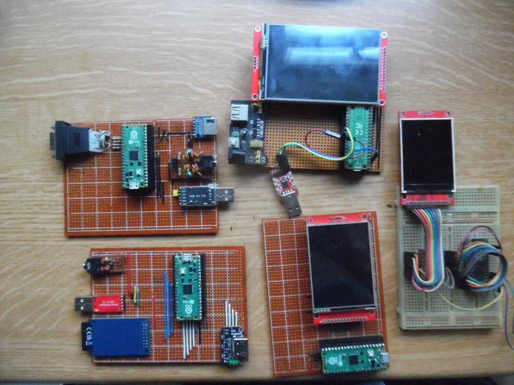

Great collection and very nice done but one type is missing :))

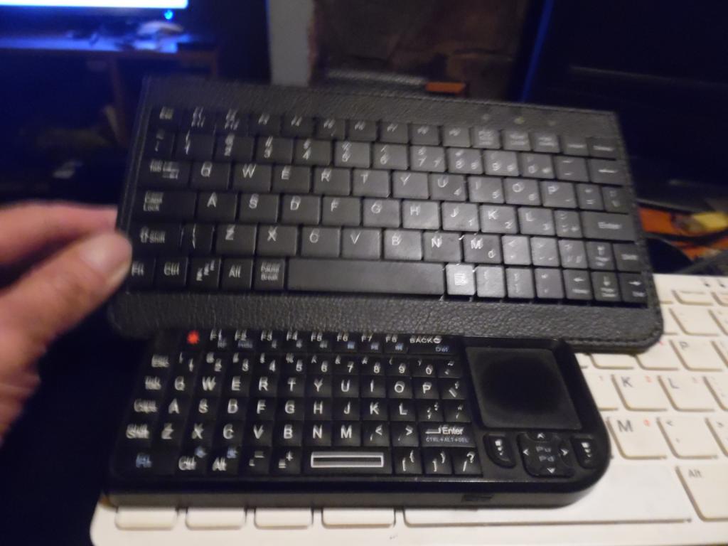

Does your mini keyboard still work??

I use the hdmi usb and mini usb kb ok and mini wireless dongle kb ok.
just a rant that you need a pcb to use mmb rpi when cheap strip board is quicker??

  lizby said  Very nice, neat job. Looks like a computer.
Fusion360 is what I use for designing all 3d models. Ideally I would use something open source such as freeCAD or Blender, but all my attemps to learn those hit a wall.

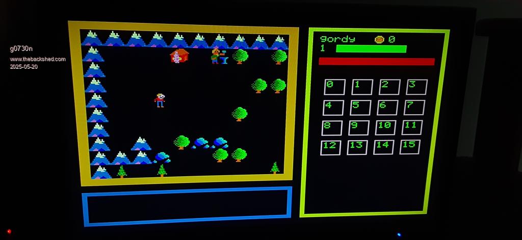

A program I was thinking it would be cool to write for such a computer is a simple spreadsheet program. I use LibreOffice Calc heavily for my business stuff, but also some smaller sheets for personal record keeping. These smaller sheets I think would easily be readable/editable by a lightweight program. Then the possibilities of visualizing the data with MMBasic are endless!

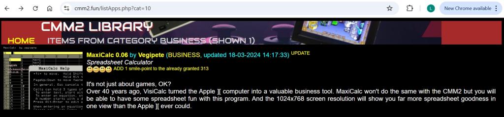

  Quote  A program I was thinking it would be cool to write for such a computer is a simple spreadsheet program.
VegiPete wrote one for the CMM2.
It's shown on the site, CMM2.fun, but the link to the zip file doesn't do anything. VegiPete still posts, so if you're interested in porting it to the PicoMite, you might be able to get the source from him. It probably wouldn't have run well on the early versions of the PicoMite, but possibly could do so now.

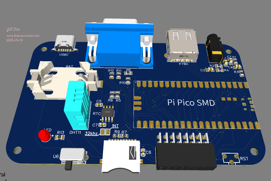

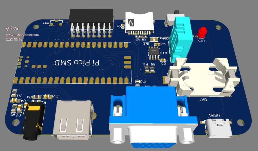

Here is my current layout for the PCB version. Was trying to get all cables to plug into one side, and all user interaction (Reset Button, power switch, LED, and SD) on one side. Ended up being slightly larger than originally planned but it's still small
Posts: 3859
Posted: 12:48am 19 May 2025
Very tidy. Do you solder smd yourself, or would you have have JLCPCB do the whole job?
You might want to have the DHT11 socketed, or use a DHT22 or AM2302. People here have reported that the DHT11 humidity sensor very quickly goes out of spec. I think TassyJim regularly bakes his in the oven to reset it (I'm not sure over what period of time or for how long at what temperature). DHT22 may not be much better.

  lizby said  Very tidy. Do you solder smd yourself, or would you have have JLCPCB do the whole job?
I hand Solder the SMD. It is very tedious, but have had success soldering TSSOP and down to 0402 components. If there is enough space I usually choose 0805 for more easy soldering.
I am probably going to ditch the DH11 entirely for the BME280. It is I2C, and the placement on board puts it right next to I2C bus used for RTC. More expensive but way more accurate and also does atmospheric pressure. I wasn't sure if there was any support for it or if I could write my own driver, but looks like someone did it already !
https://www.thebackshed.com/forum/ViewTopic.php?TID=8362
I used DHT11 in current build because I have a handful of them in a box and saw there was already support baked into firmware.
