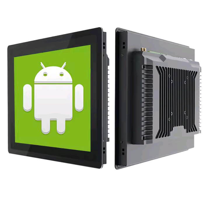

PhenixRising
Joined: 07/11/2023
Posts: 2050
Posted: 07:26pm 16 May 2025
This is 19" but they are available in all sizes. I also use Bluetooth keyboards with mine.
Android is really cool. No messing around, up and running in no time.

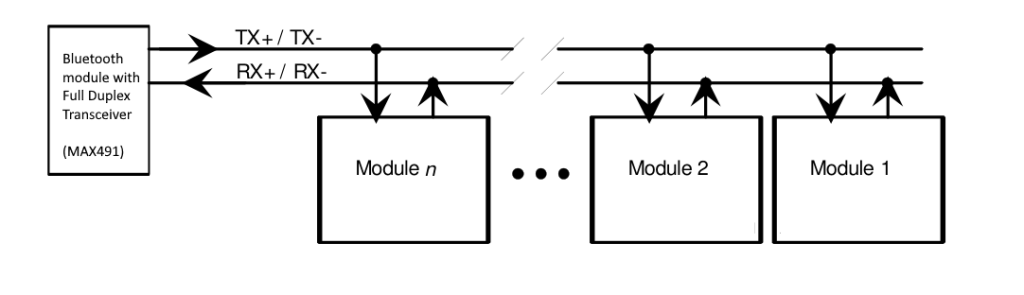

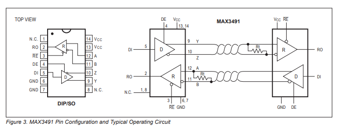

dddns
Joined: 20/09/2024
Posts: 909
Posted: 11:48am 17 May 2025
this maybe?
Another possible way
