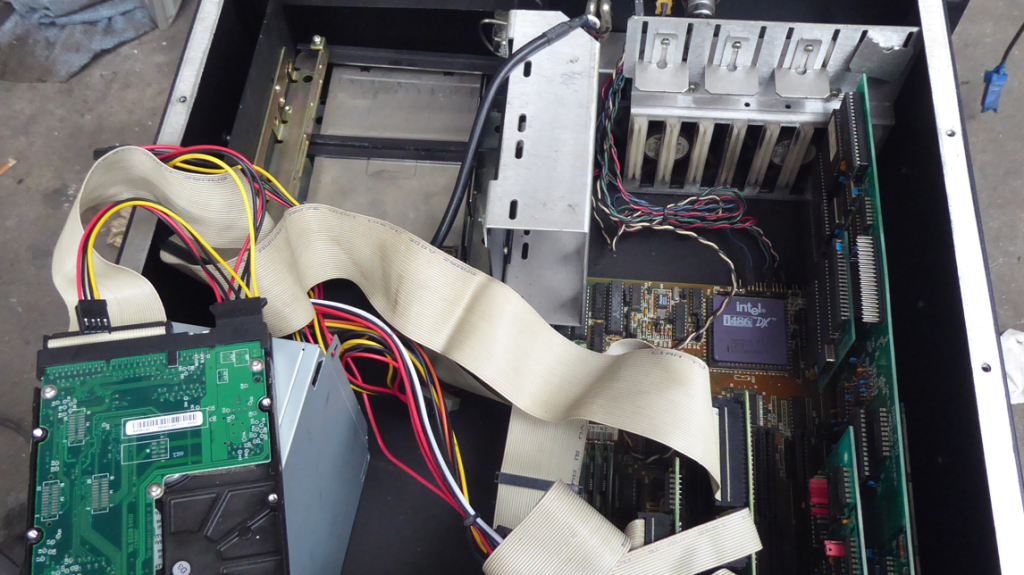

This is one of two that I just received in the UK, sent from North Carolina.
It's a PC-based control that I used to program in QuickBASIC but the real-time was MASM. Such great times because QuickBASIC made programming a piece-of-cake.
I stopped building this model in 1991 and I see that the hard-drive has been replaced in year 2000.
Works perfectly. They only sent them to see if I can replace the floppy drive with one of those USB emulators.

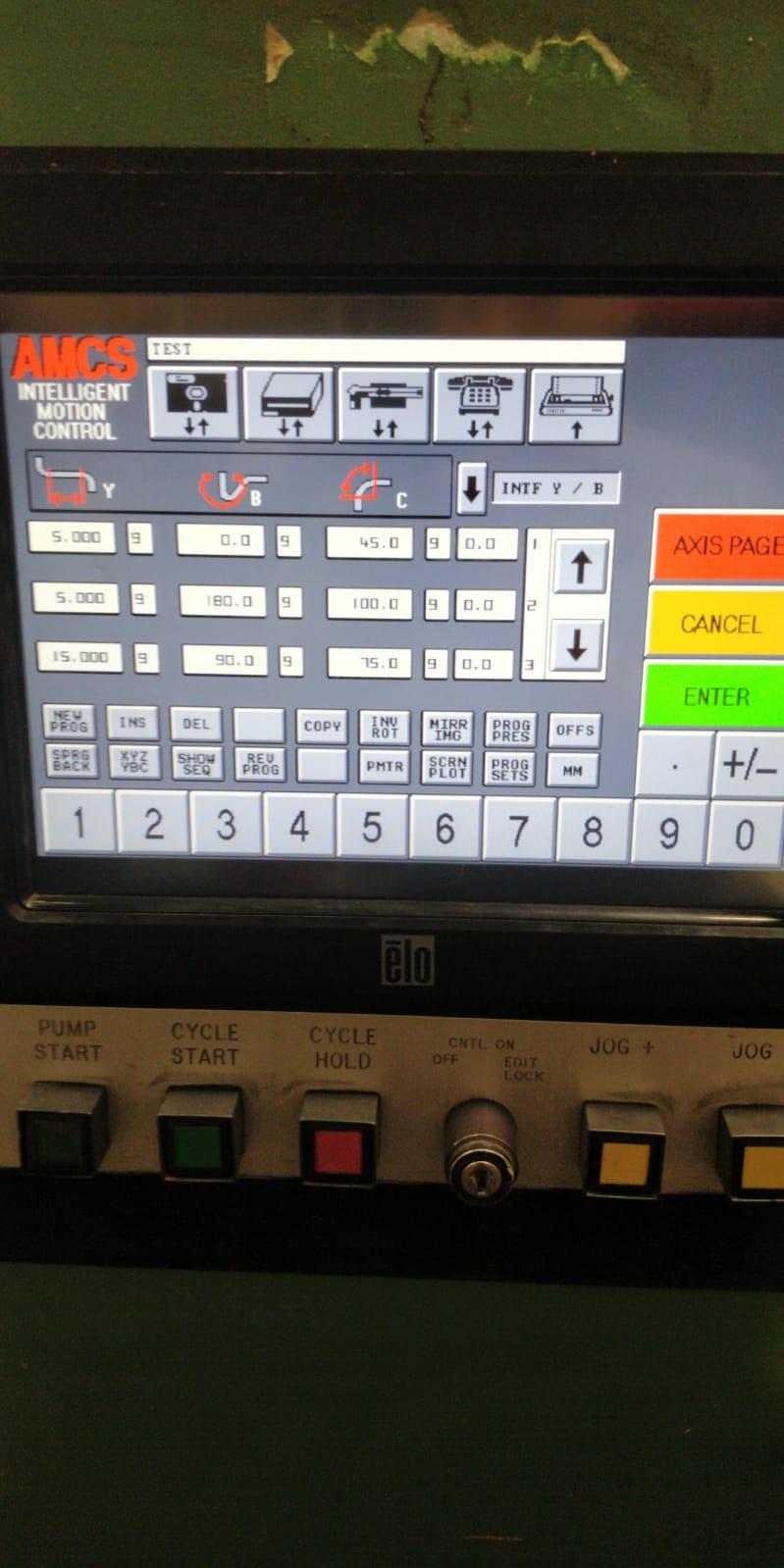

The 640 X 350 (EGA) DOS GUI with touchscreen:

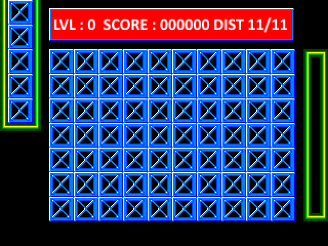

Volhout,
  Volhout said  PicoMite can do that. Another challenge ahead...
that was also my first thought.
He has not published his listing, but as he says himself, it is not optimized. That's why it's probably easier to completely rewrite it.
 With a tile(not the MMBasic-TILES)size of 24x24, the playing field could be divided up as follows:
(rough draft)
If you like I can draw the tiles for you.
cheers
Martin
'no comment
PhenixRising

  Martin H. said  Volhout,
(rough draft)
cheers
Martin
That would be nice. I am in doubt how to use the layer structure in the VGA (and LCD) mites. The guy in the video had to cut some corners to make it work in a 500/1200.
Since the pipes always appear on the (blue) square/cross background, you don't need many tiles I think. You could tile on layer L with the fluid path transparent, and the outer edge transparent. So a tile would have blue cross, and pipe segment. (and one tile without pipe segment, only the cross.
The focus would be by painting the border below tiles area on layer N. Flowing the water by slowly filling the area below the tile with color on N.
Is this also what you where thinking ? I think it would be more difficult if you have pipes on L and blue cross on N.
P.S. the game in the video is not final, water has to follow all the channels, not only START-END.
P.P.S. I like the faces on top that blink at you....
P.P.P.S currently working on "boxing up" my Game*Mite. It needs some TLC, and I plan to blow a bit of fresh air into the Game*Mite platform. First I have to make all software run again on 6.00.02 since these have been changes in the language. I will issue 2 new UF2 files for 2040 and 2350 game mites. This game may be VGA/GM compatible.
Edited 2025-06-25 23:30 by Volhout
Martin H.
Joined: 04/06/2022
Posts: 1509
Posted: 05:27pm 25 Jun 2025
Here are the existing directions. I think it's a good idea to do the filling over the N layer. As you can see in the picture, I chose magenta as the transparent color again (out of tradition)
Pipes.zip
Edited 2025-06-26 03:39 by Martin H.

Posts: 6038
Posted: 08:23am 26 Jun 2025
Pipes.zip
Thanks Martin !!!
I may adapt the tiles a little to also allow the focus color in the corners. But this is a good starting point for me.
You must be a bit patient through. I first need to finalize my Game*Mite tasks.
Edited 2025-06-26 18:25 by Volhout

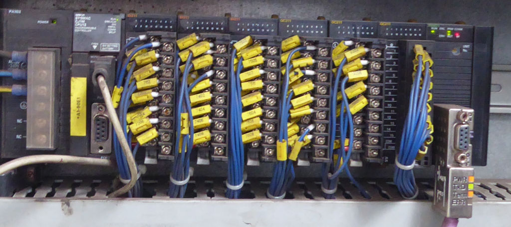

This, along with DeviceNET is being replaced with the PicoMite
Blow one of the sixteen 2A outputs and you have to replace all.
