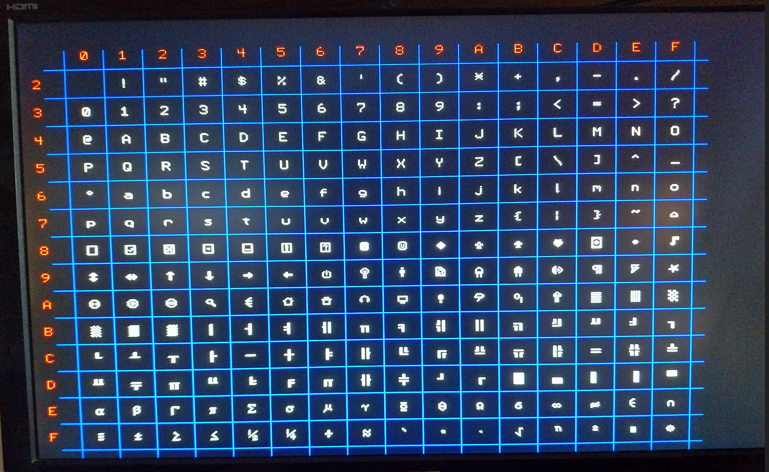

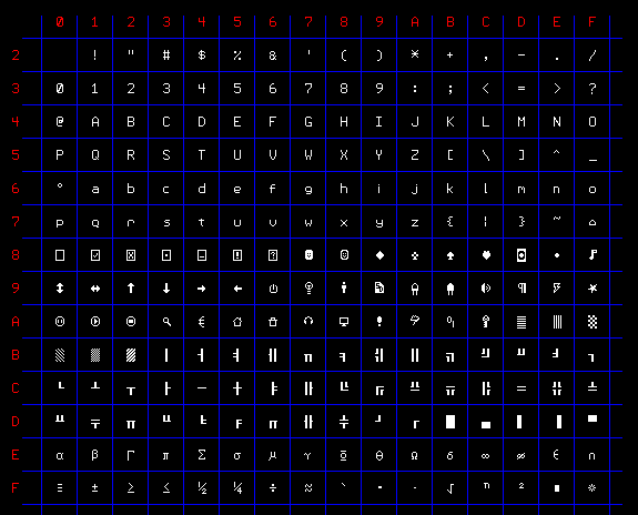

A small program that shows all the characters in FONT 1
The manual shows a table but unfortunately does not show which hex code the character has, this program shows this.
There are many characters I did not think of but that are there, such as "light bulb" = hex 97 or "SD-card" = hex 99
Is it a house on hex A5 or are it headphones on hex A7
asc.zip
It would be interesting to know who created these fonts, does anyone know?
Maybe Geoff or Peter knows the history...

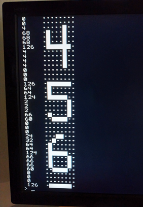

You can also print the entire FONT1 as it appears in memory. See attached program. I use MM.INFO(FONT ADDRESS 1) to find the start of FONT1.

This is what the program font1.bas looks like, where you can see the DEC code on the left. Each character in FONT1 is 8 x 12 (width x height).
