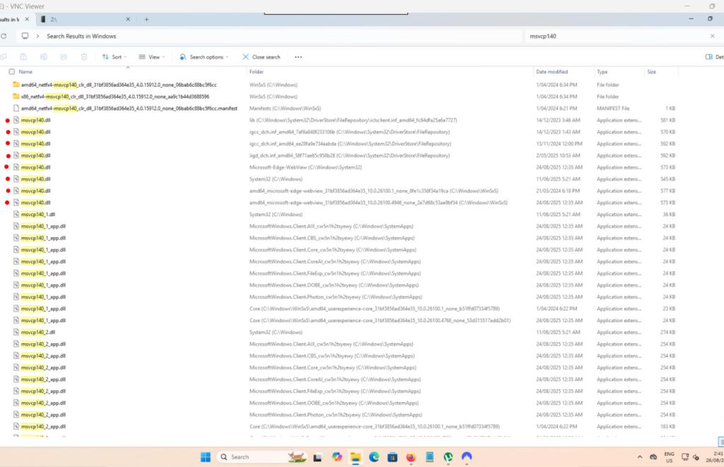

I searched for MSVCP14.DLL on my PC and found the DLL in at least 8 places (marked in RED on below screen cap) and many more derivatives of it on the PC
A search for VCRUNTIME.DLL shows 8 locations with the file and many more derivatives of it.
This is rather frustrating as it is to replace a failing 24/7 mini PC and I have it all set and working as I want except MMB4W where I run a program to monitor my weather station.
If anyone has any ideas please let me know. I have rebooted many times after installing the VC_redist package so it isnt that.
*** EDIT,
Added a zip of above image as it is unreadable after the forum compresses it.
MSVC.zip

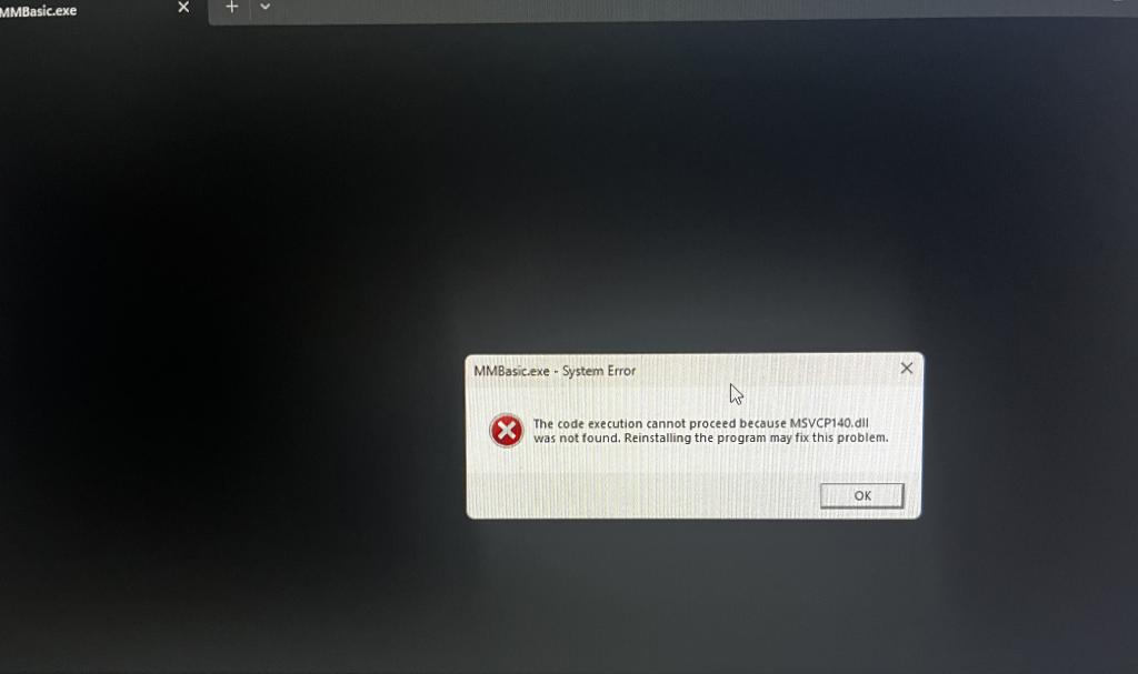

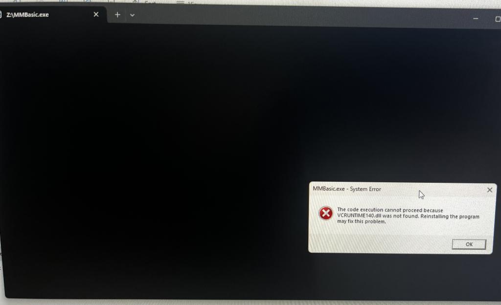

Posts: 2982
Posted: 05:39am 26 Aug 2025
Hy Bryan,
Yes that was the first issue/PiTa, but windows eventually decided that it would allow me to run MMB4W without me having to say "pretty please" each time.
Its just that MMB4W will not run on my new W11 PC. I get the following error on running MMB4W
After clicking OK I get this error
Apologies for the bad quality, I couldnt screen capture as I run it through a VNC program so they are phone captures
*** EDIT
Sorry the images are the wrong order, I get the second image error first then the first error image
Mik
