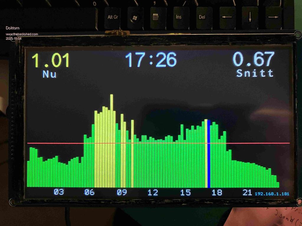

Thanks everyone for the tips and suggestions.
matherp, your suggestion about adding group name to Json$ files is correct. Works as expected. But for now I will use my current design which consists of an ESP32-S3 with Annex RDS which retrieves and beautifies the Json$ file. The ESP32 then sends the result serially to the pico. It works great.
Here on a Pico with 7" SSD1963  ( the SSD1963 is not supported in Annex )
/Lasse
