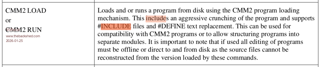

  Volhout said  Use include for the section you need to add
Include ??
Posts: 9136
Posted: 09:01am 25 Jan 2026
No idea. Does the Picomite support INCLUDE now? I don't think so. That's only on the CMM2, I think, as that runs a pre-processor.
There is no way to insert text midway through a file unless it is records in a random access file.
Phil's idea will work fine, but as he points out you have to append the text then move it into position.
I like the idea of creating directives but I think it might rapidly get clunky for a program of any size, with a read_line-test_line-write_line for every line in the program. Maybe Volhout was suggesting using the word INCLUDE rather than INSERT? That would make sense.

Posted: 02:27pm 25 Jan 2026
  Volhout said  Never tried it [#include]. But...
I tried it, it didn't work, and I posted a question about it quoting that CMM2 LOAD text from the Picomite manual. Peter explained that it did only work with CMM2 LOAD, which (as the manual says), strips out comments and white space.
