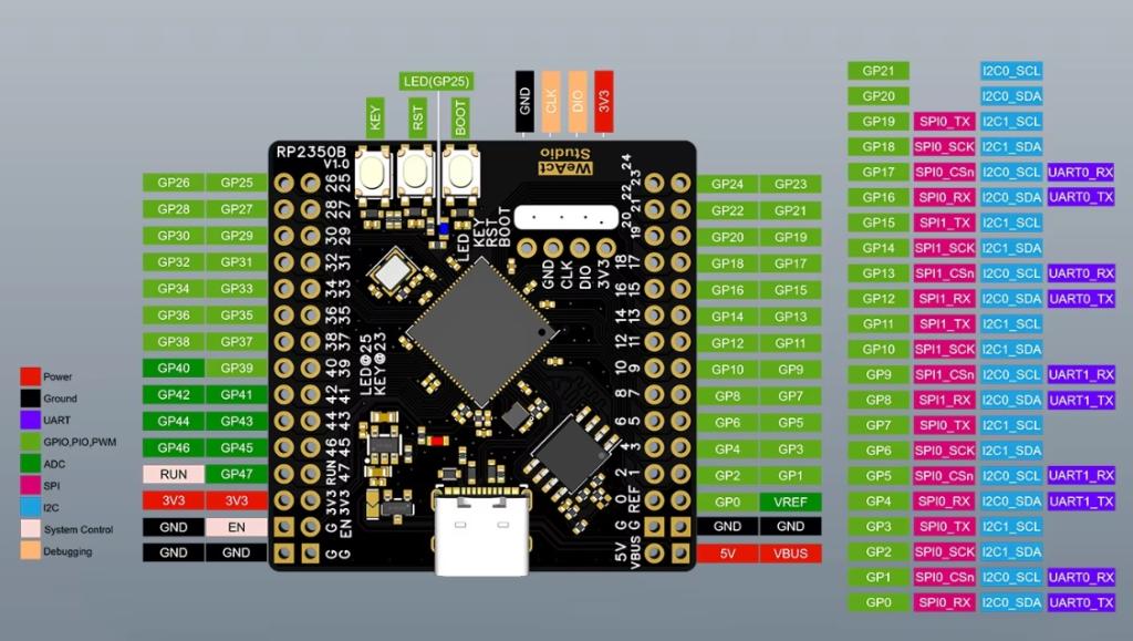

With the USB connector down, the right 2 rows of pins effectively replicate the Pico 1 pins, with their respective functions.

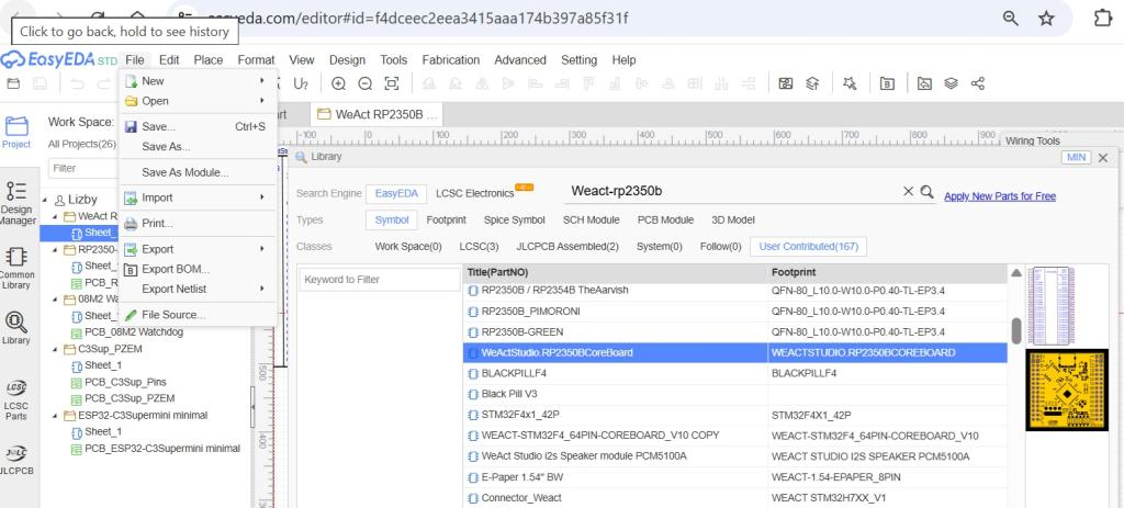

The EasyCad footprint is available in the Standard (not Pro) version under "User Contributed" as WeActStudio.RP2350BCoreBoard (I couldn't find it under Pro):
In EasyCAD:

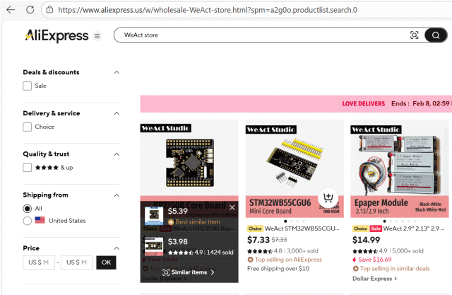

It's weird. This takes me to where the module is one of many:
https://www.aliexpress.us/w/wholesale-WeAct-RP2350B-.html
When I click on it, it takes me to a "Dollar Express" page on which it is also one item of many.
When I click on that, I can order the module (but I never get to a page on which I can see specifications).
I've ordered 3 of them.

This gets me to the store, and the module is there, but clicking on it still takes me to a "Dollar Express" page where I can click on the module and order, but not a typical Aliexpress item page:
https://www.aliexpress.us/w/wholesale-WeAct-store.html
It does make me wonder if this is a module which will continue to be produced.
Edited 2026-02-06 00:17 by lizby

  Mixtel90 said  I'm getting a "Love Delivers" page, not a WeAct page. It lists several WeAct items but they are all STM32, CANFD, Mini Debugger and ESP32. Not much WeAct and no WeAct RP stuff at all.
Yes, the page I get is "Love Delivers", but the RP2350 is the upper leftmost item:
If I click on that, I get the "Dollar Express" page which also has the module (among others), and if I click on that, I can order it.

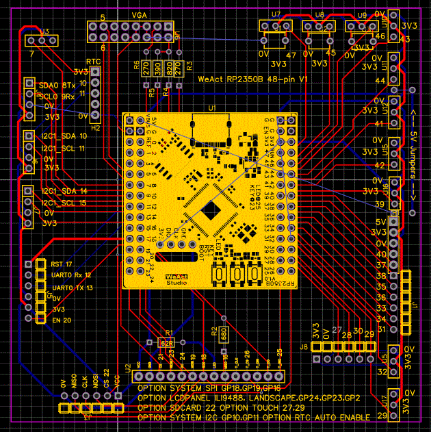

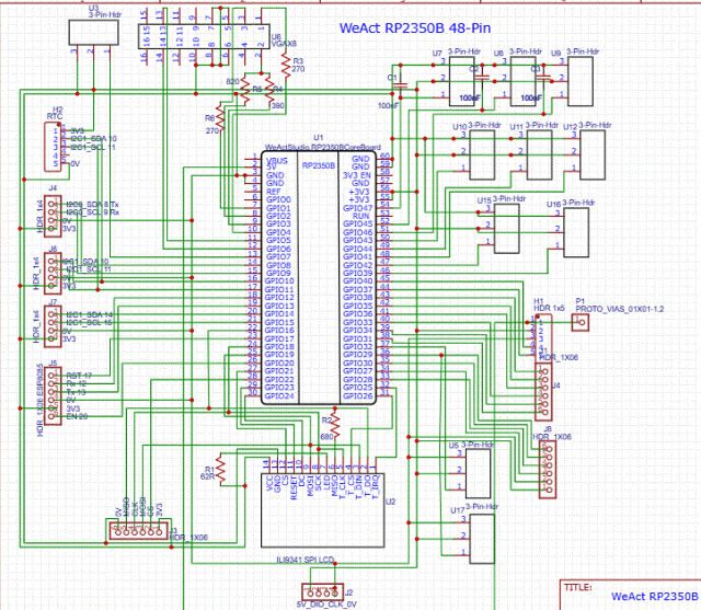

(Mick--while you're here, what do you think would be the best way to break out the 8 analog pins on a 99mm x 99mm PCB? Single with 3V3 & 0V, or grouped somehow?)

You are ok just bringing the ADC signals straight out. Try to keep them away from noise such as the 5V rail and video signals if you can. If you can't then try to cross them at right angles on the other side of the pcb. I like to run a direct GND from the closest connection on the module with them so that you aren't sharing an ADC ground with anything else. Note that GP47 is used for PSRAM_CS on some modules by default and you may need to make changes if you want all 8 ADC channels.

Thanks, Mick. I am almost completely ignorant of the uses of ADC except for having occasionally read voltages. Are you suggesting that it would be best to bring the ADC lines out to 2-pin headers--0V and the ADC pin--and no 3V3?

If that's what you want. You can bring out 3V3 too. If you are bringing everything out to a header I'd suggest putting a small cap (say 100nFceramic but anything up to 10uF depending on how long the supply traces are) between 3V3 and GND at the connector itself.
By default the ADC inputs read 0 to 3V3 volts. If you connect a LM4040-3V0 voltage reference between AVREF and GND and use OPTION VCC 3.0 then they will read 0-3V instead. It has the advantage of giving slightly better noise performance at the expense of range.
Another thing you can do is to use a small cap between AVREF and GND. This will also reduce the noise a bit but without changing the range.
I think this applies to the RP2350. It did to the RP2040: Be aware that the ADC inputs don't have the same ESD protection on chip that the digital inputs have. It's not good to run them into electrically noisy environments without, for example, diode clamps to the supply rails. If you want, say, 0-10V or 4-20mA input signals then keep the dividers etc. reasonably close to the ADC end. You are probably fine with pts on a local panel, although in that case I'd filter them with 100nF on each wiper to GND.

I'll do that. I have no specific requirement for ADC, and only wanted to provide possible access without any attempt at the highest resolution.

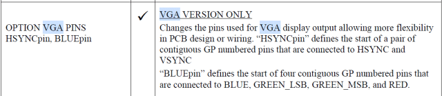

Per the Picomite manual for setting alternate VGA pins:
Would this apply to the upper pins of this module, e.g., GP27, 28, 29, 30 for blue, green1, green2, and red?

I think I might have tried it at some point. It will probably work. AFAIK there's nothing special about the VGA pins apart from the fact that they have to be consecutive. There's no special internal hardware like there is for DVI/HDMI.
