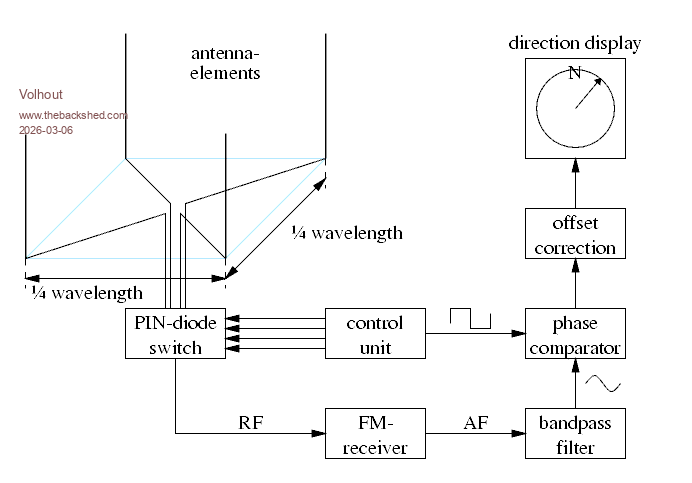

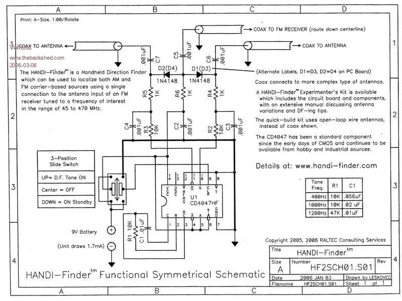

A yagi antenna is a nice tool to find direction, but there is a simpler way to locate a source. This method is used professionally as well.
Take 2 antenna's (standard whip) and mount these at 1/2 lambda distance. Use below circuit to connect the 2 to one radio receiver. Put the radio receiver on the desired frequency and FM demodulation.
When the source is perpendicular to the axis on the 2 antenna's, there is no audio tone from the radio. When it is in line with the axis on the 2 antenna's the sound from the radio is loud.
The system has makes no difference between forward, and backward attenuation, so you always need 2 measurements to do a cross-pole. The "dip" in sound when perpendicular is very sharp, so your cross-pole measurement is very accurate. This works better than a yagi. It is used a lot in amateur radio "fox hunting".
But you need 2 (whip) antenna's and a FM radio (i.e. scanner) for the desired frequency.
Look here...
https://www.handi-finder.com/
This is the professional application.. (i.e. Rohde&Schwarz). You do not need to "rotate" the antenna. It is fixed.
Example of use of such a system at airports.
Edited 2026-03-06 19:57 by Volhout

Posted: 09:56am 06 Mar 2026
I would say this is the good old Adcock locator, just no moving parts. You get a phase shift whenever the antenna position is switched to/from the signal source. This phase shift gives the direction relative to the antenna square. Or am I completely wrong?
73 de OE1HGA, Gerald
Posts: 6231
Posted: 10:01am 06 Mar 2026
Yes, the phase shift of the RF between 2 antenna pairs (or antenna's if 2) is demodulated in the FM demod of the radio.
And as mentioned in the handi-finder data: it does not work with "noise", only with carriers.
