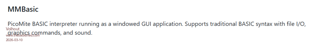

Posts: 6231
Posted: 09:33am 10 Mar 2026
bfwolf,
Interesting to see how they stripped MMBasic. To make MMbasic run in a window, all graphics must be re-done. A huge task if you ask me.

Posts: 6231
Posted: 09:51am 10 Mar 2026
Nope....
from here
Edited 2026-03-10 19:52 by Volhout
