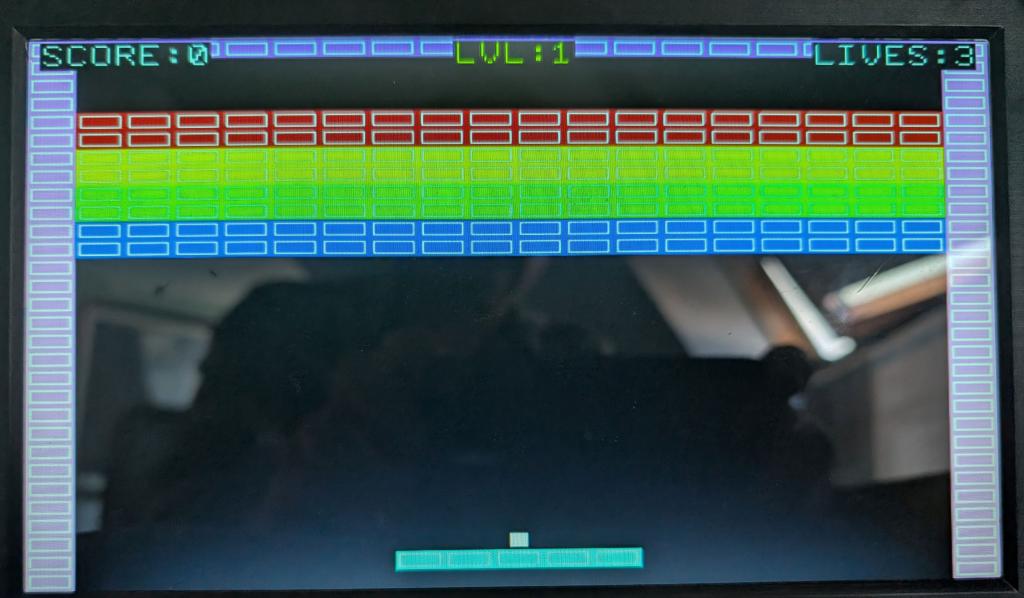

For RP2350 VGA or HDMI.
You need to use a local keyboard and set the keyboard repeat as low as possible.
This game was  written by CLAUDE 4.6 and took 10 minutes to write with 5 iterations to remove syntax and logical errors.
The obvious update would be to support a gamepad or wii controller - should also be easy enough to port to the Game*Mite and use the buttons.
Not thoroughly tested as I'm crap at games.
' BREAKOUT - A Tilemap-Based Brick Breaker
' Uses TILEMAP for the brick field and
' TILEMAP sprites for the ball and paddle.
' Procedurally generates tileset BMP.
' Controls: Left/Right arrows to move paddle
'           Space to launch ball
'           Q to quit
' Requires: MODE 2 (320x240 RGB121), SD card

' Setup
PRINT "Generating tileset..."
GenerateTileset
FLASH LOAD IMAGE 1, "breakout_tiles.bmp", O
FRAMEBUFFER CREATE

 CLS C_BLACK
 ' Tile 1: Red brick
 tx = 0 : ty = 0
 Box tx, ty, TW, TH, 0, C_RED, C_RED
 Box tx+1, ty+1, TW-2, TH-2, 1, C_WHITE
 ' Tile 2: Yellow brick
 tx = TW : ty = 0
 Box tx, ty, TW, TH, 0, C_YELLOW, C_YELLOW
 ' Tile 3: Green brick
 tx = TW * 2 : ty = 0
 Box tx, ty, TW, TH, 0, C_GREEN, C_GREEN
 ' Tile 4: Blue brick
 tx = TW * 3 : ty = 0
 Box tx, ty, TW, TH, 0, C_BLUE, C_BLUE
 ' Tile 5: Wall (grey border)
 tx = TW * 4 : ty = 0
 Box tx, ty, TW, TH, 0, C_GREY, C_GREY
 ' Tile 6: Ball (white square on black)
 tx = TW * 5 : ty = 0
 Box tx, ty, TW, TH, 0, C_BLACK, C_BLACK
 Box tx+TW\2-3, ty+TH\2-3, 6, 6, 0, C_WHITE, C_WHITE
 ' Tile 7: Paddle segment (cyan)
 tx = TW * 6 : ty = 0
 Box tx, ty, TW, TH, 0, C_CYAN, C_CYAN
 ' Tile 8: Paddle left (same as paddle for now)
 tx = TW * 7 : ty = 0
 Save IMAGE "breakout_tiles.bmp", 0, 0, TPR * TW, TH
End Sub

Posts: 6231
Posted: 12:02pm 12 Mar 2026
Peter,
Error in line 126, cannot change a constant.
Posts: 12112
Posted: 12:09pm 12 Mar 2026
Change line 84 to dim float, sorry pasted the wrong version
I got 1286. Level 3 get quite fast
Edited 2026-03-12 22:26 by matherp
Posts: 6231
Posted: 01:06pm 12 Mar 2026
Peter,
I had to reconstruct some lines, since in above listing they where cut off.
But after that it runs fine.
I may have to look at integration into the GM menu (i.e. at exit RUN "menu.bas" and not END) and such (select is QUIT, START to start a game).
But it is a nice game. Runs smooth.
Finetuning:
- press SPACE to restart....(space??)
- color Grey does not exist in framebuffer land. Shows as pink.
- next version publish as ZIP (no cut off lines).
Edited 2026-03-12 23:13 by Volhout
Posts: 6231
Posted: 07:52pm 12 Mar 2026
Hi Peter,
This is the version you can integrate in Game*Mite 2350 system.
Breakout_GM.zip
P.S. and now the version that can be played on a RP2040 Game*Mite/Pico Gamer... Especially Geoff's pico gamer has a lot of units sold. But they are all RP2040...Legacy kills...
Edited 2026-03-13 05:55 by Volhout
