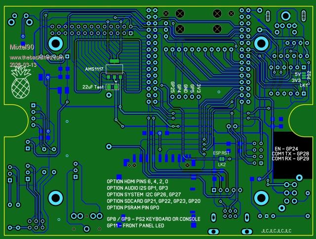

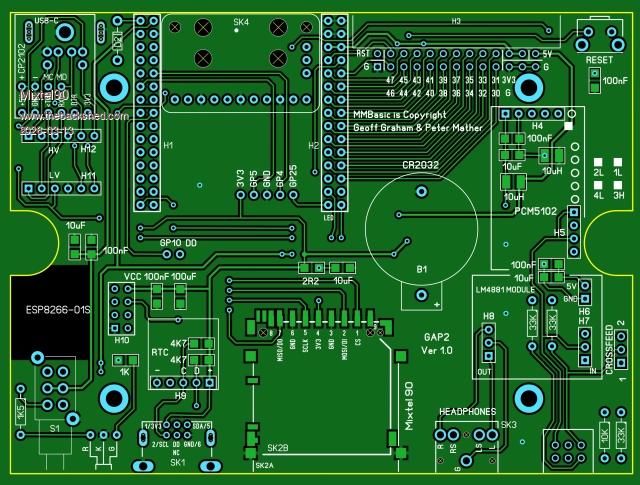

Slight changes and a couple of fixes (sorry lizby!). The manual is enlightening.
Once again, this is a design and it hasn't been built yet - you are more or less on your own. :)
A little HDMI / USB / PS2 machine to use the WeAct Studios module, preferably with a PSRAM soldered onto it. I have one now and it appears to work. :)
I don't think this will be difficult for most people to build if you ignore the PSRAM.
GAP2 construction pack.zip

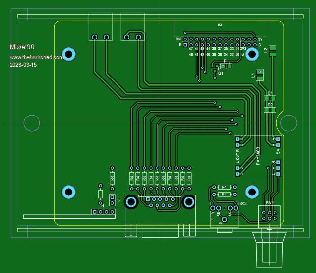

I had a thought. Like you do at 03:30 AM. Why not expand the GAP2? It's got a nice polarised GPIO port that was designed for 26-way ribbon cable and IDC connectors. So a thing came to be thought of - the GAP D-POD.
It's not often that I make one of my designs obsolete before I release the gerbers, but this might replace GAP1.
It has an identical D connector for controllers as GAP1 and also includes a power amp for external speakers, as GAP2 only supports headphones. It doesn't have the pretty LEDs as the case isn't clear, but my idea is to split the front panel and have a translucent section at one end with the LEDs behind that! They will just be driven from a different GPIO, that's all.
Mechanically it's an identical enclosure with a short ribbon cable to link the two. You just stack them up. It's neat because, if you want the GPIO for something else just unplug it. Power is provided from GAP2, of course.
A second idea closely followed the first...
