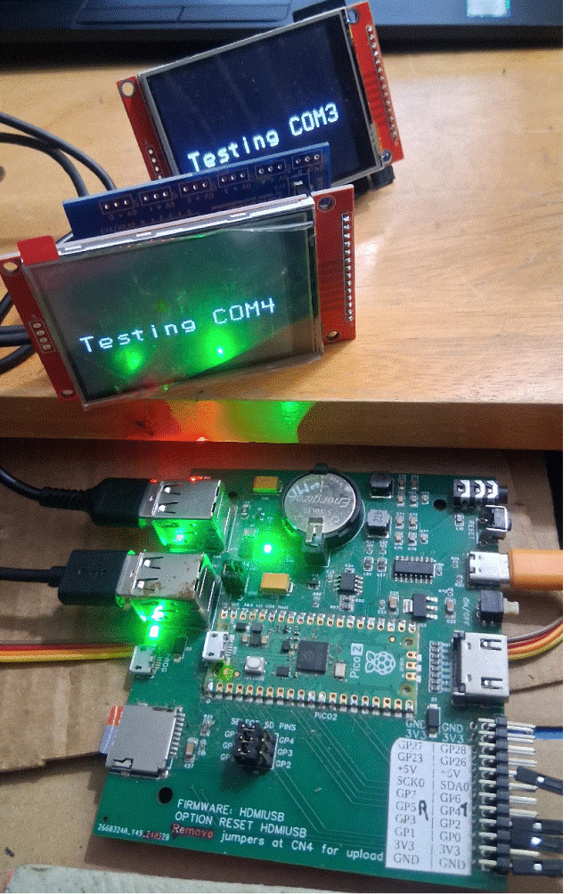

USB versions
Support as host for up to 4 CDC devices allowing a USB PicoMite to connect directly over USB to a non-USB PicoMite
  Quote  # USB CDC Host Serial Ports (COM3–COM6) User Manual
## Overview
USB builds of the PicoMite firmware (PicoMiteUSB, PicoMiteVGAUSB, PicoMiteHDMIUSB, and the RP2350 equivalents) can act as a USB **host** for up to four USB CDC (Communications Device Class) serial devices. These appear in BASIC as **COM3**, **COM4**, **COM5**, and **COM6**.
This allows a PicoMite with a USB host port to communicate with any device that presents a standard USB CDC serial interface — including other PicoMites running non-USB firmware, USB-to-serial adapters, and microcontroller boards with CDC endpoints. Devices may be connected directly or through a USB hub.
COM1 and COM2 continue to use the hardware UARTs. COM3–COM6 are available only on USB builds.
## Requirements
- A **USB build** of PicoMite firmware (any build with `USBKEYBOARD` defined).
- The connected device must present a standard **USB CDC ACM** interface.
- A standard PicoMite (non-USB build) is a CDC device by default and works without any special configuration on the device side.
- The USB device must be plugged in and enumerated **before** the `OPEN` command is issued. TinyUSB typically takes 1–2 seconds after power-on to enumerate a newly connected device.
## Channel and Port Mapping
Each CDC interface discovered by TinyUSB is assigned a fixed index (0–3). The mapping to COM ports and internal channel numbers is:
| COM Port | CDC Index | Channel | Notes |
| COM3 | 0 | 5 | First CDC device enumerated |
| COM4 | 1 | 6 | Second CDC device |
| COM5 | 2 | 7 | Third CDC device |
| COM6 | 3 | 8 | Fourth CDC device |
Channels 1–4 are reserved for USB HID devices (keyboard, mouse, gamepads). CDC channels start at 5 to avoid any conflict.
When a CDC device is connected or disconnected at the command prompt, a message is displayed:
USB CDC Device Connected on channel 5 (COM3)
USB CDC Device Disconnected on channel 5 (COM3)
These messages are suppressed while a program is running.

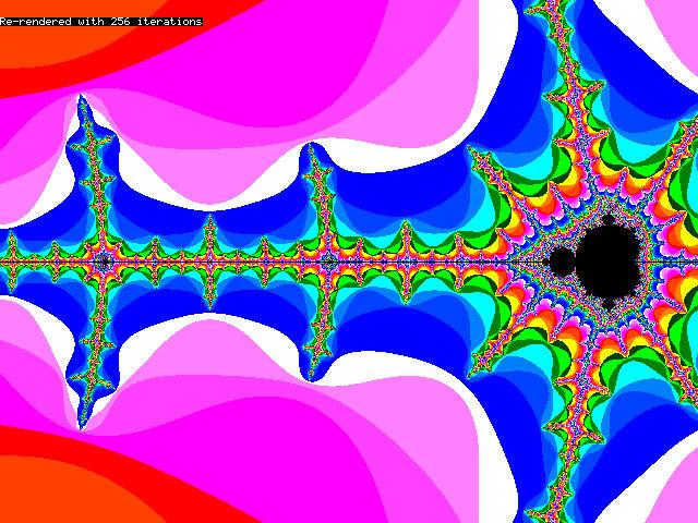

Easter Egg - all versions
' MandelbrotTest.bas
' Demonstrates all features of the MANDELBROT command
' Requires a configured display (SPI LCD, VGA, etc.)
' Press Ctrl-C at any time to abort a draw in progres
s
' Start with a clean slate
MODE 2
CLS
' --- 1. Basic draw (default 64 iterations) ---
Print "Drawing Mandelbrot set (default view)..."
Timer = 0
Mandelbrot Draw
Print "Done in " Str$(Timer) "ms"
Pause 2000
' --- 2. Draw with higher iteration count ---
CLS
Print "Redrawing with 128 iterations..."
Mandelbrot Reset
Timer = 0
Mandelbrot Draw 128
Pause 2000
' --- 3. Bare command (no subcommand, 64 iters) ---
CLS
Print "Bare MANDELBROT command..."
Mandelbrot Reset
Timer = 0
Mandelbrot 64
Pause 2000
' --- 4. Centre on a point of interest ---
'   Re-centre on approx (3/4 width, 1/2 height) - nea
r the
'   boundary of the main cardioid, then zoom in
CLS
Print "Centre on interesting region..."
Mandelbrot Reset
Mandelbrot Draw
Pause 1000
Mandelbrot Centre MM.HRES*3\4, MM.VRES\2
Print "Centred and redrawn"
Pause 2000
' --- 5. Zoom in sequence ---
CLS
Print "Zooming in x2, x2, x2..."
Mandelbrot Reset
Mandelbrot Draw
Pause 1000
Mandelbrot Zoom 2
Print "Zoom x2"
Pause 1000
Mandelbrot Zoom 2
Print "Zoom x4 total"
Pause 1000
' --- 6. Zoom out ---
CLS
Print "Zooming back out..."
Mandelbrot Zoom 0.5
Print "Zoom x2 total (zoomed out x4)"
Pause 2000
' --- 7. Pan around ---
CLS
Print "Panning right 50 pixels..."
Mandelbrot Reset
Mandelbrot Draw
Pause 1000
Mandelbrot Pan 50, 0
Print "Panned right"
Pause 1000
Print "Panning down 30 pixels..."
Mandelbrot Pan 0, 30
Print "Panned down"
Pause 1000
Print "Panning left and up..."
Mandelbrot Pan -80, -30
Print "Panned left+up"
Pause 2000
' --- 8. Combined: centre, zoom, pan workflow ---
CLS
Print "Interactive-style exploration..."
Mandelbrot Reset
Mandelbrot Draw
Pause 1000
' Centre on the seahorse valley (approx left-centre o
f set)
Mandelbrot Centre MM.HRES\4, MM.VRES\2
Pause 1000
' Zoom in deep
Mandelbrot Zoom 4
Pause 1000
Mandelbrot Zoom 4
Pause 1000
Mandelbrot Zoom 2
Pause 1000
Mandelbrot Zoom 2
Print "Deep zoom into seahorse valley"
Pause 2000
' Increase iterations for detail at this depth
Mandelbrot Draw 256
Print "Re-rendered with 256 iterations"
Pause 2000
' --- 9. Reset back to default ---
CLS
Print "Resetting to default view..."
Mandelbrot Reset
Mandelbrot Draw
Print "Back to default"
Pause 2000
CLS
Print "Mandelbrot demo complete!"
End

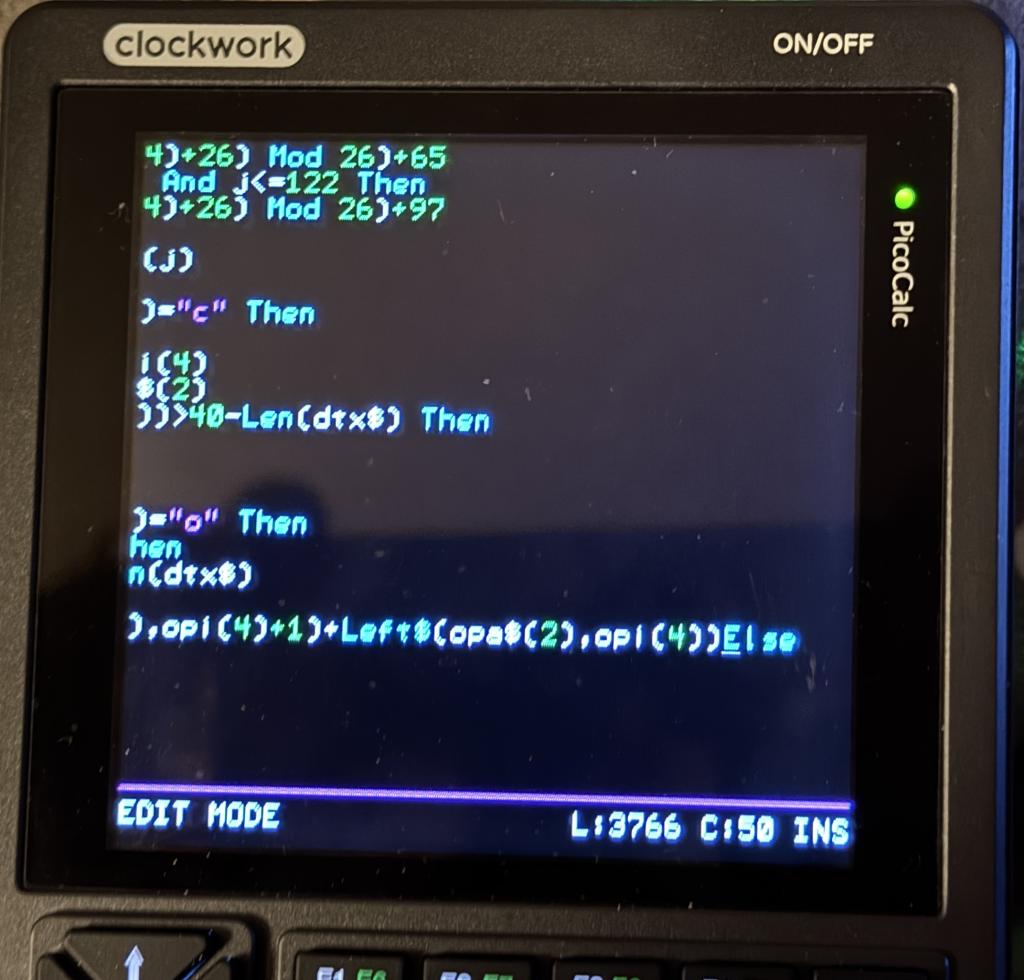

I'm trying the beta. When I exit the editor with Esc, the prompt disappears except for a tiny dot in the upper left corner. Before you blame it on the PicoCalc, the final version of 6.02.01 runs fine.
Here's my OPTION LIST:
PicoMite MMBasic RP2350B V6.02.02B0
OPTION SERIAL CONSOLE COM1,GP0,GP1,BOTH
OPTION LCD SPI GP10,GP11,GP12
OPTION SYSTEM I2C GP6,GP7, SLOW
OPTION BAUDRATE 19200
OPTION FLASH SIZE 16777216
OPTION LIBRARY_FLASH_SIZE  51000
OPTION COLOURCODE ON
OPTION CONTINUATION LINES ON
OPTION CASE UPPER
OPTION TAB 8
OPTION DEFAULT COLOURS GREEN, BLACK
OPTION KEYBOARD PICOCALC
OPTION PICO OFF
OPTION CPUSPEED (KHz) 384000
OPTION LCDPANEL CONSOLE ,, FF00
OPTION DISPLAY 26, 40
OPTION LCDPANEL ST7365P, PORTRAIT,GP14,GP15,GP13
OPTION BACKLIGHT LCD 80
OPTION SDCARD GP17, GP18, GP19, GP16
OPTION RTC AUTO ENABLE
OPTION MODBUFF ENABLE  192
OPTION PLATFORM PicoCalc
OPTION PSRAM PIN GP47
Edited 2026-04-05 09:37 by toml_12953

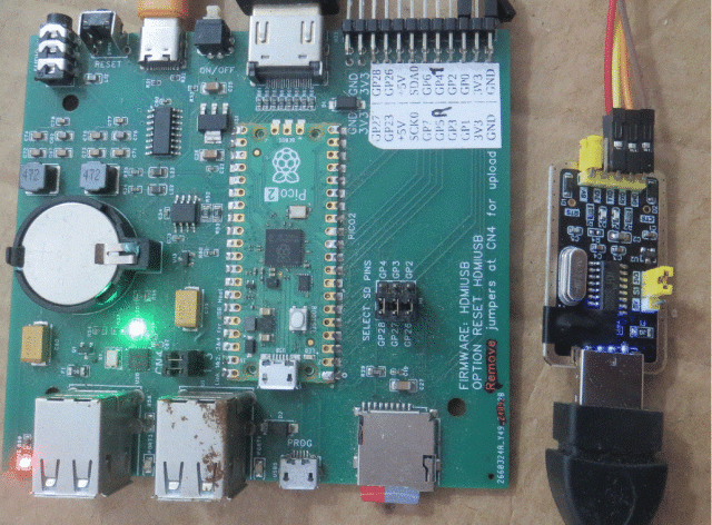

I got it to work with this module (Peter's):
I plugged a RP2350A-Zero pcb with ILI9341 LCD directly into one of the board's USB connectors, got recognition, did OPEN "COM3:9600" as #1 and then PRINT #1, "CLS RGB(BLUE)" and got a blue screen. But the PCB didn't supply enough power to do much more--it would restart.
So now I'm looking for a USB-A to USB-A cable for my powered hub. I'm pretty sure I used one back in December for something.
Found one--right in front of me, connecting to my USB-3 HDMI recorder. But it's not working with the powered hub, which has switchable USB ports. I switch one on, and nothing happens on the host.
I tried another powered hub--no joy. Is this an issue of a hub being plugged into another hub (on the HDMI PCB)?
Ok, I plugged the two into the HDMI PCB. Then:
  Quote  > open "com3:9600" as #1
> open "com4:9600" as #2
> print #1,"Text mm.hres/2,mm.vres/2,"+chr$(34)+"Testing COM3"+chr$(34)+",C,,3"
> print #2,"Text mm.hres/2,mm.vres/2,"+chr$(34)+"Testing COM4"+chr$(34)+",C,,3"
Pretty nifty.  So how do you power locally?
Edited 2026-04-05 11:20 by lizby
Posts: 3422
Posted: 02:00am 05 Apr 2026
  Quote  So how do you power locally?
Perhaps connect VSYS and ⏚ of all 3 Picos together.

One line fix for editor bug for TFT versions - no version change
PicoMiteV6.02.02B0.zip

What versions run the MANDELBROT command? Only the VGA and HDMI versions? The LCD version doesn't seem to understand it.
Posts: 12110
Posted: 04:43pm 05 Apr 2026
  Quote  The LCD version doesn't seem to understand it.
Does for me.
toml_12953
Joined: 13/02/2015
Posts: 740
Posted: 07:42pm 05 Apr 2026
Does for me.
Yup, it does. I don't know what I was donig wrong before. Oh, now I see it in the previous sentence.
