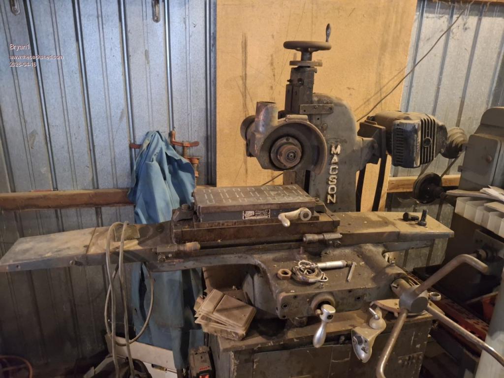

Ok Guy's the whole point of this project is to make a state machine so I can run my old Macson surface grinder.
Now the inherent problem is with the Z axis on this machine where the lead screw has a heap of backlash and when setting the grinding wheel doing 2,000 RPM it tends to jump and I have already broken a grinding wheel trying to use this machine.
This is where a ball screw can come into play for the Z axis so if needed a step by step can set the cut then the DRO on the screen can be set to zero where the predetermined cut is done.
I do have a 2 pole 3 phase motor for this project and a Delta VFD so the motor can run off single phase and the best part the Delta VFD does have a serial interface where the hertz can be changed so the speed once calibrated can be dialed in using the G-code.
Now the X axis rack and pinion drive and as it's only going back and forth I can machine the stepper mount off the original handle and fabricate up the securing mount for the stepper motor.
The Y axis in operation is going to increment in steps every forward pass depending on the width of the grinding wheel.

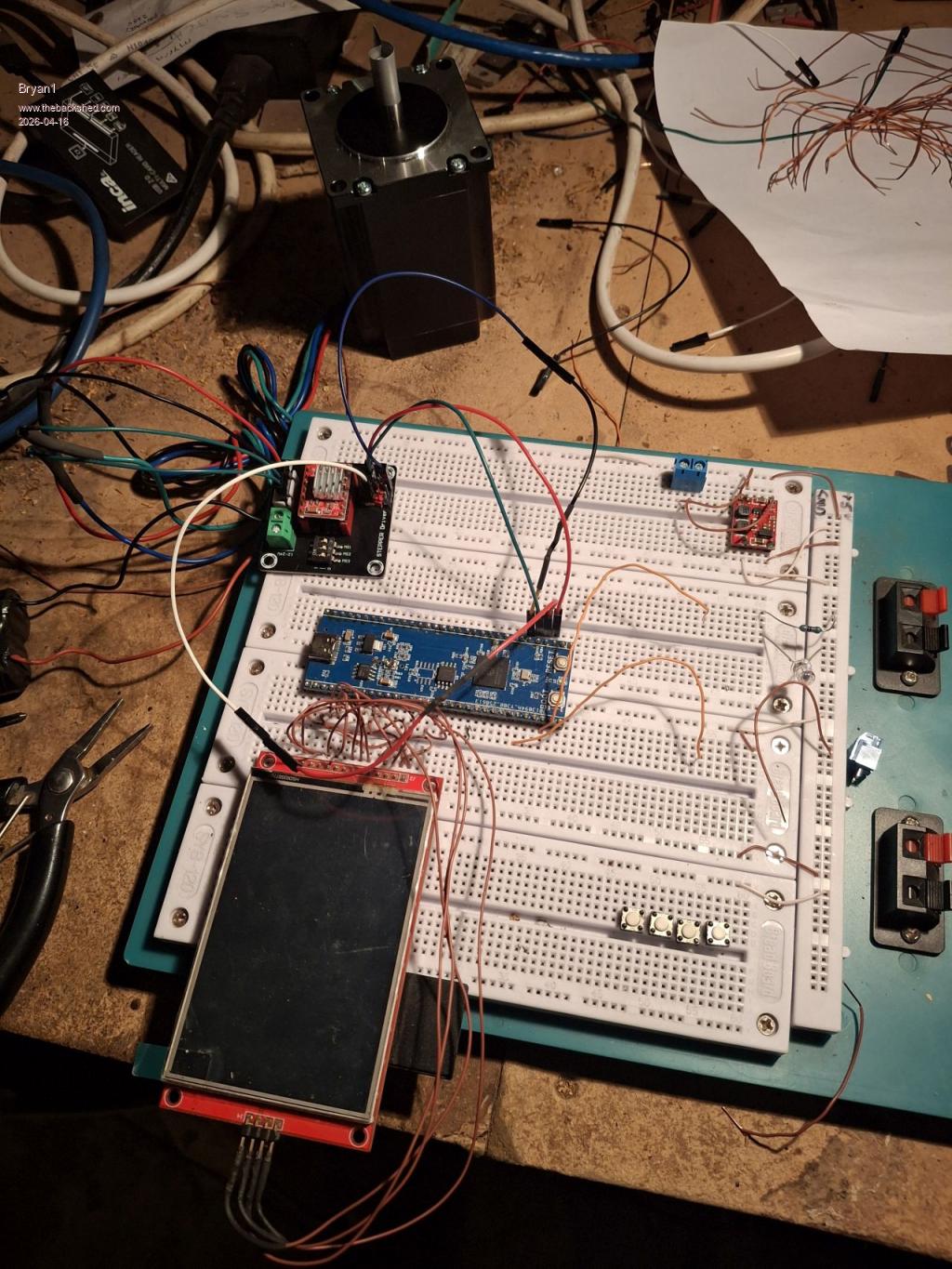

Now here is a pic of my test setup
For now the 3.5" touch screen can do while the code is built up and as there are so many spare pins I do think a 9" touchscreen in 16 bit mode as reading in the manual today 16 bit can be done. I do need to order more dupoint cables for this project so no rush as I have been thinking about this project for a long time.
Regards Bryan

Yeah that backlash needs fixed. No fun busting a grinding wheel

There is a version of that surface grinder in the shed here, we fitted a pneumatic cylinder under the grinder spindle head that takes the weight and backlash out of the leadscrew, a cheap regulator sets the pressure accordingly. Works so much better now
Good luck.
Lyle.

As this surface grinder is fully manual my idea of automating it does make sense so the grinder is more efficient.
Now going a damper on the Z axis could work but I already have a ball screw that is suitable to fit. I got this off an old Hercus cnc lathe and length wise it will fit easily.
