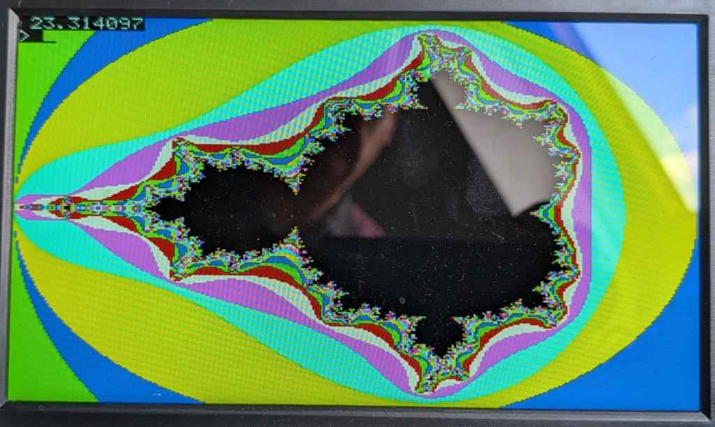

For some programs....
I've been playing (together with my mate) looking at every avenue possible to speed up MMbasic and the answer is there is very little sensible left to do unless...
What is the most used statement in most programs - answer LET
I wonder if we could cache LET statments so that there was no variable lookup except the first time in and no recursive parsing - sort of compile them on the fly.
and it works
Here is a test program
Option BASE 0
Dim col(7)
col(0)=RGB(0,0,0)      ' Black
col(1)=RGB(255,0,0)    ' Red
col(2)=RGB(0,255,0)    ' Green
col(3)=RGB(0,0,255)    ' Blue
col(4)=RGB(255,255,0)  ' Yellow
col(5)=RGB(0,255,255)  ' Cyan
col(6)=RGB(255,0,255)  ' Magenta
col(7)=RGB(255,255,255)' White
MODE 2 ' 320x240
Timer =0
xmin = -2.0
xmax = 1.0
ymin = -1.2
ymax = 1.2
maxiter = 32
Dim xp(319),yp(319),cp(319)
For i=0 To 319:xp(i)=i:Next
For py = 0 To 239
 Math set py,yp()
 y0 = ymin + (ymax-ymin)*py/239
 For px = 0 To 319
   x0 = xmin + (xmax-xmin)*px/319
   x = 0
   y = 0
   iter = 0
   Do While x*x + y*y <= 4 And iter < maxiter
     xtemp = x*x - y*y + x0
     y = 2*x*y + y0
     x = xtemp
     iter = iter + 1
   If iter = maxiter Then
     c = 0
   Else
     c = (iter Mod 7) + 1
   EndIf
   cp(px)=col(c)
 Next px
 Pixel xp(),yp(),cp()
 Next py
Print Timer
End
On a HDMIUSB system with OPTION RESOLUTION 640,378000 set this takes 42.4 seconds
However, add the magic line at the top
Option tracecache on
and.....
You can try an experimental version of the code if you want
PicoMite (2).zip
Also you can try adding OPTION PROFILING ON at the top of the program

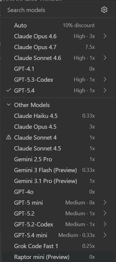

Note: the header text in the c file is completely out-of-date with respect to the current capabilities. This was built in increments using Claude 4.7 - very expensive to use but largely infallible in terms of each step meeting the brief and working first try.

Posts: 3886
Posted: 02:35pm 19 Apr 2026
  matherp said  built in increments using Claude 4.7 - very expensive to use but largely infallible in terms of each step meeting the brief and working first try.
How expensive is "very expensive"? I spent about $5USD a day for 5 days to work out some deep bugs--fairly intensive use, but far from "all day, every day". Expensive for a retired person doing it for recreation, but not for paid development.
Since that stretch I've managed lighter use on the monthly subscription--several times hitting a period limit and then doing other things for several hours until the next period rolled around.
Edited 2026-04-20 00:35 by lizby
Posts: 12110
Posted: 04:06pm 19 Apr 2026
  Quote  How expensive is "very expensive"?
USD26 in a day
Posts: 3886
Posted: 04:17pm 19 Apr 2026
Wow. We should take up a collection for you. As if your time wasn't already of nearly inestimable value. I would be more than happy to contribute to a GoFundMe.
I understand and appreciate your insistence on not getting paid for the MMBasic development you do, but we could at least help to cover actual expenses at this scale.
