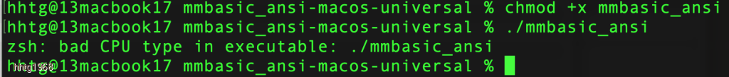

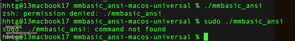

hello. i am not a terminal expert...
or i am to silly.
hhtg1968
Joined: 25/05/2023
Posts: 295
Posted: 06:36am 25 May 2026
perhaps ist not correct to use "sudo" with "./"
i try further...
jvanderberg
Joined: 06/05/2026
Posts: 86
Posted: 12:52pm 25 May 2026
  hhtg1968 said  perhaps ist not correct to use "sudo" with "./"
i try further...
I've updated it to make it executable by default, something got lost in the build.
But you will face another hurdle, the mac really does not want you to run sus software from the internet, so run this after you download:
xattr -dr com.apple.quarantine mmbasic_ansi-macos-universal
chmod +x mmbasic_ansi-macos-universal/mmbasic_ansi
The first line removes the internet quarantine from the directory, the second make double sure the executable is well, executable.
This is now documented in the readme that comes in the zip file.

There was an issue with the build, it should now create a universal binary - I am not at all sure it will run on very old MacOS, but let me know how it goes.
hhtg1968
Joined: 25/05/2023
Posts: 295
Posted: 07:25am 26 May 2026
i have a macbook retine 2017 with macos 13 ventura...

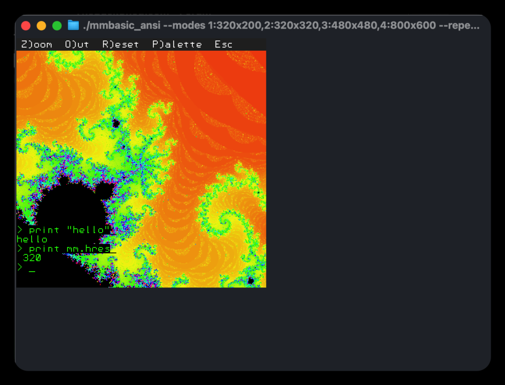

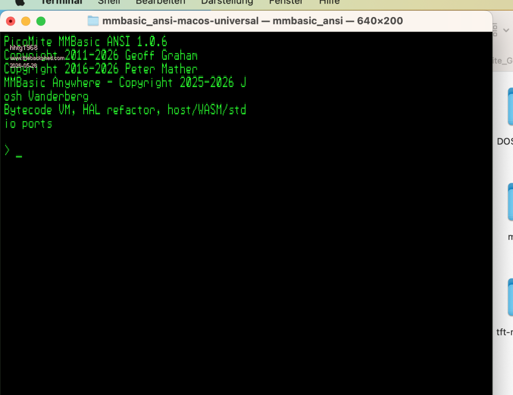

Posted: 07:40am 26 May 2026
first successful tests...
hhtg1968
Joined: 25/05/2023
Posts: 295
Posted: 07:44am 26 May 2026
i will further try to get better resolutions etc.
