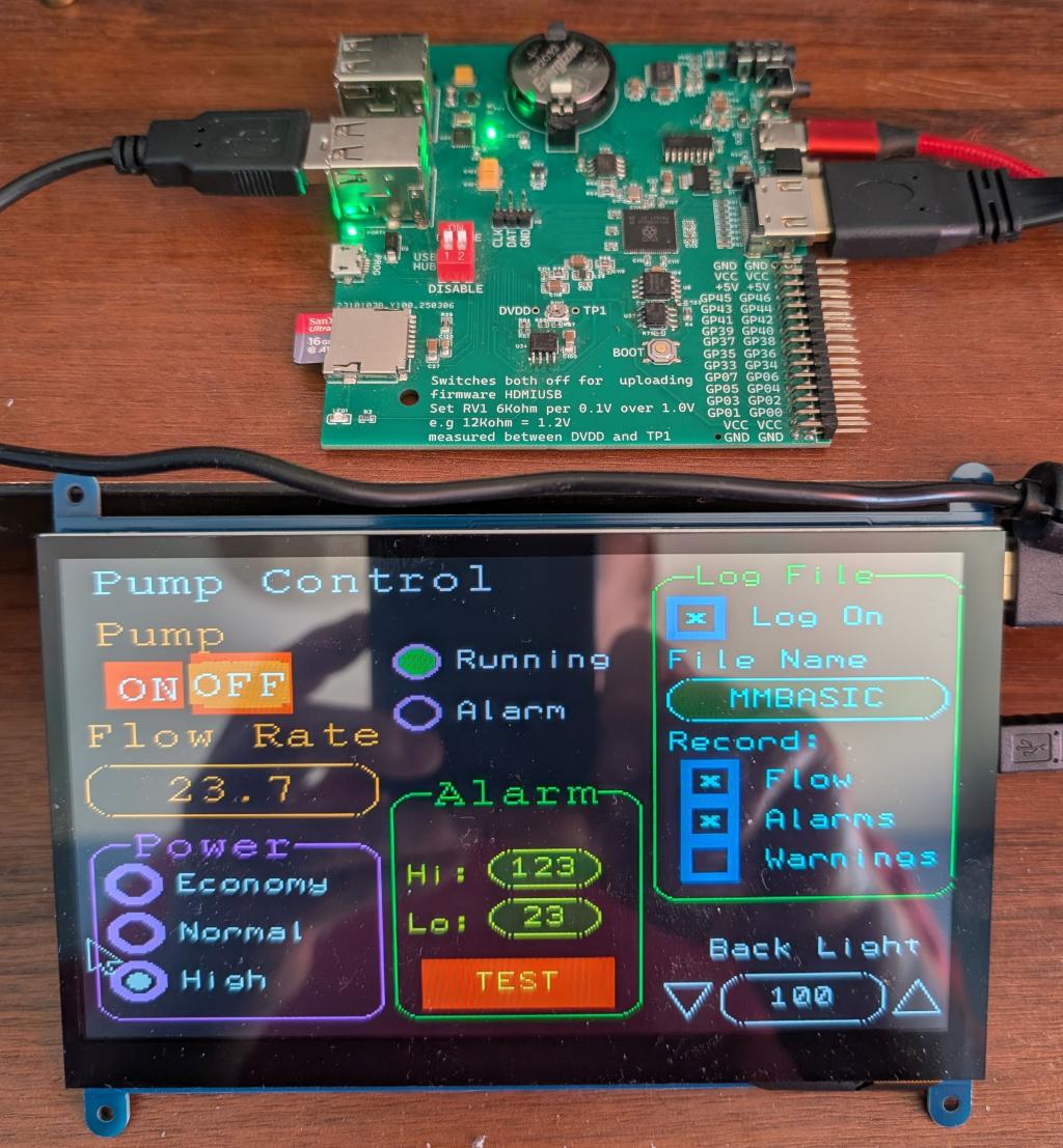

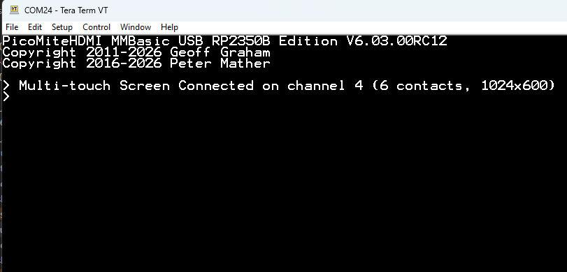

No freaking WAY!
Wait, does this mean that a desktop PC monitor with USB touchscreen will work?
I'm all of a dither...need to grab a coffee
Capacitive

Nice
Posts: 10085
Posted: 05:46am 28 May 2026
Nice one, my son!
Watching this thread with interest.
Was about to start work on a project using the same 2350B board, but was thinking about using a mouse and keyboard.  Touch might be the way to go!

Very nice! Is the 1024x600 resolution supported natively or is the display up-scaling or re-scaling a different resolution?
Posts: 12110
Posted: 04:50pm 28 May 2026
  Quote  Is the 1024x600 resolution supported natively
Yes. OPTION RESOLUTION 1024x600
mode 1 1024x600x1-bit
mode 2 256x150x4-bit
mode 3 512x300x4bit
mode 5 256x150x8bit
That was in 6.02.01 but somehow missed the manual
