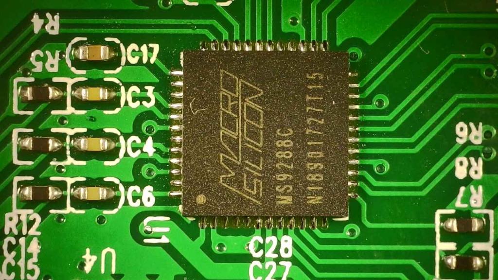

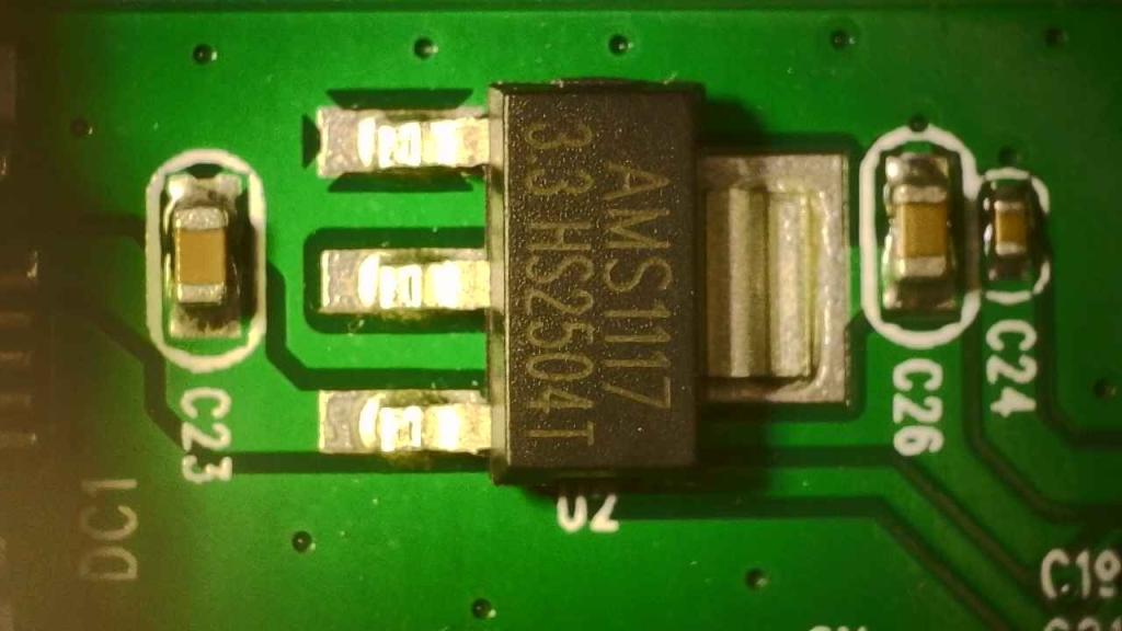

Yes, the converter has a separate input for power via a USB cable. I’ve opened up the converter in the meantime. There is indeed a 3.3V voltage regulator inside that steps down the 5V from the USB power supply, and it is working correctly. The 5V pin on the VGA cable is not being used.
Here are a few photos of the device's internals. You can see the cable pinout, the regulator, and the converter IC.

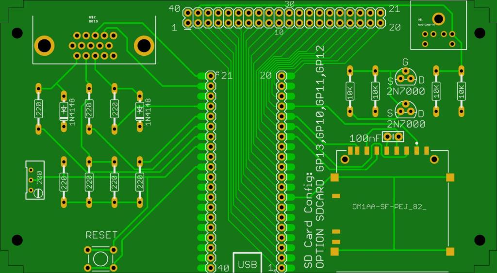

"Does your board supply 5V to pin 9 of the VGA connector?"
No, there is no connection. Neither from VBUS nor from VSYS. It is this board here from the forum:
Best wishes! Joachim

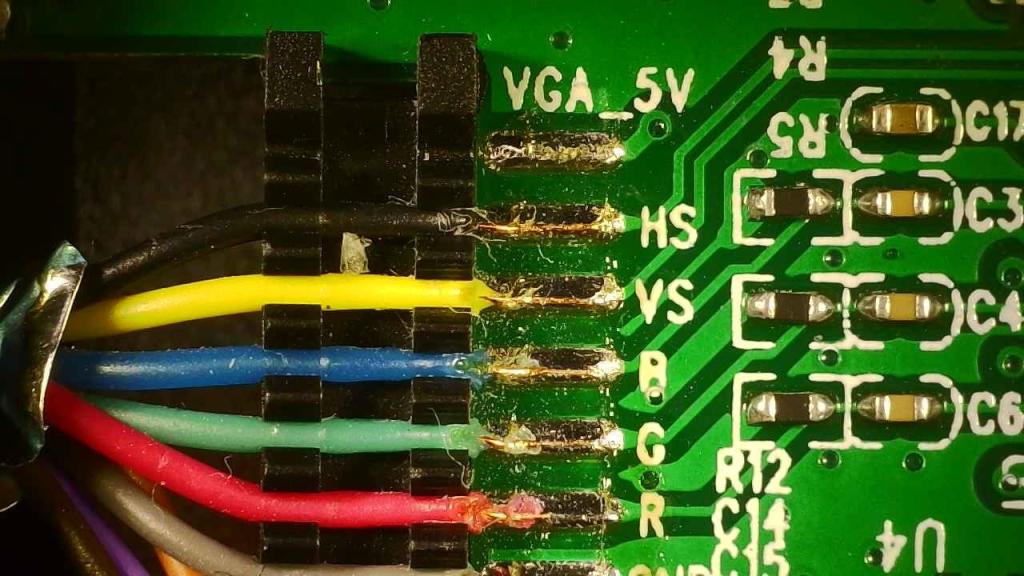

I identified the connections between the VGA port on the Picomite and the converter board. The pins on the VGA port—1 (RED), 2 (GREEN), 3 (BLUE), 6–8 (GND), 13 (HS), and 14 (VS)—match up correctly. According to the schematic, pin 5 on the VGA port is connected to GND; however, there is no connection on the board itself, nor is there a connection to the converter. Pin 10 on the VGA port is connected to the output of the trimmer (200 ohms) but not to the converter.

  Quote  Pin 10 on the VGA port is connected to the output of the trimmer (200 ohms) but not to the converter
They are just ground connections, connected to pin 23 of the Pico, between the sync and colour pins. See the schematic from Geoff's site.
The trimmer adjusts the green so that you see pure white with CLS RGB(white). It makes little difference. The later version uses just 4 resistors, see Video Output in the manual.

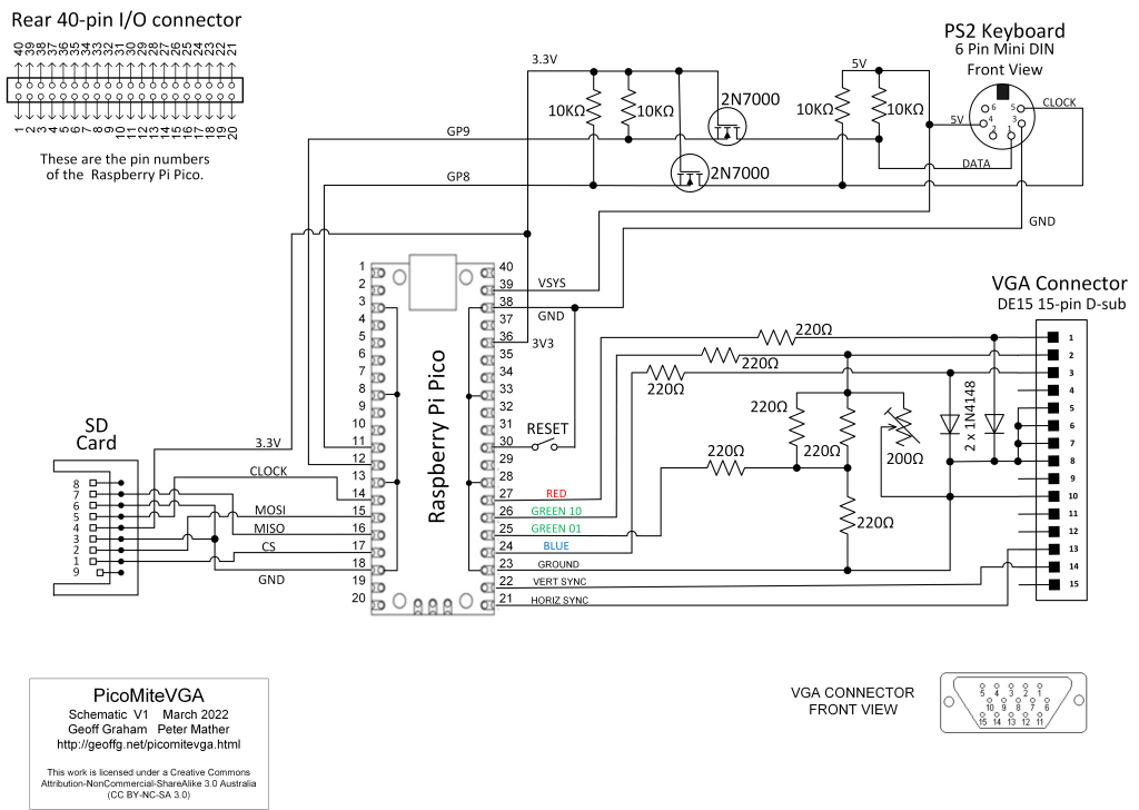

In the Picomite schematic, only one pin is connected to GND (Pin 10).
Your adapter has two GND wires - Is it possible that there's simply a missing GND connection?
Why don't you plug in your adapter and check the GND connections? Maybe there's just a missing GND connection?

Posts: 9288
Posted: 07:34pm 14 Jun 2026
Mine shows 5,6,7 & 8 also connected to GND as well as 10.
Posts: 3422
Posted: 09:51pm 14 Jun 2026
  Quote  Mine shows 5,6,7 & 8 also connected to GND as well as 10
As does the circuit above, Posted: 11:50pm 13 Jun 2026
The two Gnd. wires in the adapter cable most likely go to the Sync. ⏚ (10) and one of the colour ⏚ (6, 7, 8).

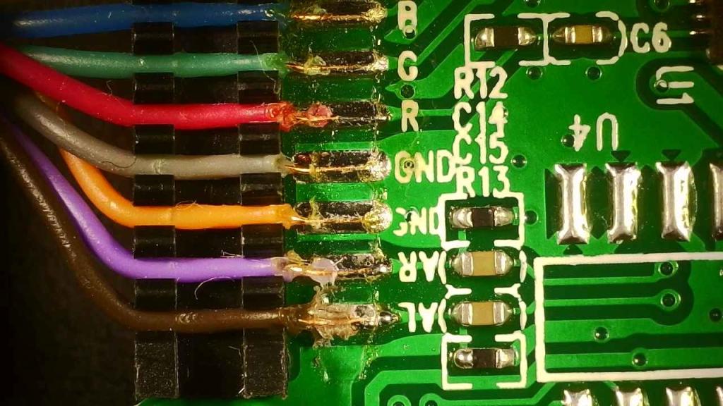

v.lenzer
Joined: 04/05/2024
Posts: 157
Posted: 12:17pm 15 Jun 2026
Hello Frank!
The two GND lines (the gray and orange cables in the picture) are connected to VGA socket pins 6, 7, and 8, as well as to both connector housings—and consequently to pins 10 and 5.
I should mention, though: I thought pin 5 wasn't connected. That turns out to be incorrect. I got the pin numbering wrong because I didn't take into account that the socket is angled. That means the top row on the layout is actually the bottom one :(
