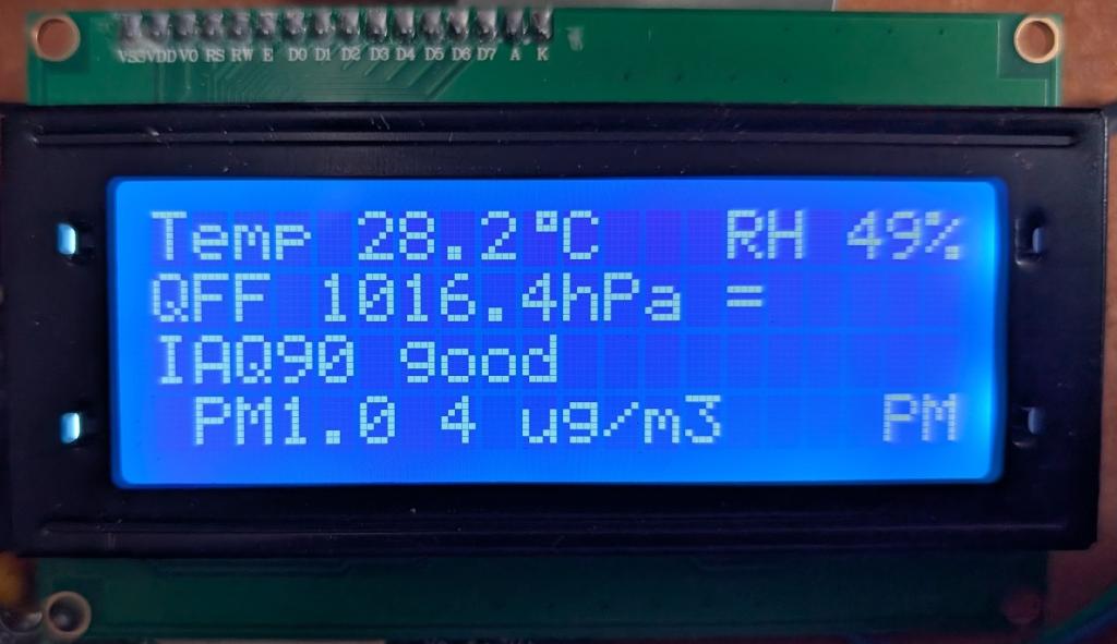

This started off as an exploration of the BME688  and then turned into an air monitor by adding a Plantower PMS5003 particle matter sensor. The particulate information continuously scrolls across the bottom line. The code supports local pressure (QFE), sea level pressure adjusted assuming a standard atmosphere (QNH), and sea level pressure adjusted using the local temperature (QFF). This is configured in lines 31 and 35.
The code should also support the bme680 and bme690 (untested)
' AirMonitor.bas  -  combined air-quality monitor for the PicoMite:
'   * Bosch BME688/BME680  : temperature, pressure, humidity, gas + IAQ score
'   * Plantower PMS5003     : PM1.0 / PM2.5 / PM10 particulates
'   * 20x4 I2C character LCD: live display (PCF8574 backpack at &H27)
' PREREQUISITE (run once at the command prompt, NOT in this program):
'   OPTION SYSTEM I2C sdapin, sclpin
' The BME688 and the LCD both sit on that system I2C bus, so we neither set the
' pins nor open the port here.  The system I2C is on GP14/GP15 = channel 2, so
' the BME688 is accessed with the I2C2 READ/WRITE commands (no OPEN needed) and
' the LCD via I2CLCD, both talking to the system bus directly.
' Wiring
'   BME688 : VCC->3V3  GND->GND  SDA/SCL-> the system I2C pins   (3.3V part!)
'   LCD    : VCC->5V   GND->GND  SDA/SCL-> the same system I2C pins  (addr &H27)
'   PMS5003: VCC->5V(VBUS) GND->GND  TXD->GP1(COM1 RX)  RXD->GP0(COM1 TX)
'            SET->GP2 (high=run)     RST->GP3 (active-low reset)

' Main loop: lines 1-3 are a fixed at-a-glance summary, line 4 scrolls the PM
' readout.  Sensors are read every MEAS_MS; line 4 scrolls on an absolute
' timebase (nextscroll) so its cadence stays even between reads.
DIM INTEGER t0 = TIMER
DIM INTEGER burning = 1, measuring = 0
DIM INTEGER nextmeas = 0, nextpsample = 0, nextscroll = 0, scrollpos = 0
DIM INTEGER secsleft, idx
DIM FLOAT tC, pHPa, slp, rh, gasR, iaq, slowref   ' slp = sea-level pressure (QNH or QFF)
DIM STRING l3, marquee, plabel
marquee = "Starting up...      "
IF USE_QFF THEN plabel = "QFF " ELSE plabel = "QNH "
DO

     ' fixed summary lines (one arrow = moving, two arrows = moving fast)
     LcdLine 1, "Temp " + STR$(tC, 0, 1) + CHR$(0) + "C   RH " + STR$(rh, 0, 0) + "%"
     LcdLine 2, plabel + STR$(slp, 0, 1) + "hPa " + Trend$(slp - slowref)
     LcdLine 3, l3
     ' PM values + per-size particle counts for the scrolling line
     marquee = "PM1.0 " + STR$(pm1) + " ug/m3    "
     marquee = marquee + "PM2.5 " + STR$(pm25) + " ug/m3    "
     marquee = marquee + "PM10 " + STR$(pm10) + " ug/m3    "
     marquee = marquee + "Counts per 0.1L  "

' Arrow(s) for a pressure change 'delta' (hPa over ~3h):
'   below P_STEADY     -> "="   steady
'   P_STEADY..P_FAST   -> one arrow   (rising / falling)
'   >= P_FAST          -> two arrows  (rising / falling fast)
FUNCTION Trend$(delta AS FLOAT)
 IF delta >= P_FAST THEN
   Trend$ = CHR$(CH_UP) + CHR$(CH_UP)
 ELSEIF delta >= P_STEADY THEN
 ELSEIF delta <= -P_FAST THEN
   Trend$ = CHR$(CH_DN) + CHR$(CH_DN)
 ELSEIF delta <= -P_STEADY THEN
 ELSE
   Trend$ = CHR$(CH_EQ)
 ENDIF
END FUNCTION
' PMS5003 serial helpers (non-blocking)
' Parse any complete frames already in the COM1 buffer, keeping the latest.
' Never waits, so the scrolling display stays smooth.
SUB PollPMS
 LOCAL INTEGER c, i, sum, chk
 DO WHILE LOC(#1) >= 32                  ' only start when a full frame is buffered
   c = GetByteNB%()
   IF c = &H42 THEN
     c = GetByteNB%()
     IF c = &H4D THEN
       sum = &H42 + &H4D
       FOR i = 0 TO 29
         c = GetByteNB%()
         IF c < 0 THEN EXIT SUB           ' ran dry mid-frame (rare); bail out
         d(i) = c
         IF i < 28 THEN sum = sum + c
       NEXT i
       chk = (d(28) << 8) OR d(29)
       IF chk = sum THEN
         pm1 = BE16%(d(), 8) : pm25 = BE16%(d(), 10) : pm10 = BE16%(d(), 12)
         c03  = BE16%(d(), 14) : c05  = BE16%(d(), 16) : c10  = BE16%(d(), 18)
         c25  = BE16%(d(), 20) : c50  = BE16%(d(), 22) : c100 = BE16%(d(), 24)
       ENDIF
     ENDIF
   ENDIF
 LOOP
END SUB
' Read one byte from COM1, or -1 if the buffer is empty (no waiting)
FUNCTION GetByteNB%()
 LOCAL STRING s
 s = INPUT$(1, #1)
 IF s = "" THEN GetByteNB% = -1 ELSE GetByteNB% = ASC(s)
END FUNCTION
' Combine two big-endian PMS frame bytes into a 16-bit value
FUNCTION BE16%(d%(), hi%)
 BE16% = (d%(hi%) << 8) OR d%(hi% + 1)
END FUNCTION
' BME688 low-level I2C helpers (system I2C bus - no OPEN needed)
FUNCTION RB%(reg%)
 LOCAL INTEGER b
 I2C2 WRITE ADDR, 1, 1, reg%            ' option 1 = keep the bus (repeated start)
 I2C2 READ ADDR, 0, 1, b
 RB% = b
END FUNCTION
SUB WB(reg%, val%)
 I2C2 WRITE ADDR, 0, 2, reg%, val%
END SUB
FUNCTION S8(v%) AS FLOAT
 IF v% > 127 THEN S8 = v% - 256 ELSE S8 = v%
END FUNCTION
FUNCTION S16(v%) AS FLOAT
 IF v% > 32767 THEN S16 = v% - 65536 ELSE S16 = v%
END FUNCTION
' BME688 calibration, measurement and compensation
SUB ReadCalibration
 par_t1  = (RB%(&HEA) << 8) OR RB%(&HE9)
 par_t2  = S16((RB%(&H8B) << 8) OR RB%(&H8A))
 par_t3  = S8(RB%(&H8C))
 par_p1  = (RB%(&H8F) << 8) OR RB%(&H8E)
 par_p2  = S16((RB%(&H91) << 8) OR RB%(&H90))
 par_p3  = S8(RB%(&H92))
 par_p4  = S16((RB%(&H95) << 8) OR RB%(&H94))
 par_p5  = S16((RB%(&H97) << 8) OR RB%(&H96))
 par_p6  = S8(RB%(&H99))
 par_p7  = S8(RB%(&H98))
 par_p8  = S16((RB%(&H9D) << 8) OR RB%(&H9C))
 par_p9  = S16((RB%(&H9F) << 8) OR RB%(&H9E))
 par_p10 = RB%(&HA0)
 par_h1  = (RB%(&HE3) << 4) OR (RB%(&HE2) AND &H0F)
 par_h2  = (RB%(&HE1) << 4) OR (RB%(&HE2) >> 4)
 par_h3  = S8(RB%(&HE4))
 par_h4  = S8(RB%(&HE5))
 par_h5  = S8(RB%(&HE6))
 par_h6  = RB%(&HE7)
 par_h7  = S8(RB%(&HE8))
 par_gh1 = S8(RB%(&HED))
 par_gh2 = S16((RB%(&HEC) << 8) OR RB%(&HEB))
 par_gh3 = S8(RB%(&HEE))
 res_heat_range = (RB%(&H02) AND &H30) >> 4
 res_heat_val   = S8(RB%(&H00))
 range_sw_err   = S8(RB%(&H04) AND &HF0) / 16.0
END SUB
' Start one forced-mode measurement and return immediately (non-blocking).
' The main loop polls status reg 0x1D bit7 (new_data) and reads the result
' when it is set, so the ~150ms conversion does not stall the scroll.
SUB TriggerMeasure
 WB(&H72, &H01)                         ' ctrl_hum: osrs_h = 1
 WB(&H5A, ResHeat(300, amb_temp))       ' res_heat_0 (target 300C)
 WB(&H64, &H65)                         ' gas_wait_0: ~148 ms
 IF variant >= 1 THEN
   WB(&H71, &H20)                       ' run_gas bit 5 (BME688/BME690)
 ELSE
   WB(&H71, &H10)                       ' run_gas bit 4 (BME680)
 ENDIF
 WB(&H70, &H00)                         ' heater on
 WB(&H74, (2 << 5) OR (5 << 2) OR 1)    ' osrs_t x2, osrs_p x16, forced mode -> start
END SUB
FUNCTION ReadTemperature() AS FLOAT
 LOCAL INTEGER raw
 LOCAL FLOAT v1, v2
 raw = (RB%(&H22) << 12) OR (RB%(&H23) << 4) OR (RB%(&H24) >> 4)
 v1 = (raw / 16384.0 - par_t1 / 1024.0) * par_t2
 v2 = ((raw / 131072.0 - par_t1 / 8192.0) * (raw / 131072.0 - par_t1 / 8192.0)) * par_t3 * 16.0
 t_fine = v1 + v2
 amb_temp = t_fine / 5120.0
 ReadTemperature = amb_temp
END FUNCTION
FUNCTION ReadPressure() AS FLOAT
 LOCAL INTEGER raw
 LOCAL FLOAT v1, v2, v3, p
 raw = (RB%(&H1F) << 12) OR (RB%(&H20) << 4) OR (RB%(&H21) >> 4)
 v1 = (t_fine / 2.0) - 64000.0
 v2 = v1 * v1 * (par_p6 / 131072.0)
 v2 = v2 + (v1 * par_p5 * 2.0)
 v2 = (v2 / 4.0) + (par_p4 * 65536.0)
 v1 = (((par_p3 * v1 * v1) / 16384.0) + (par_p2 * v1)) / 524288.0
 v1 = (1.0 + (v1 / 32768.0)) * par_p1
 IF v1 = 0 THEN ReadPressure = 0 : EXIT FUNCTION
 p = 1048576.0 - raw
 p = ((p - (v2 / 4096.0)) * 6250.0) / v1
 v1 = (par_p9 * p * p) / 2147483648.0
 v2 = p * (par_p8 / 32768.0)
 v3 = (p / 256.0) * (p / 256.0) * (p / 256.0) * (par_p10 / 131072.0)
 ReadPressure = p + (v1 + v2 + v3 + (par_p7 * 128.0)) / 16.0
END FUNCTION
FUNCTION ReadHumidity() AS FLOAT
 LOCAL INTEGER raw
 LOCAL FLOAT temp, v1, v2, v3, v4, h
 raw = (RB%(&H25) << 8) OR RB%(&H26)
 v1 = raw - ((par_h1 * 16.0) + ((par_h3 / 2.0) * temp))
 v2 = v1 * ((par_h2 / 262144.0) * (1.0 + ((par_h4 / 16384.0) * temp) + ((par_h5 / 1048576.0) * temp * temp)))
 v3 = par_h6 / 16384.0
 v4 = par_h7 / 2097152.0
 h = v2 + ((v3 + (v4 * temp)) * v2 * v2)
 IF h > 100.0 THEN h = 100.0
 IF h < 0.0 THEN h = 0.0
 ReadHumidity = h
END FUNCTION
' Gas resistance in Ohms.  BME688/BME690 result is at 0x2C/0x2D, BME680 at 0x2A/0x2B.
FUNCTION ReadGas() AS FLOAT
 LOCAL INTEGER raw, rng, msb, lsb
   msb = RB%(&H2C) : lsb = RB%(&H2D)
   raw = (msb << 2) OR (lsb >> 6) : rng = lsb AND &H0F
   ReadGas = GasHigh(raw, rng)
 ELSE
   msb = RB%(&H2A) : lsb = RB%(&H2B)
   ReadGas = GasLow(raw, rng)
 ENDIF
END FUNCTION
FUNCTION GasHigh(raw%, rng%) AS FLOAT
 LOCAL INTEGER v1, v2
 v1 = &H40000 >> rng%
 v2 = 4096 + ((raw% - 512) * 3)
 GasHigh = 1000000.0 * v1 / v2
END FUNCTION
FUNCTION GasLow(raw%, rng%) AS FLOAT
 LOCAL FLOAT var1, var2, var3, grange
 grange = 1 << rng%
 var1 = 1340.0 + (5.0 * range_sw_err)
 var2 = var1 * (1.0 + k1(rng%) / 100.0)
 var3 = 1.0 + (k2(rng%) / 100.0)
 GasLow = 1.0 / (var3 * 0.000000125 * grange * (((raw% - 512.0) / var2) + 1.0))
END FUNCTION
' IAQ score 0-100 (higher = cleaner) from gas resistance and humidity
FUNCTION AirQuality(g AS FLOAT, h AS FLOAT) AS FLOAT
 LOCAL FLOAT hum_offset, hum_score, gas_score
 hum_offset = h - HUM_BASE
 IF hum_offset > 0 THEN
   hum_score = (100.0 - HUM_BASE - hum_offset) / (100.0 - HUM_BASE) * (HUM_WEIGHT * 100.0)
 ELSE
   hum_score = (HUM_BASE + hum_offset) / HUM_BASE * (HUM_WEIGHT * 100.0)
 ENDIF
 IF g < gas_baseline THEN
   gas_score = (g / gas_baseline) * (100.0 - HUM_WEIGHT * 100.0)
 ELSE
   gas_score = 100.0 - HUM_WEIGHT * 100.0
 ENDIF
 AirQuality = hum_score + gas_score
END FUNCTION
FUNCTION AirLabel$(s AS FLOAT)
 IF s >= 90 THEN
   AirLabel$ = "excellent"
 ELSEIF s >= 70 THEN
   AirLabel$ = "good"
 ELSEIF s >= 50 THEN
   AirLabel$ = "fair"
 ELSEIF s >= 30 THEN
   AirLabel$ = "poor"
 ELSE
   AirLabel$ = "bad"
 ENDIF
END FUNCTION
FUNCTION ResHeat(target%, amb%) AS FLOAT
 LOCAL FLOAT t, v1, v2, v3, v4, v5
 t = target%
 IF t > 400 THEN t = 400
 v1 = (par_gh1 / 16.0) + 49.0
 v2 = ((par_gh2 / 32768.0) * 0.0005) + 0.00235
 v3 = par_gh3 / 1024.0
 v4 = v1 * (1.0 + (v2 * t))
 v5 = v4 + (v3 * amb%)
 ResHeat = INT(3.4 * ((v5 * (4.0 / (4.0 + res_heat_range)) * (1.0 / (1.0 + (res_heat_val * 0.002)))) - 25))
END FUNCTION
