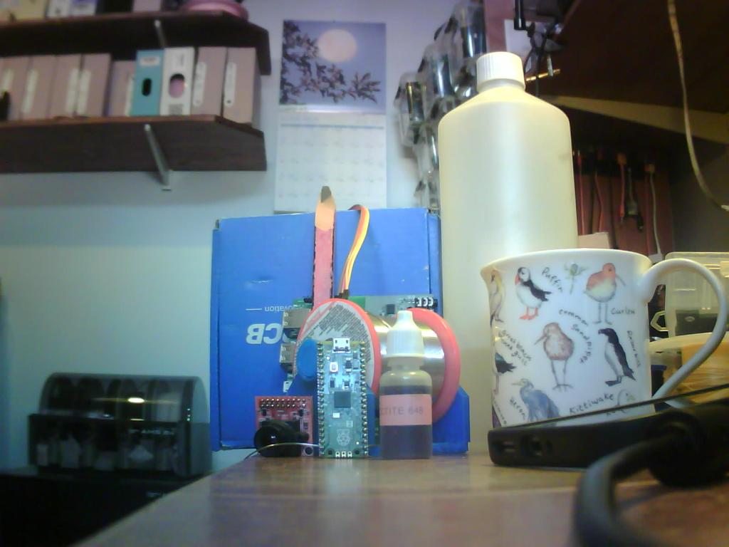

Here is a sample image taken at 1600x1200 using my HDMIUSB reference board to control the camera

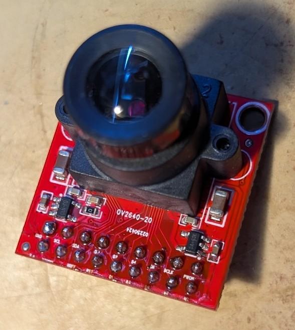

Do you know if these cameras are IR sensitive, Pete?
I only got a definite maybe from AI.

On your picture, it looks like the red color of the camera PCB is being displayed as pink. The blue of the JLCPCB box and the green Raspberry Pico 2 looks correct.

  Quote  Do you know if these cameras are IR sensitive, Pete?
I think they may have an IR filter but if so it is a crap one (tested with a TV remote). I couldn't get good pictures looking outside but, of course, the weather here is very hot, bright and hazy so not a good test.
  Quote  On your picture, it looks like the red colour of the camera PCB is being displayed as pink.
Agreed, there are a gazillion registers you can change on these things to tune the colour but this could also be affected by the IR issue. I'm waiting on some IR filters  to see if that improves things.

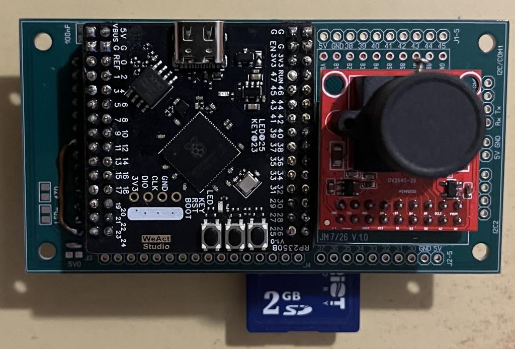

Hi Peter!

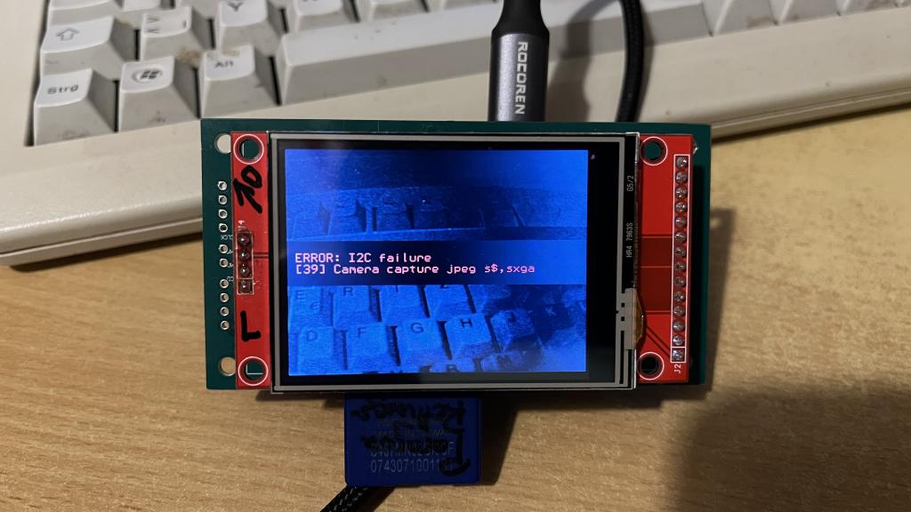

I’ve connected an OV2640 camera to the WeAct board featuring the RP2350B (along with 6MB of PSRAM). I get an image using the commands:
"Camera open ov2640 gp40,gp41,gp42,gp43,gp44,gp30" and
"Camera capture".
So, everything is fine up to that point. Unfortunately, I cannot use the "Camera capture jpeg" command.
Your "Motion Detector" program crashes with the message:
"Camera capture jpeg s$,sxga
Error: I2C failure". Only "Camera" is listed under "List Commands".
Is "Camera capture jpeg" not included in the firmware I flashed onto the RP2350B? Here are my options:

Posts: 12110
Posted: 10:40am 05 Aug 2026
transitioning between modes capture to jpeg for example chucks hundreds of commands at the i2c port. Based on your description i would be suspicious of the i2c wiring. Do you have enough pullup but not too much. How long are the cables to the camera?
As to the image upside down, that makes no sense, the image has to be relative to the camera orientation. If the camera is on an angle the image is on an angle. There are register commands than can flip the image and mirror it but they can't compensate for angles and AFAIK the camera doesn't auto-compensate
v.lenzer
Joined: 04/05/2024
Posts: 157
Posted: 02:07pm 05 Aug 2026
Hi Peter!
Thanks a lot for your quick reply!

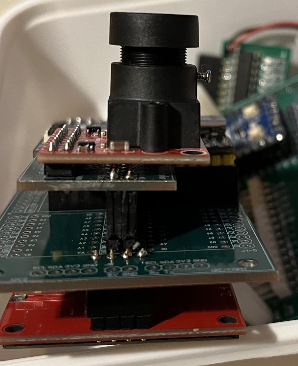

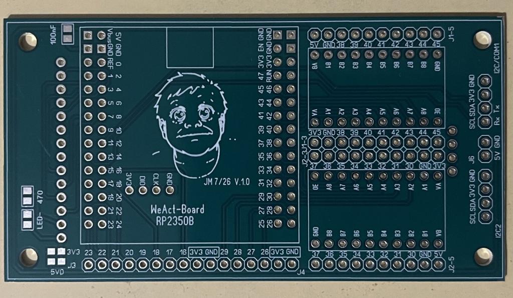

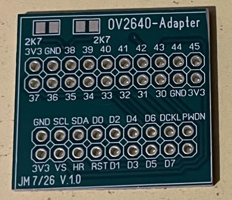

I designed an adapter board to which I solder the camera module, allowing me to plug it directly into the port connectors. This keeps the cable length to a maximum of 2 cm. However, I didn't have any 2.7k SMD resistors on hand and hoped that 4.7k ones would work too. That is obviously the reason. Okay, I'll try using standard resistors until I can get hold of some 2.7k SMD ones. I'll get back to you with photos regarding the image orientation.
Here are a few photos of my WeAct board and the adapter board.
Best wishes! Joachim
v.lenzer
Joined: 04/05/2024
Posts: 157
Posted: 02:49pm 05 Aug 2026
For a quick-and-dirty solution, I soldered two 4.7k resistors in parallel. The pull-up value is now 2.3k ohms. Unfortunately, the same error message appears.

A JPG file named "Movement ...." is created. However, the file is 0 bytes in size.
Or could it be that I configured the I2C interface incorrectly? I entered `OPTION SYSTEM I2C GP38,GP39`. However, GP38/39 correspond to I2C2. Or does that not matter?

v.lenzer
Joined: 04/05/2024
Posts: 157
Posted: 09:28pm 06 Aug 2026
Hi Peter!
The motion detector is working now with these changes. It’s not JPEG quality—just BMP—but it serves its purpose.
