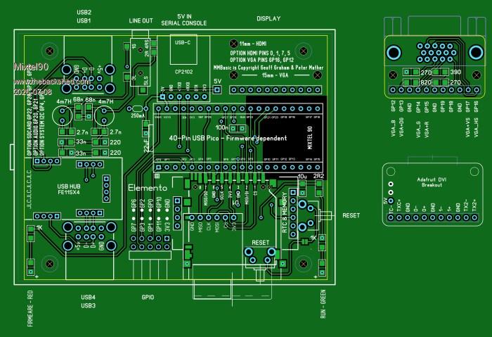

I started this design prior to going out of commission for various reasons (including a stay in hospital). I dug it out again the other day to see if my brain was up to working again (epilepsy leaves me a bit off, sometimes for weeks). Things seem to be ok, even if I'm still suffering from some of the physical problems!
So, Elemento.
The enclosure costs about £1.47 from AE. No screws, just clips together.
AE link
The PCB is my first serious attempt at a 4-layer board.
Designed to be easy to assemble for just about anyone who can solder.
Although there is SMD work there is nothing smaller than 1206. The bits you *will* break while practicing are the two LEDs. lol
Built in 4-port USB hub
Will accept either the Adafruit DVI breakout module for HDMI or a little board for VGA output.
Choice of 2 different full size SD card sockets or a micro SD card module (not SMD).
RTC with CR2032
40-pin Pico socket.
You need a short lead with a "mini" plug to fit your Pico and D+ / D- connecting to the hub. You simply unplug it for installing MMBasic then reconnect it.
Eight uncommitted GPIO pins on the front for the user.
PWM audio. Sorry, but there's not much space and I can't hear stereo anyway!
The clever bits are the changeable display module and the Pico. The 40-pin layout is completely standard so any pin-compatible device can be used. You will probably want to run the USB firmware though as otherwise your only access is the console. In theory it will accept anything from the original Pico to the Pimoroni Picp Plus 2 W and you can upgrade from one to the other. The VGA module is the same footprint as the Adafruit module. Both are intended to be screwed down onto M2.5 tapped spacers to reduce the strain on the connections. Note that you have to fit the display board *after* screwing the PCB down as there is no access to this screw after.
As usual with my designs, the components are generally cheap and cheerful. I'm just starting to check it over so comments welcome.

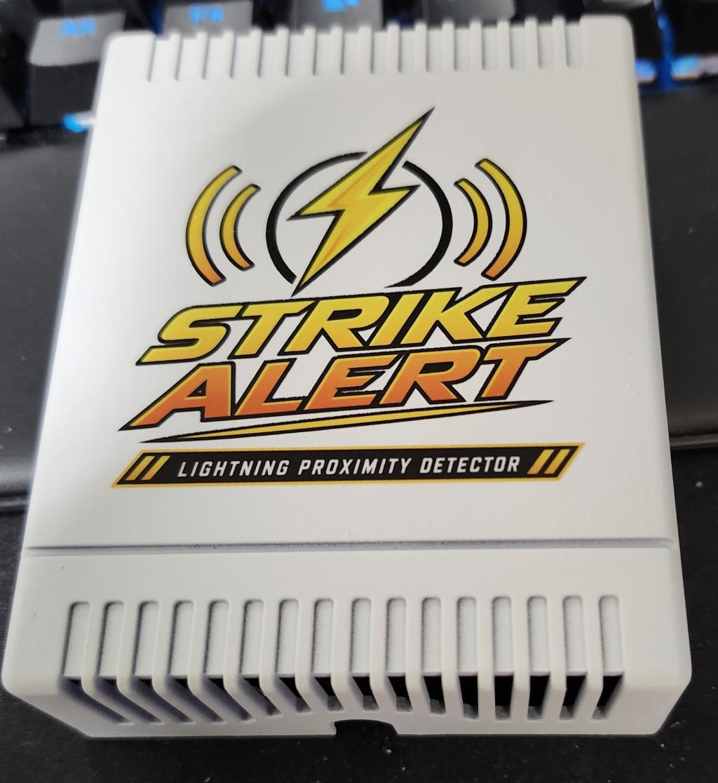

I'm guessing that the cases were intended for something like an active antenna. The outer finish is far nicer than I'd expect for something like a thermostat and the cable entry position is nicely rounded (I tried but I couldn't make use of it!).

Maybe a stupid question, ... why not put the VGA down on the main board. For HDMI, simply do not populate the parts, and stick the adafruit board in.
I checked the housing, and you have to put the board in sideways (the cooling ribs are at the side). How can you put the board in when all holes for the USB/VGA/audio/reset switch stick out on both sides (front/back of the PCB, but sides of the gutter form top of the housing ?
Edited 2026-07-09 16:49 by Volhout
Posts: 9181
Posted: 07:52am 09 Jul 2026
I did consider doing that with the VGA but there is a problem with the PCB fixing screw in that corner. There is no access to it so to get the display connector as tight into the corner as possible it has to plug in. So both the VGA and the Adafruit module are mounted connector-side down, on spacers.
Nothing along the front or the sides of the board projects through the front or sides of the case. Or at least it shouldn't. :) Reset buttons are supposed to be "down a hole and poke it with a stick" type. It should be easy enough to hook the rear components of the PCB into the case then hinge them together.

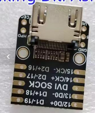

Posts: 3885
Posted: 02:55pm 12 Jul 2026
  Mixtel90 said  I don't know if anyone can use a module that allows a VGA monitor to be connected to the HSTX pins as laid out for the Adafruit DVI breakout
How about the HSTX pins as laid out for the DVI sock?
Might that be useful? (Not specifically for this project, of course.)

It's weird that the AliExpress Box has built-in standoffs, but they are not all the same height.
Posts: 9181
Posted: 09:13pm 19 Jul 2026
I suppose it didn't matter for the intended purpose. :)
I have prototype boards on the way so it'll be playtime soon. The AE case will probably work ok with a bit of careful surgery. I have a couple more on order to practice on. At least I found my bag of #4x6mm screws. :)

Posted: 12:22am 20 Jul 2026
Yeah,  3 of them are around 3.3 mm, and one is 5mm tall.  Weird.
Posts: 3411
Posted: 12:28am 20 Jul 2026
The difference is about the thickness of a PCB, ~1.7mm.
You could make 3 PCB washers to sit on the others instead of grinding the high one down.
Posts: 9181
Posted: 07:10am 20 Jul 2026
If I measure the total thickness, including that of the base, then only one support is lower than 5mm - and that's barely lower. On examining the highest support it's pretty clear that the additional height is the result of poor separation from the mould (it's dished) - the interior finish is a bit rough in general. The remaining two appear to have no particular reason for being what they are.
Until my next examples appear I have no idea if the inconsistencies are the same.

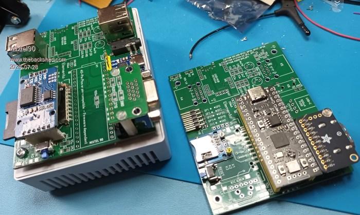

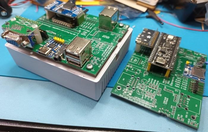

Posted: 11:02am 24 Jul 2026
The extra enclosures appeared this morning (along with the PCBs) so I checked them for fit. The inconsistencies seem to be about the same, although I didn't measure anything.
I leveled up the standoffs by putting three M5 plane washers over them then just shaving the top off with a sharp knife. The plastic is soft so sandpaper will work.
I need to rethink the PCB fixings and allow more play. A clip-together case is very unforgiving and tightening the board fixing screws will easily warp the base to the point where the clips don't work - and that's not far at all. Double checking the *actual* standoff positions and increasing the hole diameters should sort it out, I think.

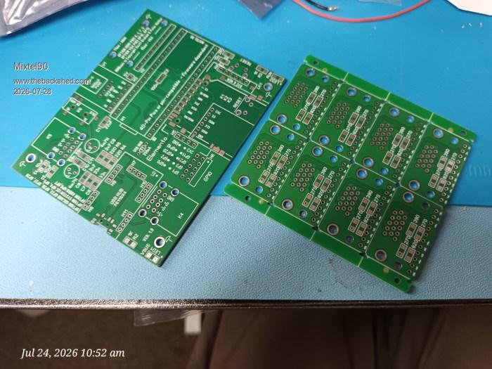

Posts: 9181
Posted: 03:18pm 25 Jul 2026
Oh dear.....
Looks like my first real attempt at 4 layers hasn't worked. There are problems on the new boards that aren't on the design that I did. It's probably something I did wrong somewhere along the way. In the meantime, temporary end of project.  :(
Posts: 9181
Posted: 07:07am 26 Jul 2026
A bit early to give up. :)
Yesterday evening I had another look at the board, made another copy of the file and switched off the internal layers. Then looked at what I could do with what was left. I *think* I've managed to convert it to double-sided without moving any major components. I'm just about at the testing stage now.
The fixing holes now work without deforming the base of the enclosure, simply by opening them up to 3.2mm, which is a more sensible clearance for a #4 screw in a TPH hole anyway.
