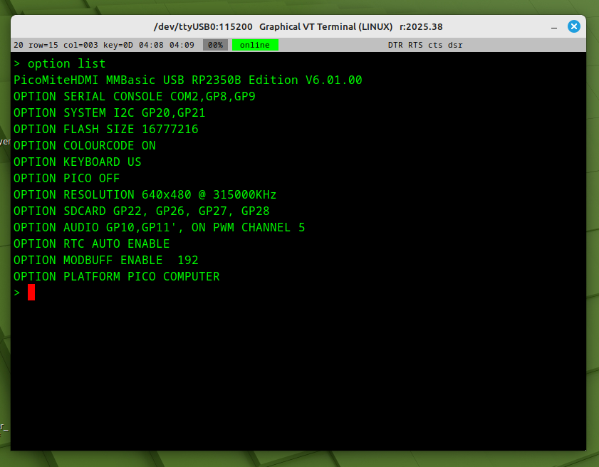

New PM3 all-in-one boards, OPTION RESET PICO COMPUTER 3 command issued at the console, answered Y to the question about "...this will erase everything", waited for it to do its thing, but not getting any HDMI output from the board.
Pressed RESET - no HDMI.
Cycled power - no HDMI.
Console works fine, so I feel I am doing something wrong at my end.
Am I using the most up to date firmware?
Silkscreen says I can use any 2350 FW, but I am wondering if that still means from a certain FW revision number....(and I may not be using it)

I dug out an earlier PICO COMPUTER 2B, and loaded the same FW onto it, and it restarts and the HDMI works fine on it, so I guess I must be doing something wrong with respect to the setup of the new v3 PCB.
My biggest suspect, is that I am not using the latest or correct FW version.
Can someone either link me to the latest version that DOES work with the PM3, or simply post a ZIP file here with the correct uf2 file in it.
Thanks a bunch.

I think you probably need 6.03.00
OPTION RESET PICO COMPUTER 3 possibly looks like it is accepted but probably matches
OPTION RESET PICO COMPUTER in the older firmware.
OPTION RESET LIST should show what is available for the loaded firmware.

D'OH!
Not sure why I did not think of hopping on over to Geoff's site before now.....

OK, have HDMI output now, but no USB devices are detected at all.
USB HUB switch is back in the ENABLE position.
ACTIVE LED starts flickering rapidly after a few minutes - it just gets more and more nuts in terms of the flickering.  2350 chip is cool to the touch, HDMI remains steady.
Perhaps bad SMD around that LED?
I will check.
This is the first board I have programmed out of the set of five, so I will do the others and make a mental note if any of the other boards do it.
USB console has a "> [?7h" prompt, no matter what I type, HDMI output does NOT show this, it just shows the normal "> " prompt - is that normal for this FW?
