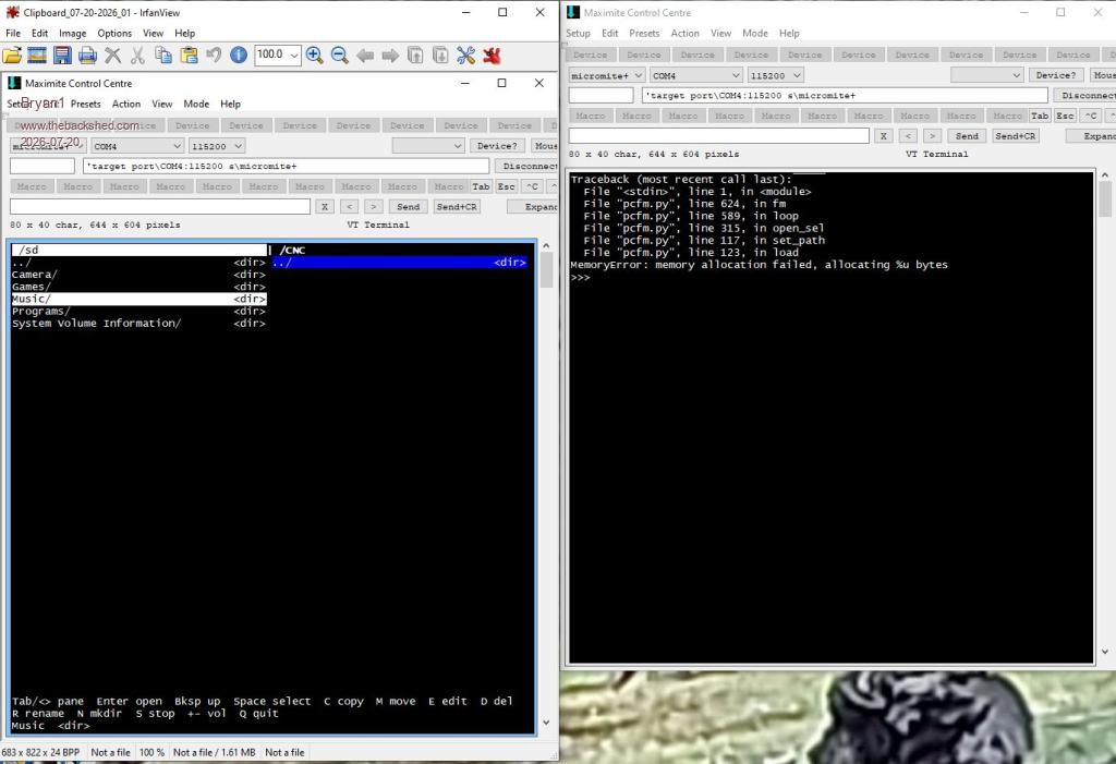

Ok second day going thru the book and went back to the start to refresh and decided as I hadn't tried playing any MP.3's I used fm() to navigate to /sd/Music only to find this....
Did a reboot and still the same, now my Bacoben MP.3 collection in in /SD/Music and the V3 PICO MMBasic it just worked. Now navigating to the other folders on /sd they just open with no problems.

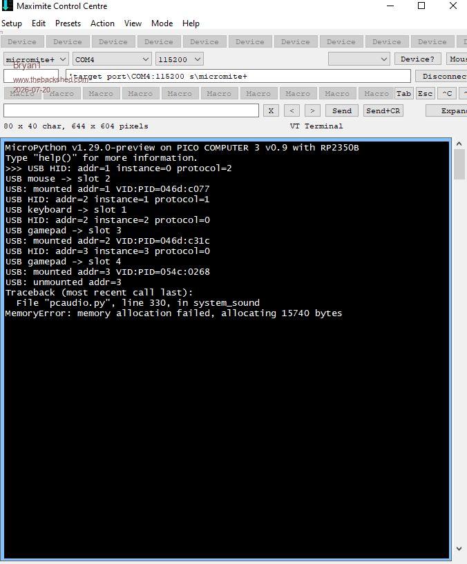

Ok when I did a reboot this morning got the message where a gamepad was on 3 when no game pad was inserted. So put a gamepad on and now got 2 assigned gamepads so took the gamepad off line and this error came up
So getting closer to finding out why the Music folder won't open and trying to edit "pcaudio.py" was empty may need more reading where I thought this would of worked off the bat.

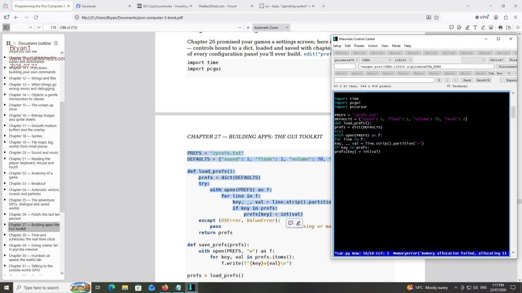

Well what I am finding I copied over the file in fm() from the SDCard and when I edit the file on the SDCard saving the file works yet trying to save the file in flash results in the MemoryError.
Now I did update to the 0.10 version now as I did do a clear 2350.uf after I loaded the new firmware all the files I made were still there.
Also teraterm is acting the same where mpremote and xsend refuse to work
Posts: 12110
Posted: 06:59am 22 Jul 2026
Have you got a PSRAM chip fitted AND working? Micropython for the PC3 won't run without one. Load MMbasic and check the PSRAM is seen

Posted: 07:14am 22 Jul 2026
Peter so is the psram U33 is the second IC down from 2350B chip? if so no JLCPCB didn't fit it along with the wifi chip.
I still need to find the part numbers for them so I can buy some and fit them.
Edited 2026-07-22 17:20 by Bryan1
Posts: 12110
Posted: 07:21am 22 Jul 2026
APS6404L-3SQR-SN - lots available on mouser etc.
I'm amazed Micropython even starts without that fitted
