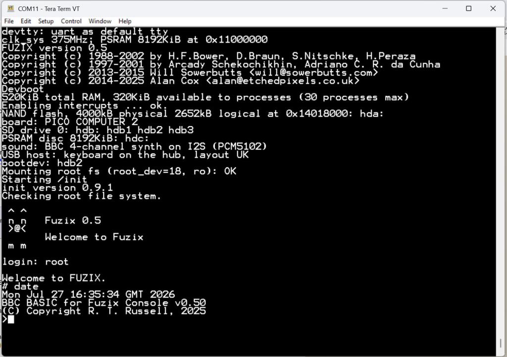

Here is the first release. Will run on the Pico Computer 3 or the Pico Computer 2 (HDMIUSBI2S)
fuzix.zip
FUZIX-PC3-MANUAL.pdf
Full blown Unix V7 on your rp2350 with lots of apps including BBC Basic
