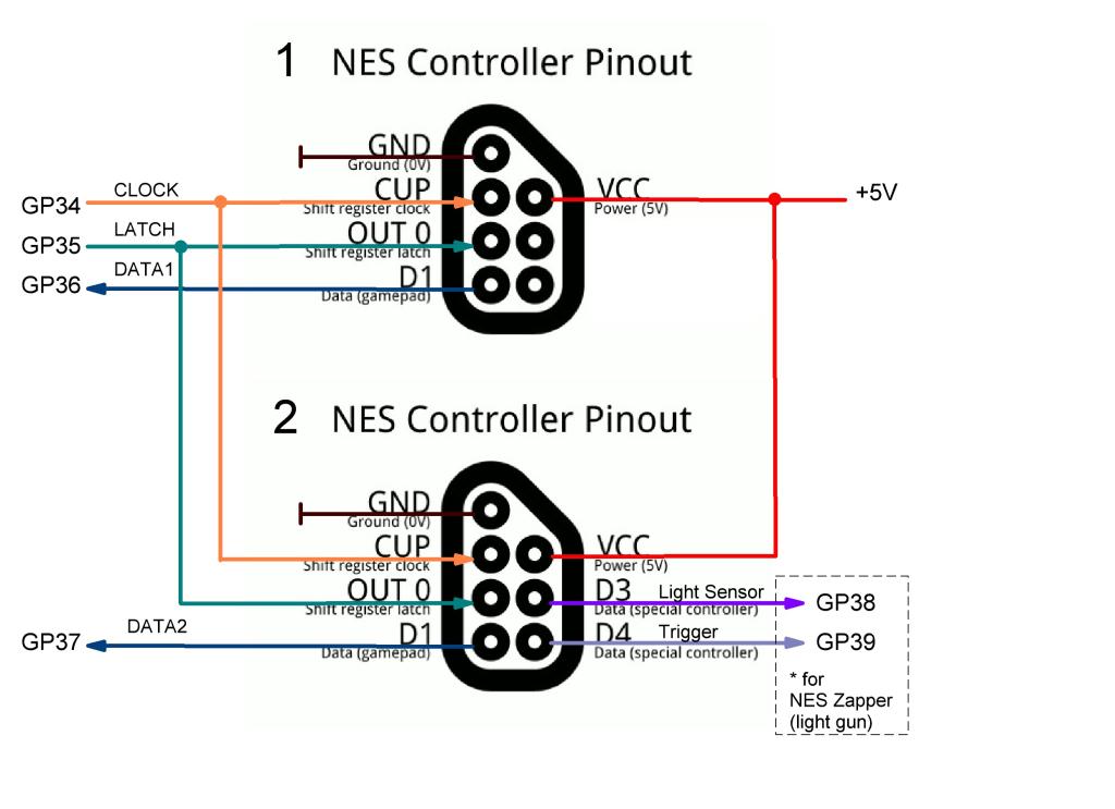

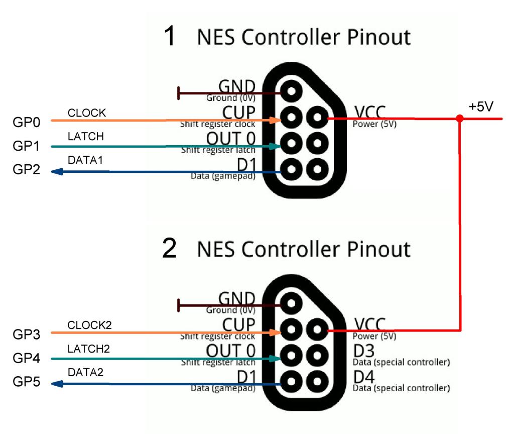

I've currently assigned the HEC controller connections to ports GP0...GP5
GP0 - CLK     GP3 - CLK
GP1 - DATA    GP4 - DATA
GP2 - LATCH   GP5 - LATCH
I would like to somehow decide on a standard connection for these game controllers to PC3
In general, I would like to know about your interest in porting this emulator?
I am sure the author of the project will not refuse to make a ready-made configuration for PC3 hardware.

There may in the future be a series of articles on the pc3 and the various codebases available for it in Silicon Chip Magazine (and eventually Practical Electronics) so it would be great to add this as another firmware. Personally I would prefer you used GP34-GP39 for the HEC controller but this isn't a big deal

Although you don't need to in this case, it's quite possible to share the clock and latch lines for NES/SNES controllers. Each controller needs its own data pin. The number of controllers is limited by how many data channels you read. :)

  Mixtel90 said  Although you don't need to in this case, it's quite possible to share the clock and latch lines for NES/SNES controllers. Each controller needs its own data pin.
Will connecting two NES controllers like this satisfy everyone?
Although in most cases, only one NES controller can be connected for single-player play.

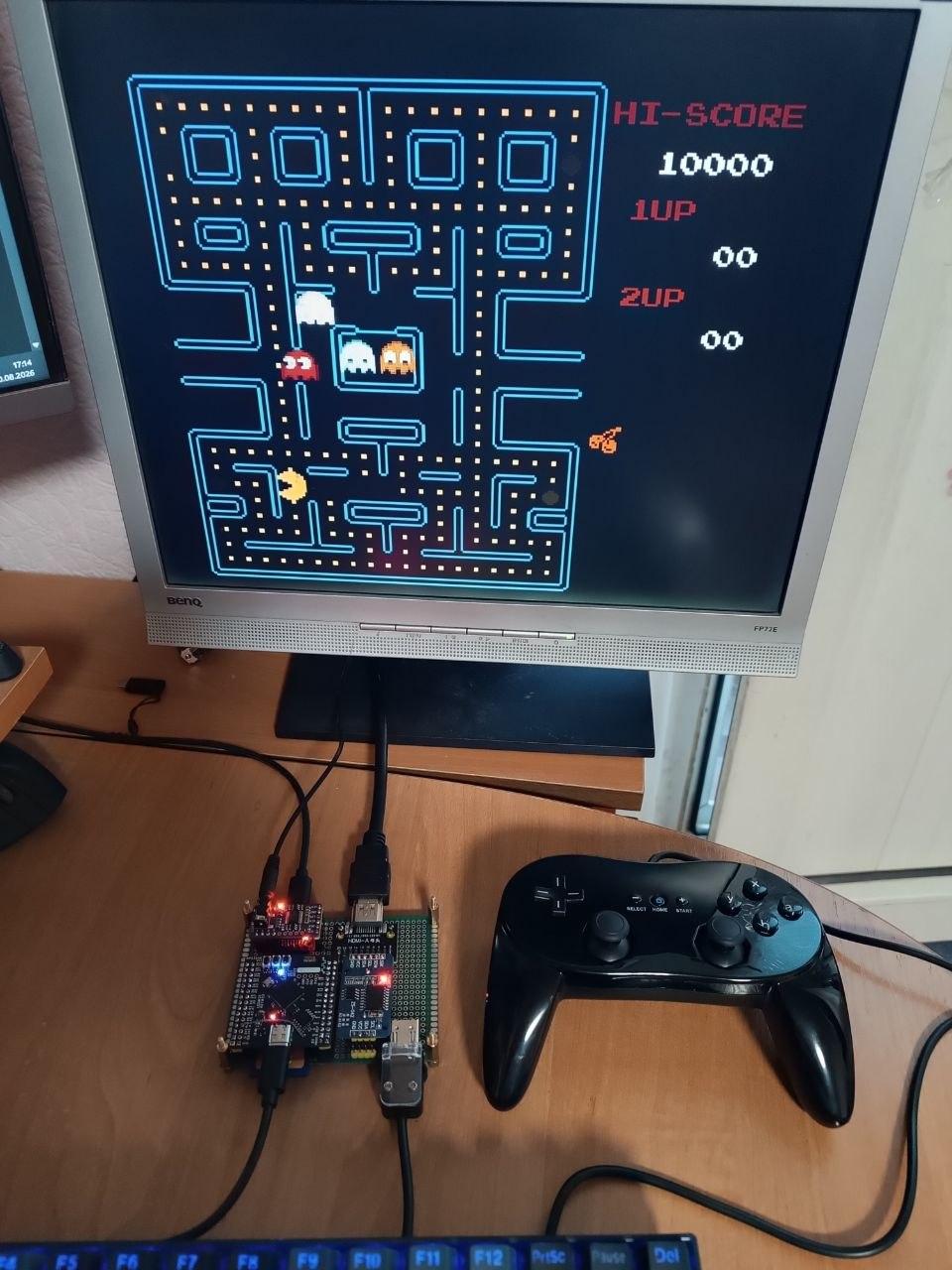

New test version 0.47 of the NES emulator for Pico Computer 3
PC3-piconesPlus_047.zip
Information about the project on GitHub
fhoedemakers/pico-infonesPlus
Debug information is on the UART console
Wii classic controller on SYSTEM I2C bus
USB keyboard & USB gamepads
Connecting NES controllers according to the diagram:

For example, it is necessary to define a standard for connecting two NES/SNES game controllers to the PC3; so far, the approach used is the one shown previously, involving the controller's GP0...GP5 ports.
